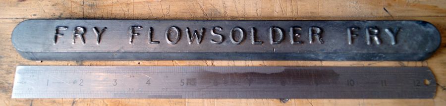

      Would anyone know what type of solder this is…plumbers solder..? I found it in the back of a shed but have no idea where it came from or how it got there.

          Hello Ron,
          It is almost certainly high lead content plumber's solder that would have been useful in stick form like your example for making wiped joints. The enhanced lead content makes for a wider melting range so that is can be manipulated as a semi molten solid and then heated again to make it flow nicely for the final sealing and light 'polishing' with a moleskin to complete the joint.
          For the application the broad melting range is crucial, a solder that freezes quickly [aka electrical joints] is of no use to forming joints of that kind. I doubt there are many plumbers left who could successfully make a joint of that sort these days, the need has melted away

                Fry used to sell a lot of this at one time for 'prepping' car bodies before painting…..probably an epoxy used now.
                'Fry metal' was very well known in several industries but I thought/think it is a bit big for plumbers, at least the sort who work on houses….

                    Also used for wiping cable glands to pilcswa electrical cables and in the metal pot for soldering weak back ferrules to joint the cables.
                    Fitting and cable were tinned and then built up with layers of plumbers metal using a torch, metal , pat with moleskin, you had to get it in the right order or you knew about it😩.
                    Compression fittings used later for jointing

                      Ron
                      Is there a number stamped on the back, like 63/37?
                      My guess is it was probably intended for flow soldering PCB's.
                        I'm inclined to agree. Sold in units of the pound weight, or fractions thereof. Other possibilities are for replenishing Tinning Baths or for Roofing where strong Flashing joints are required.
                        Ron's example bar here looks to me as well over 1 lb weight.

                          It's plumbers solder. Frys also made metal for linotype and monotype machines for the printing industry

                                David,
                                No number but a large capital "K" is stamped on the back.
                                Richard,
                                Yes it weighs more than a pound, not weighed it but it feels like a kilo at least.

                                  I googled it and quite a few references came up, plumbers, car bodies, soldering machines, electrical joints plus others. I also found a bit of history on Fry,s, they produced non ferrous alloys, solders, anti friction material and "white brass". A question: what is White Brass, I,ve never heard of it.

                                    Brass with a high zinc content.
                                    Further reading here:
                                    **LINK**

                                      As others have implied, this looks very much like the stuff that Post Office Telephones, and its successors, used for plumbing joints on paper cored lead sheathed telephone cables. When I was one of their apprentices in the '60s we had a demonstration of "pot and ladle plumbing." This consisted of a pot of molten lead with a gas burner and (unsurprisingly) a ladle which was used to transfer an amount of solder into a moleskin cloth liberally soaked with tallow and held in the palm of the jointer's hand. The molten solder was then shaped around the lead sheath and the joint cover to form a water tight seal. This seemed a very hairy process to watch and there was, thankfully, no mention us lads being allowed to try it. This method was only employed when dealing with very big cables, such as those found in the cable chambers of an exchange, the usual everyday practice in the field was to use" lamp and stick" plumbing, melting small amounts from a stick of solder, as shown in the photo above, catching it in a moleskin pad and as before forming it around the cable/joint combination. This skill, like plastering, welding etc is a hand skill and not for everyone, when BT first started shedding staff in the '90s they let too many jointers with those skills go and then had to open up courses to train a new generation of plumbers. Moleskin was a thick brown cloth which was folded in many layers, the tallow came in candle form and the solder came in stick of similar proportions to the photo above and was known as Solder 8B.

                                        Hi Ron, this is a soft solder, Frys were one of the leading manufacturers of these products back in the day. The letter 'K' means this is BS219 Grade K, aka 60/40 Sn/Pb.
                                        The shape is known as a 'plumbers bar'.

                                          If it's 60/40 Sn/Pb it is general purpose, free flowing solder. I have a similar stick, going back decades.
                                          Plumbers solder for wiped joints AFAIK, is (was!), 40/60 Sn/Pb This has a much wider "plastic" temperature range

                                            Density should sort it out. 60/40 lead/tin has a density of 9.7 whereas 40/60 lead/tin has a density of 8.9. Weigh the solder in air then weigh it suspended in water. Density is the dry weight divided by the wet weight, all in grams. MEW 251 explains all.
