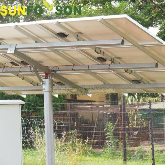

        Hello, I Have 5 solar panels for water heating which are doing a good job. As part of the experiment I intend making these into a pole mount so that I can rotate and track the sun. I have worked most details out like tracking electronics (arduino), pole and mounting frame.
        I wonder if any of our readers has seen a suitable installation and can describe the slew bearing or bearing assembly?
        Initial thoughts are to use a front wheel drive van rear hub which has taper rollers, probably, overkill but readily avalailable?
        Thanks Peter

                                I'd looked at bearing like used on a washing machine etc but all are too small/flimsy. On the other hand there are "proper" slew bearings as used on 360 degree excavators etc but very pricy /large to experiment with.

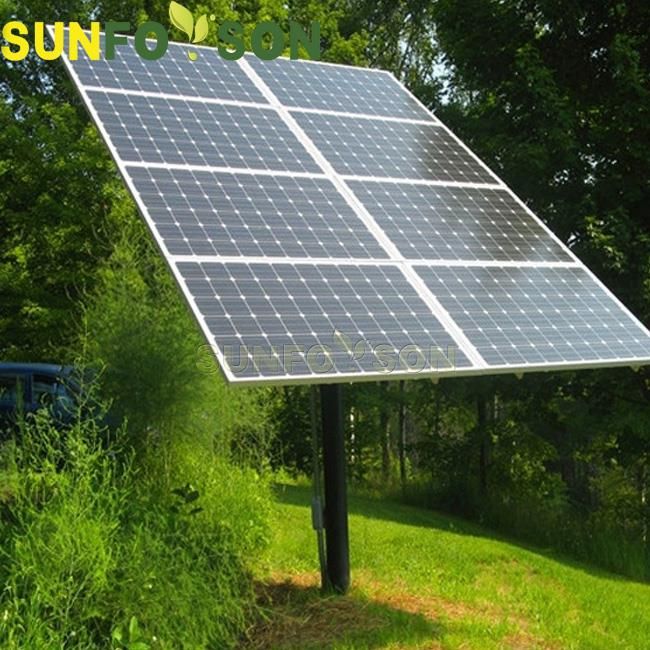

                                Its a single axis tracker I was interested, single pole mount is quite popular around the world and even in the UK.
                                This is a similar size to what I am doing. The support is very much like a roof with the panels attached to the correct alloy rails with clips
                                However it is fixed, I want mine to rotate as the next step, hence the question in case someone has already done it or has practical experience of it.
                                I may end up with a grid ties inverter etc but it's heating water, matched to an imersion heater. At present its running at 156v and 312w in todays cloudy conditions, full sun is 1100w.
                                The link below is the controller I am using. It matches the impediance when the sun is not shinning fully. Works very well and the link gives comprensive data as well as a working project.
                                Peter

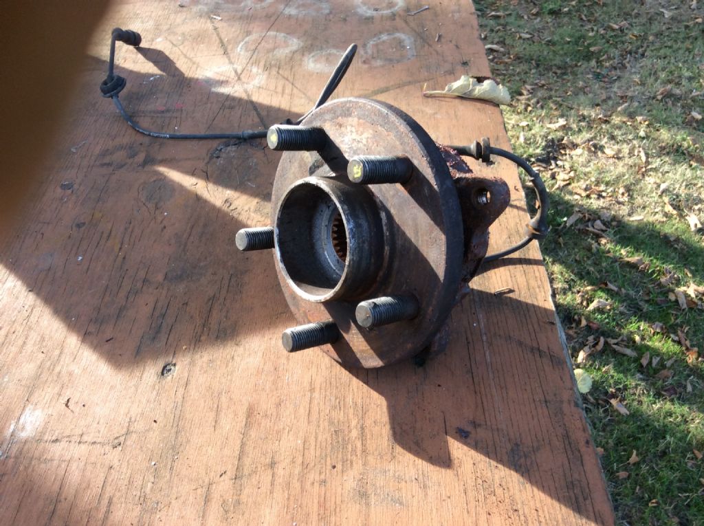

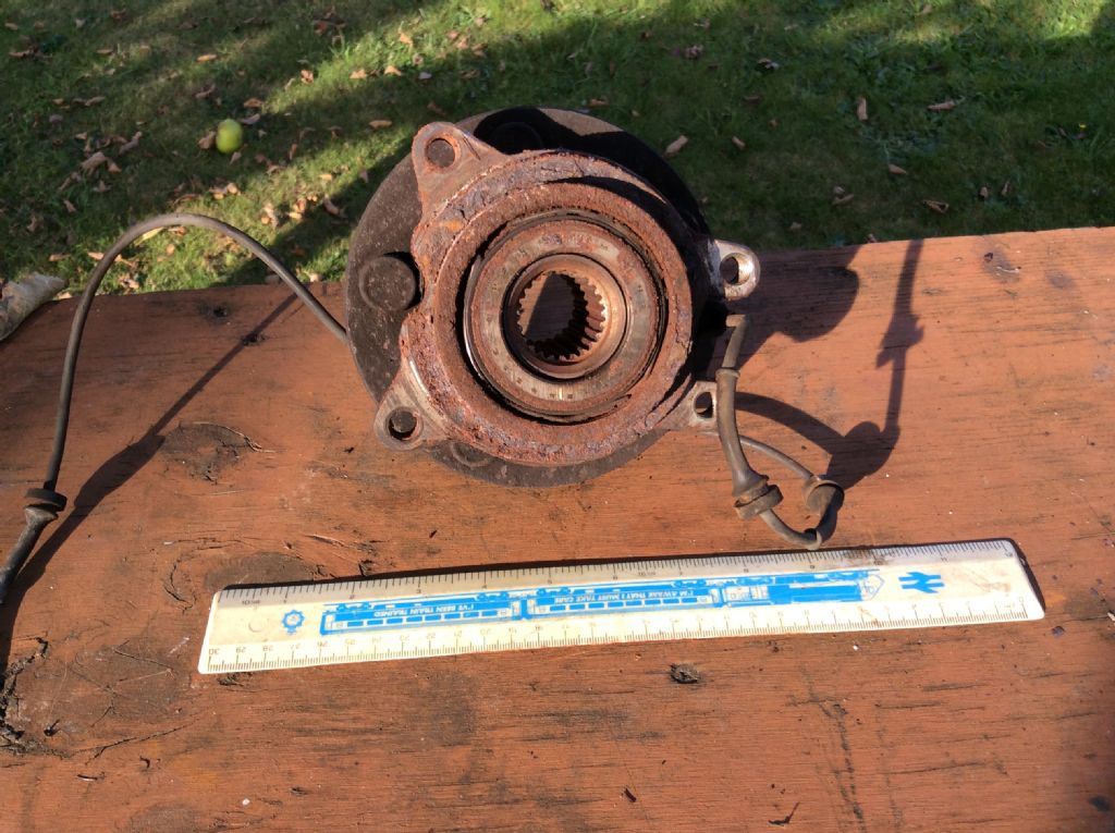

                                          74d7e11e-7002-42e1-be2e-688719f91e43.jpegf1a0fe04-6c7c-445b-9fe9-43b57e8e6e4b.jpegHi would this type of bearing be ok,only needs your tube cutting and flanges welding on ends.Flanges would bolt to either side of bearing.
                                          This is from front of a Discovery 2
                                          Maurice

                                              tAbout the size I was thinking of but that hub looks like it slides onto a splined drive shaft so the bearings are in a separate housing, if I'm looking at it correctly!
                                              Did a bit more searching and slew bearings everywhere like elevating platform etc, often combined with a motor to rotate them, probably similar on fairground rides but I'll bet some of the ancient stuff used a lorry front hub.

                                                Hi, this unit contains the bearing .If you mount the side with 4 bolts to the static side of your pole and the side with 5 wheel studs to the panel side, Your panel will turn on the bearing.
                                                This type of bearing is used on other 4×4 as well ,so should be very cheap at breakers yard.
