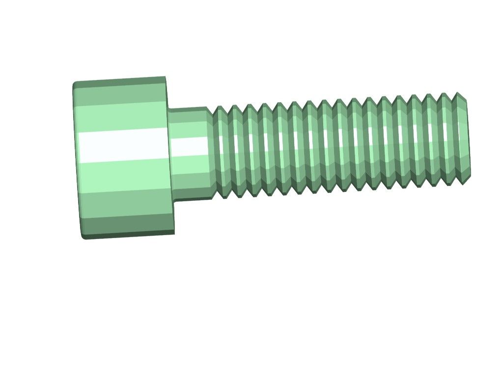

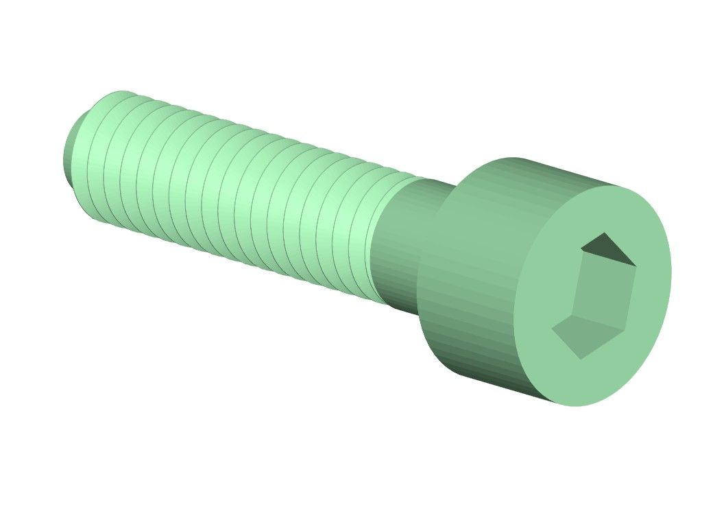

        Well I signed up to an online repository of CAD models a while ago to get some accurate models of fixings.
        After a lengthy process on one supplier's web site I got an M5 cap head screw… without any threads.
        I signed up for another and downloaded a file with the impressive name of socket_head_cap_screw_iso_ISO_4762_M5_x_16_16S surely that must be better?
        I finally got around to printing one but I had trouble starting a nut, I used a bit of force and the tip sheared off in the nut
        I then took a close look at the STL file… this is from what claims to be a leading repository of CAD models… come back Thingiverse, all is forgiven!

              That is typical of fasteners with 'cosmetic threads' – intended for use in CAD assemblies, not for 3D printing.
              The cosmetic thread is simply a pattern of ridges – because that is much easier to model/render, but (at first glance) gives the impression of threads.
              True helical threads put huge demands on processing capability and can really bog down the CAD system.

                Traceparts is probably the main European repository for CAD models for commercial parts. I don't see any models with modelled threads. As David says, you only model the threads when necessary. It's quick and easy in most CAD such as Fusion etc.

                                                  It's a simple error with the CAD model; the thread Vee section has been sketched such that it starts the helical cut a little way after the end of the part.
                                                  I've personally struggled to assemble a rogue screw exactly like the original illustration – i.e. with a series of grooves in it – before I realised and flung it into the deepest recesses of the workshop with a bellow of rage!.
                                                  Unless you really need to 3D print the threads in, I wouldn't bother. Why can't you use a real screw? We often produced 3D parts at work with tapping-sized holes in and tapped them out to fit later. We certainly never 3D printed fasteners unless they were an obtainable special.
                                                  As David Jupp says, the processing power needed to create true 3D threads is huge. You'd probably take as long doing it on the CAD as you would tapping out a plain hole!
