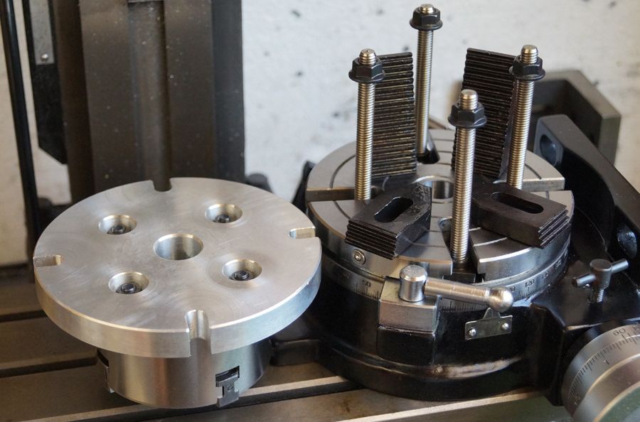

      I expect the slots don't go close enough to the middle to allow for what is likely to be a 70mm or less PCD if bolting direct. That's based on the slots in my 6" example.
      Also with the right spigot in the MT2 hole you can line up the small hole in the backing plate easily when fitting the chuck so it's concentric..

        Having checked the dimensions Jason is correct, the PCD of the chuck mounting holes is 68mm, the table slots are just long enough but it would need the corners on the inner face off the T nuts radiused to allow them to travel in further.
        Michael, you can see in the picture the mounting plate is dedicated to the 80mm chuck but it would be possible to add mounting positions for other chucks.
        I forgot to say that the kit also comes with a basic clamping set as can be seen in the picture.

            Ron, I rounded a couple of my nuts a long time ago and have just had a measure and can get about 67mm cts with the M8 studs. As your chuck is more likely to have M6 cap heads you could probably make some custom nuts and get it down to 65mm cts if you ever needed the gain in head room.
            One thing I did with mine was machine the end of a blank MT arbor to 6mm dia which is handy for locating the table and things on it and I also made a ring to slip over that that is a good close fit in the backplate hole which makes it easy to remount the chuck.

              Jason, thanks for the idea of the MT arbor I see ARC do a MT2 one with a 1" end which will be fine as I have checked the chuck backplate hole and its 16mm.
              I have also had a measure up of the table slots and if I make up some custom nuts I can get down to 60mm ctrs and with the chuck PCD at 68mm it will be fine.
