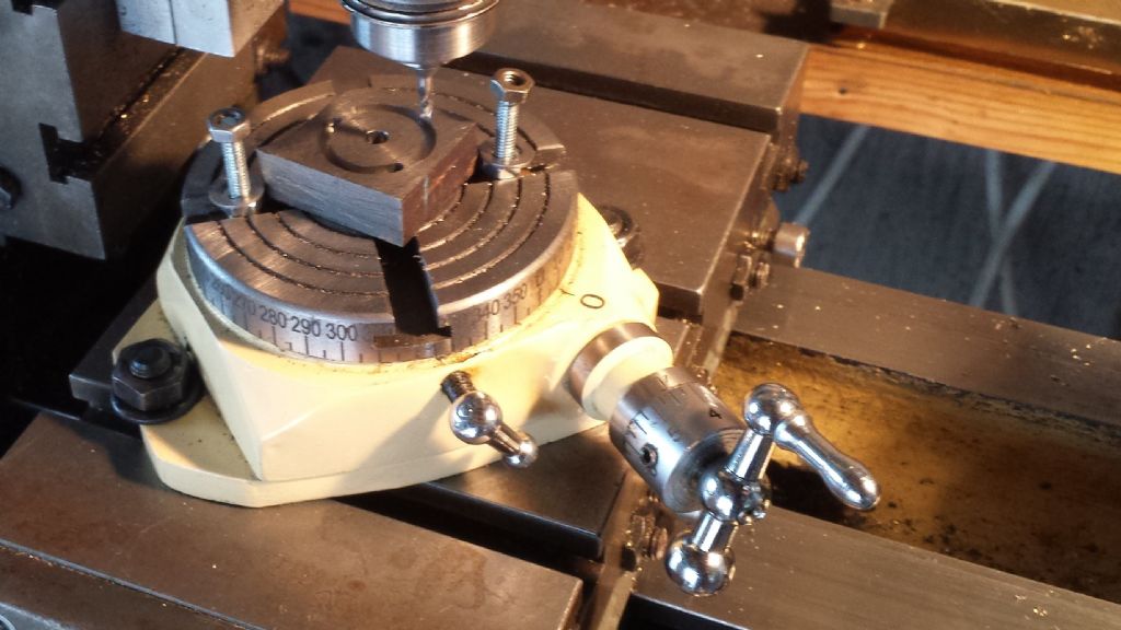

                                  I have read all of this thread with interest but particularly liked this post from Paul. Sums up My attitude!!
                                  I bought this small rotary table from GDR some months ago and despite it having numerous faults it's ok for me and the standards I need to set when making my models. I've had to modify and improvise to make it usable but as I have said before it was "cheap as chips".
                                  On accuracy this table is 7.5 degrees out over a full 360 degree rotation of the table. The hand wheel dial is indexed with 7.5 degrees and the hand wheel rotates exactly 47 times for one rotation of the table, should of course be 48.
                                  I get round this by using the scale on the circumference of the table. For say 92 degrees I advance 90 degrees and then add 2 degrees from the hand wheel dial. that's accurate enough for me and the work I do
                                                LOL. Cost saving measure. One tooth saved on each worm gear means that every 47th gear they get one for free. cheeky
                                                I bet you had some headaches until you worked that one out though. Who would think to check that?
