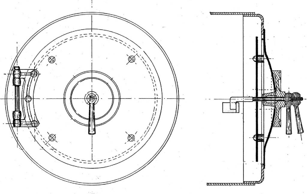

                                        #328043
                                        Paul Lousick
                                          @paullousick59116
                                          Why not a central locking arrangement as used on most boliers on portable steam engines and traction engines ?? . You can still have extra "dummy" clamps around the perifery if required.
                                          Ref temperatures in smokebox: Temp of steam at 50 psi = 175 deg C and at 100 psi = 200 deg C (approx) The hot gases passing thru the boiler tubes will be hotter than this.
                                          #328096
                                          duncan webster 1
                                            @duncanwebster1
                                            I know nit picking, but steam at 50 psig has a temperature of 147 C at 100 psig it is 170 C. as you say the gasses in the smokebox will be hotter.
                                            The centre clamp would look really out of place on a Crab, best solution is a centre bolt hidden under the number plate
