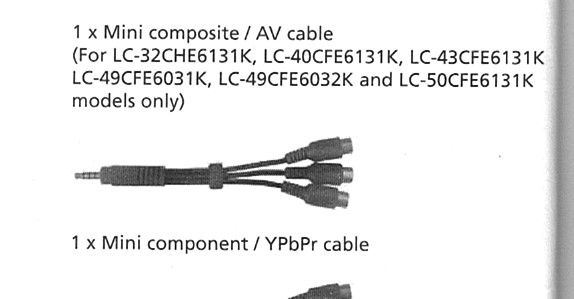

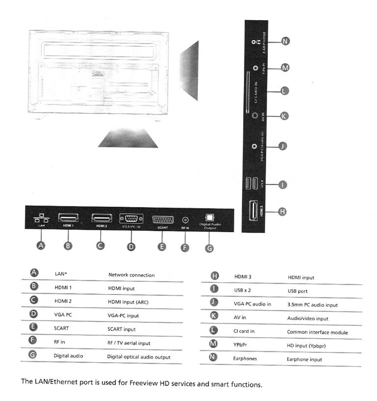

                    Hi Bob, some smart TV's, like mine have a 3.5mm jack socket AV input.
                    Mine was also supplied with a AV-3.5mm jack plug lead with the three phono sockets on, although you will need a AV extension lead, but I already have a couple of those that came with other players.
                    Regards Nick.

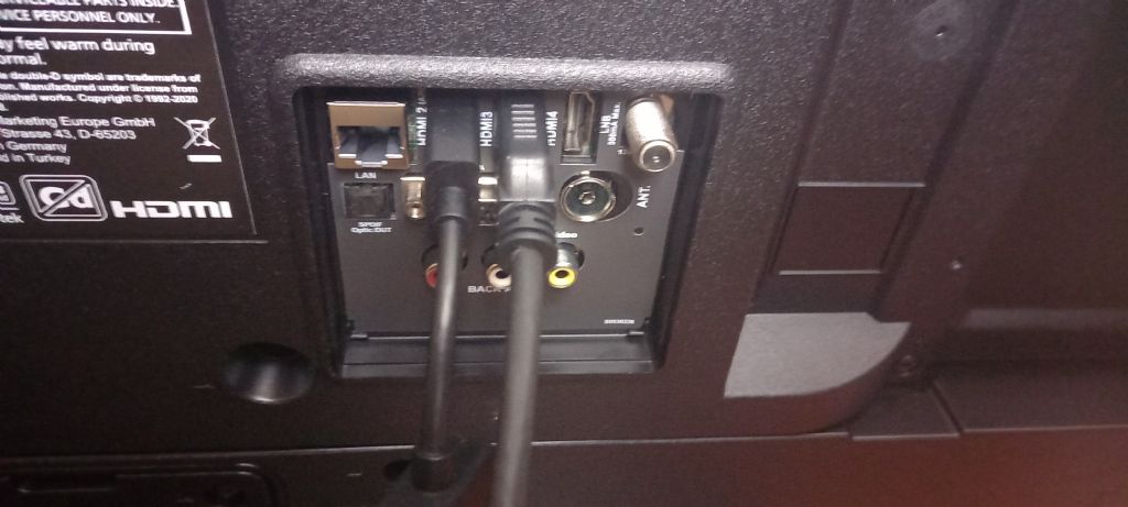

                            #582290
                            BOB BLACKSHAW 1
                              @bobblackshaw1
                              Just noticed the comment from Martin, this is the back of the TV.16431094401613276936662668467234.jpg

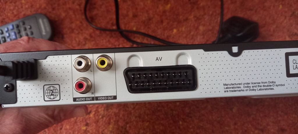

                                SCART to HDMI converters are available, but I suggest the money is better spent on an up to date DVD.
                                Like Journeyman John, I too have a gormless Panasonic Smart TV. (Excellent picture, but primitive internet capabilities.) So I'm about to invest in a plug-in Streaming Device, a way of getting SMART TV without buying a SMART TV. They're a small computer controlled by a TV-Remote that connects via your Wifi to radio and TV services on the internet. I want one because lots of the best telly isn't on Freeview.
                                Several makers with various pros and cons: Amazon Firestick, Nvidea, Apple, Android, Now, Roku and others. Prices between £15 (too cheap!), and £300 (with sound system and other gizmos) Of these, looks like a Roku Streaming Stick+ best suits my needs, about £45.
                                Postscript:  Bob posted a photo while I was typing.  Bob's DVD and TV both have RED, WHITE and YELLOW Phono connectors, so one of these cables should work.  Lots of people sell them, and one might have come with the DVD.

                                  Why not just use a standard composite + stereo AV cable (like these from Kenable) between the L, R & Video jacks on both devices?
                                  Brian G
                                  Edit:  Unless there is a lot of electrical interference or you are using a high-end home cinema system I would just go for the cheapest cable with the three red white and yellow phono plugs and not waste money on oxygen free copper, gold plating and other gimmicks/features that separate audiophiles from their money.  (Believe it or not Currys even sell Toslink (fibre-optic) cables with gold plated connectors – and people buy them!)

                                            Hi, that's assuming that Bob's Red, White and Yellow phono connectors are Audio and AV – IN
                                            Regards Nick.

                                                  Correct, and assumptions are always dangerous!
                                                  However, I'm reasonably confident the group of Video, L and R phono sockets on the back of Bob's TV are inputs because it's more usual for TVs to accept video IN than to output it. For the same reason I'm almost certain the DVD phonos are all outputs because there's no sense in sending video to a player.
                                                  As a phono to phono audio-video cable can be had for under £5 I think Bob's fairly safe. I'd still replace the DVD though – HDMI gives a better picture and sound.
