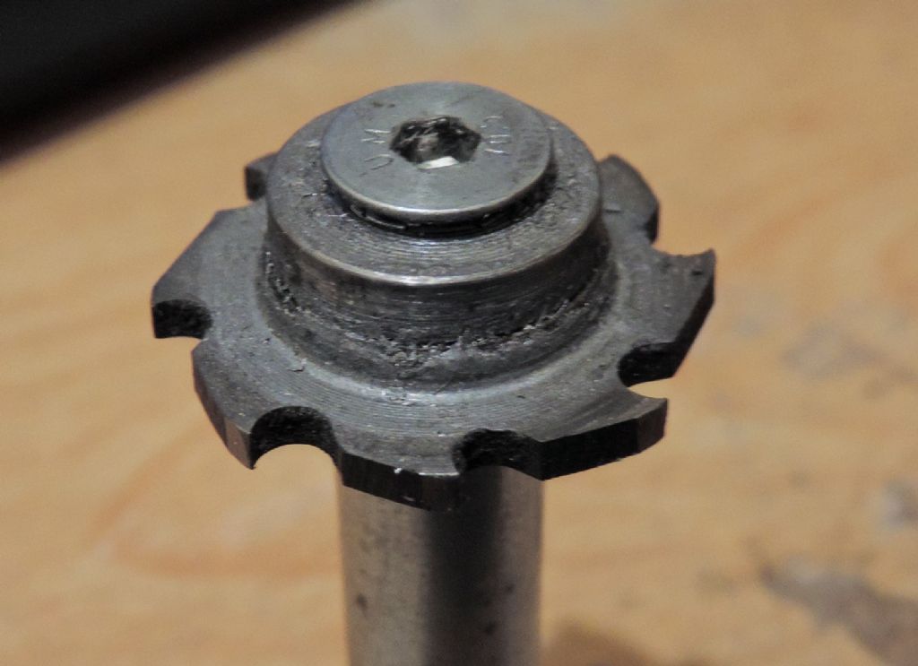

                              #375975
                                Ronan, what are you using the saws for?
                                Would it be possible to make a simple cutter from a slice of silver steel or piece of gauge plate with say 8 teeth that could easily be mounted on an arbor or what about grinding down a cheap 1 1/4" dia woodruff cutter to the required width?

                                  #375980
                                    There's this one I made from 1 1/4" silver steel. Ended up about 29.9mm diameter, 2.65mm thick.
                                    I wanted to cut holding down slots in the sides of a cast iron toolmaker's vice. Did a great job and since I've used it for a few other things. Looks crap, but works fine, just needs to eb run gently as it's carbon steel.
                                    You could copy it as Jason suggests, or if you are really stuck and it's near enough on diameter I could post it.
