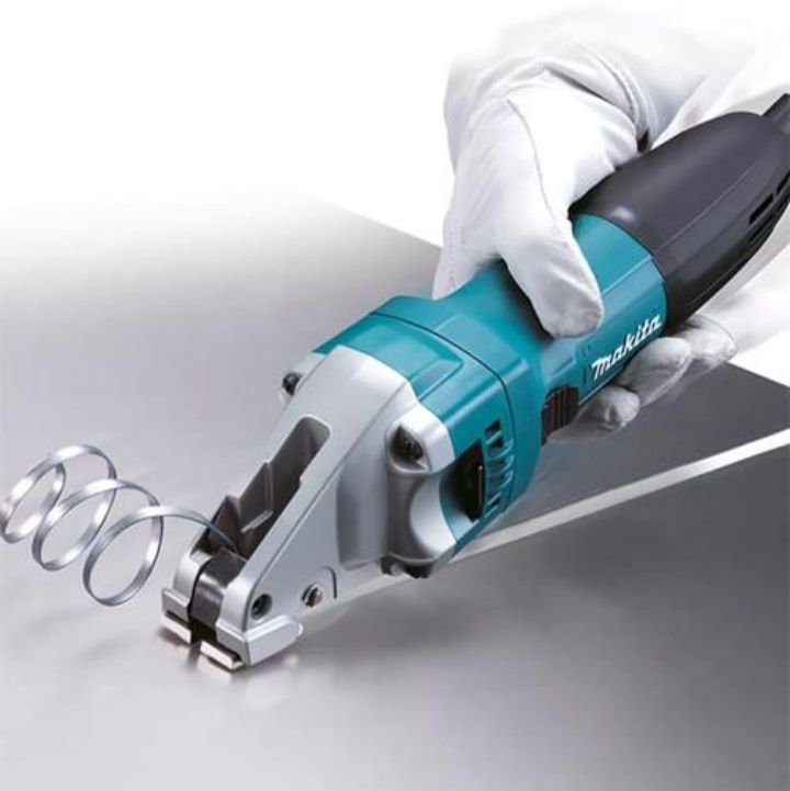

The shear I showed cuts without distortion either side of the cut, this is for roughing out a few millimetres oversize, the shear can be used for trimming the edges, you could finish it as you already have been doing, some emery cloth on a flat surface to de burr the edges.
I've never used it with under 0.9mm sheet steel, never had any need, I thought your request was primarily for 1mm steel and stainless.

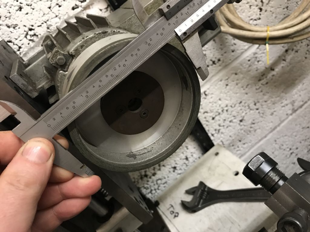

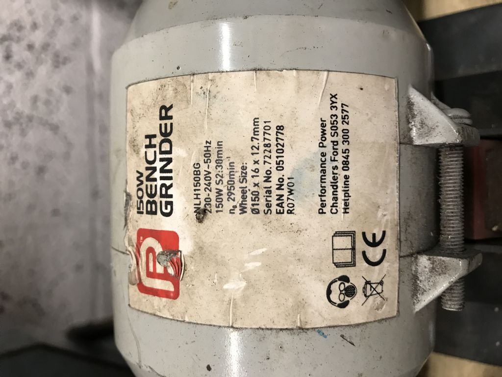

To slow for grinding appears to be a case of “internet knowledge”
My surface grinder is supposed to run 71/2” wheels iirc, so I didn’t look at that.
However:
Bog standard bench grinder from B&Q. Takes 150mm wheels, runs at just under 3000 rpm.

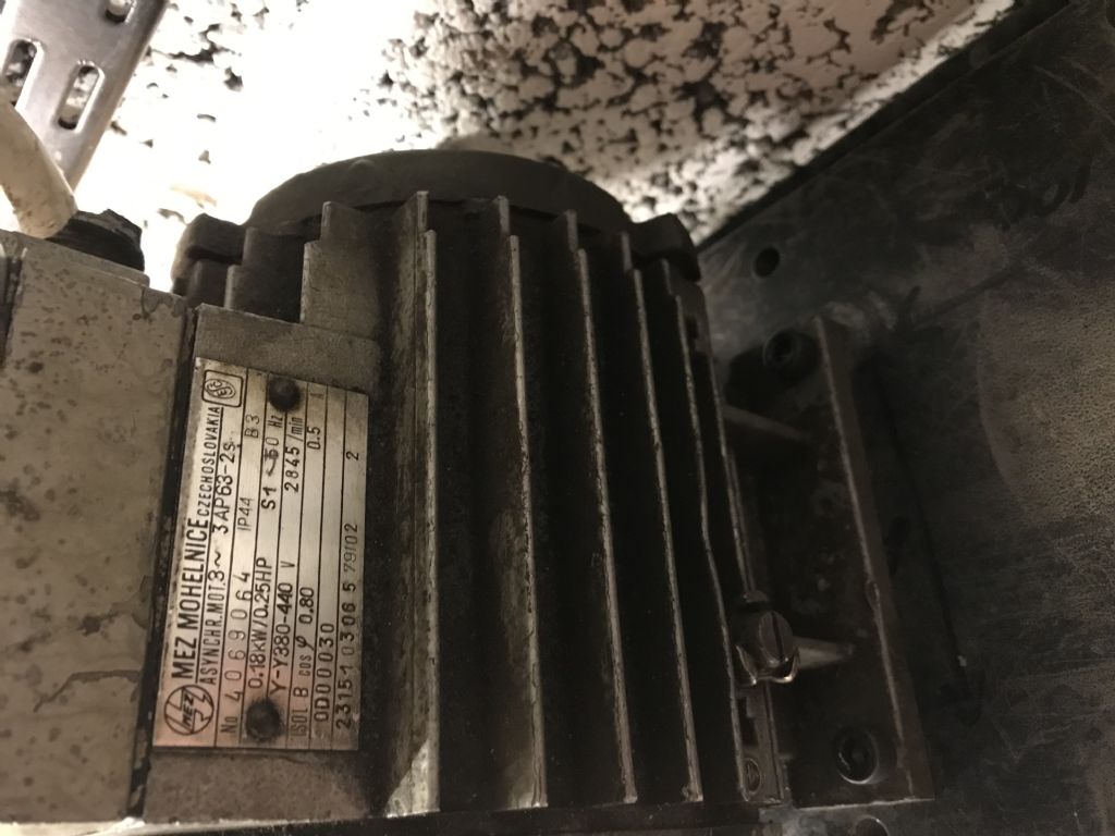

Homebrew cutter grinder:
Has a 4” cup in it currently, also runs a 4” saucer.
Speed:
Also just under 3000 rpm.
I have never needed to run a slitting disk on either, but I don’t doubt that with a thin wheel at that speed both would still work. Of course it would need to be the right wheel. Abrasive wheels are cutting tools, and much like different types of carbide or HSS there are different types of wheel. A wheel designed to run at 10000 rpm is built differently to one with a slower maximum speed.

Sorry I forget to add, 18v shear for roughing out, bench shear for trimming edges to finished size, incase it might have caused some confusion.

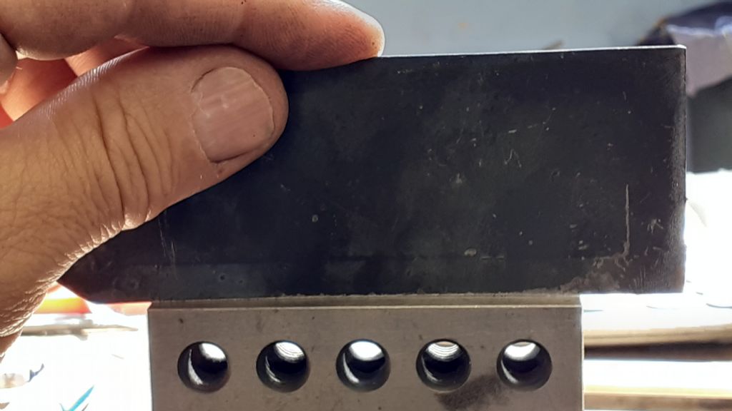

John, regarding drilling, in the other thread I said they do a sensative drill attachment which is ideal for small holes and allow the drill to be raised and lowered quickly to clear swarf etc. You can buy similar over here that will fit for a lot less.

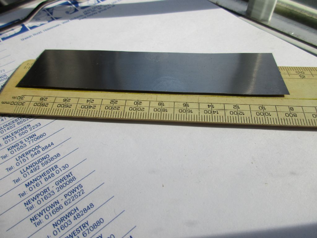

As I have said from the start a mill with slitting saw will do the job I just stuck a bit of manky 0.8mm, 110mm long mild still in my mill and mounted a fine tooth HSS saw blade. First cut is leveling off the top second is cutting a 1.5mm wide strip. Any bend you see is due to the parent metal being from the scrap bin and not flat to start with. If cleaned up it would Look flat which is what I expect you mean as you don't want deformed edges like a shear can gibe or curled parts like tin snips.
Could not get the phone to focus well but once the small burr was knocked off it would clean up well with a quick rub. A more concentric blade would probably help too!

@Pete – Your shears looked like a mechanised version of a nibbler that's all. I they can cut steel sheet reliabily with no visibly obvious sign of any bending near the cut them I might buy some myself! Yes most of my requirement is for 1mm steel, but I will need to various sizes cut down to 0.1mm steel from time to time as well.
Also – to get clear a "Bench Shear" is basically a guillotine with a long arm for leverage, yes? [I am a newbie, please remember]
If so, presumably you will get at least a bit of rounding /deformed edges. In 1mm steel the question arises how far this extends.

@Nicholas Farr – I wonder what would a 10×5 mm square look like in close-up?
Yes, 0.1mm mild steel is exceedingly thin and is very easily bent between fingers. For my purposes right now I have been needing to cut 10mm x 5mm little rectangles of it. And the resulting steels need to lie "absolutely" flat (i.e. flat to within 1 thou – call it 0.02mm).
I can see that a really good pair of scissors or guillotine/"bench shears" could do the job, however by the very nature of the process one side or the other always gets BENT out away from the rest of the sheet. Once bent it is almost impossible to bend it flat again. To be fair, I've not yet tried an enormously large pair of very shallow sheers with blades that are very nearly parallel to each other – maybe the steel sheet might only be bent within elastic limits [??], but I don't have space for a really large device in my domestic setup.
Further more when you zoom right in, there will be at least a little rounding.

The only thing that I have found that doesn't bend thin steel at all is a high speed abrasive cutting disk. Obviously it leaves a bur but ones that is removed by light sanding the sheet as a whole remains dead-flat.
@Stuart Munro – have you ever tried putting an abrasive cutting disk into your Proxxon FET?
From memory your circular saw has a diameter of 80mm and a RPM of 7000, so that would create a cutting speed of I make it about 1,700 m/min which should work pretty well, particularly if you have a very think cutting disk.
i.e. That's really I've got to: Cutting mild steel by high speed cutting disk. HOWEVER the problem seems to be that nobody seems to have manufactured a small circular saw that is designed to cut (what would in effect be any metal) using an abrasive cutting disk.
There are lots of hand held cutting disks (AKA Angle Grinders), but so far I have yet to find any embedded into a table so as to create a "circular saw table".
e.g. This Proxxon "MICRO cutter MIC"
**LINK**
[Spec: 230V. 40W. 20,000rpm. Maximum cutting depth 4mm. Cutting width 0.5mm. Weight approx. 300g]
It's rather under-powered at just 40w, and I'm sure faster would be better, but from experience 20,000 rpm can cut 0.1mm mild steel quite nicely without bending it near the cut.
