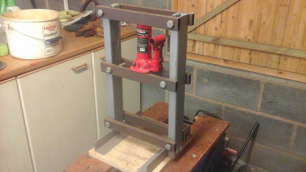

                    Here is another lockdown project made from scrap. The return force is by loops cut from car inner tube.

                              My first one was made from box section, (which had once been the legs of a semi trailer  ) , powered by a 6 ton hydraulic jack.
                              I now use an ex materials laboratory specimen press, which has a 5 ton jack. The side standards are 1" round bar.
                              Only defect is since replacing the seals, the ram and moving platen have to be forced down by hand rather than gravity, but it leaks less oil, now!

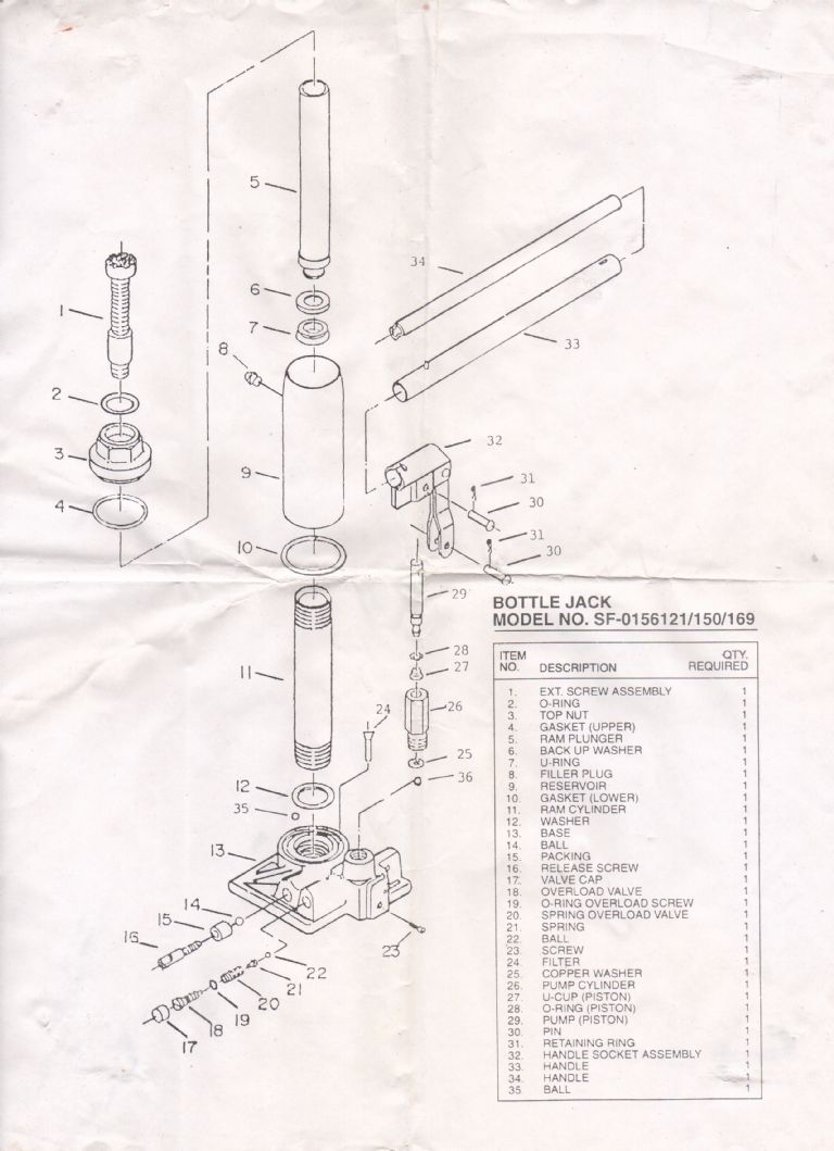

                                  Exploded view might be useful for reference
                                  [ in case it explodes ] angel
