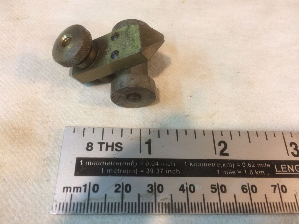

                      Is it a tool like this ?

                      #548057
                      Mike Waldron
                        @mikewaldron61652
                        Thanks all for the suggestions.
                        The little gadget shown is intriguing, Speedy builder! The first time I’ve seen that one.
                        Did you build it? If so, did you make it to drawings?
                        Mike

                        #548068
                        Phil P
                          @philp
                          Posted by Speedy Builder5 on 02/06/2021 06:44:30:
                          That little tool looks like it is for sharpening a watchmakers graver.
                          The drill version allows the tool to be tipped sideways to add clearance, so its wheels are fore and aft as opposed to being side to side like the one in the photo. A graver just needs a simple flat producing on the end.

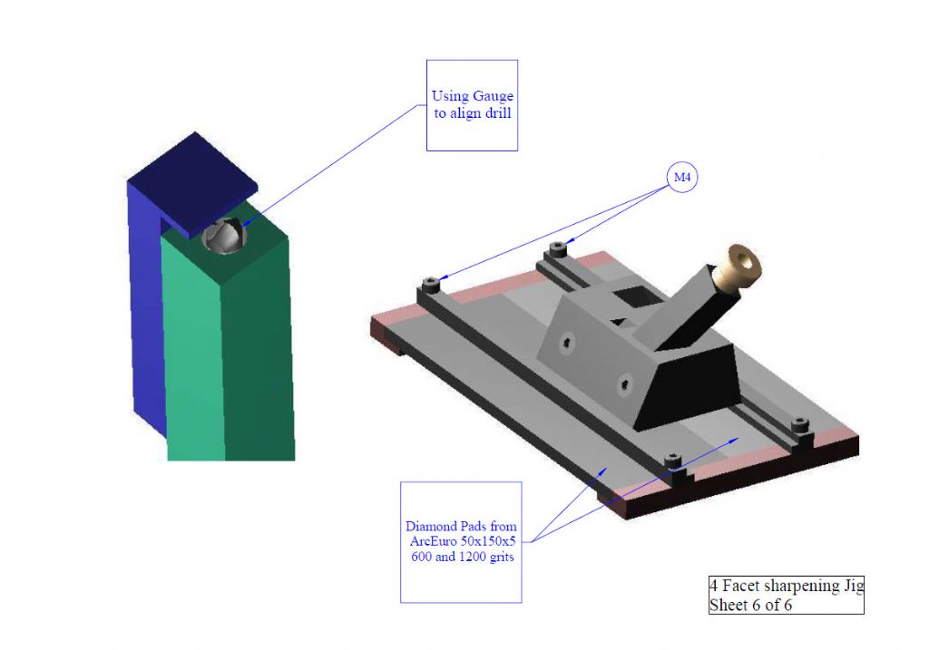

                          #548104
                          Gary Wooding
                            @garywooding25363
                            A few years ago I decided to combine D.A.G.Brown's designs of the 2 jigs he created for sharpening very small drills. There were two jigs, 1 for drills up to #42 (3/32&quot and one for drills up to 1/4". This is the result of my combination. Is this what you were looking for?

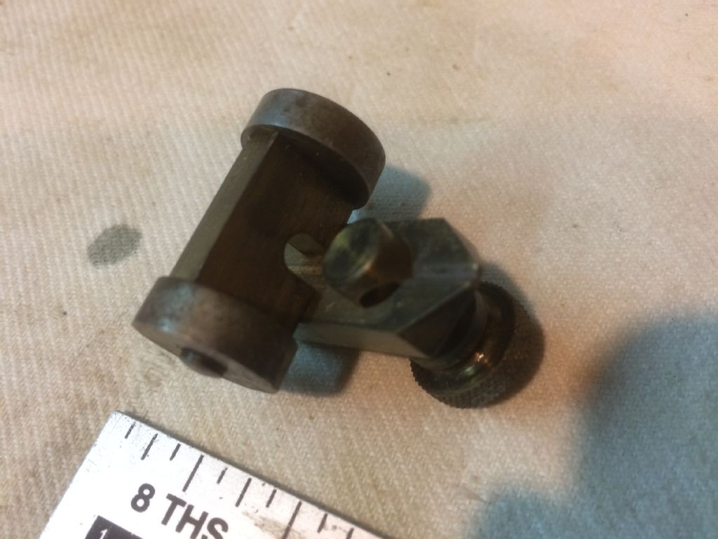

                                #548112
                                Speedy Builder5
                                  @speedybuilder5
                                  Another shot of the tool. The knurled knob tightened a rod which passed through the main body. That rod had a 1.5mm diameter hole through it perpendicular to its axis. The bottom of the body has a small "V" groove in it along its underside such that a small rod (Drill ??) could be held to project forward of the body at the "pointy" end. A bit small for holding a graver though. Unfortunately, I have sold it !

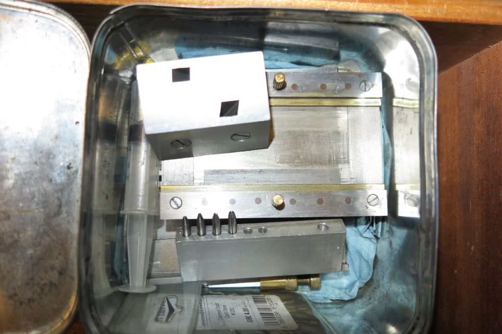

                                    bernard towers
                                      @bernardtowers37738
                                      Is this the one?. Works well once you are used to it, I fitted side cheeks to mine which are not on the very first drawings and a stop collar to set the depth.f07b9664-1333-4781-8b8c-11069dd79d7c.jpeg
