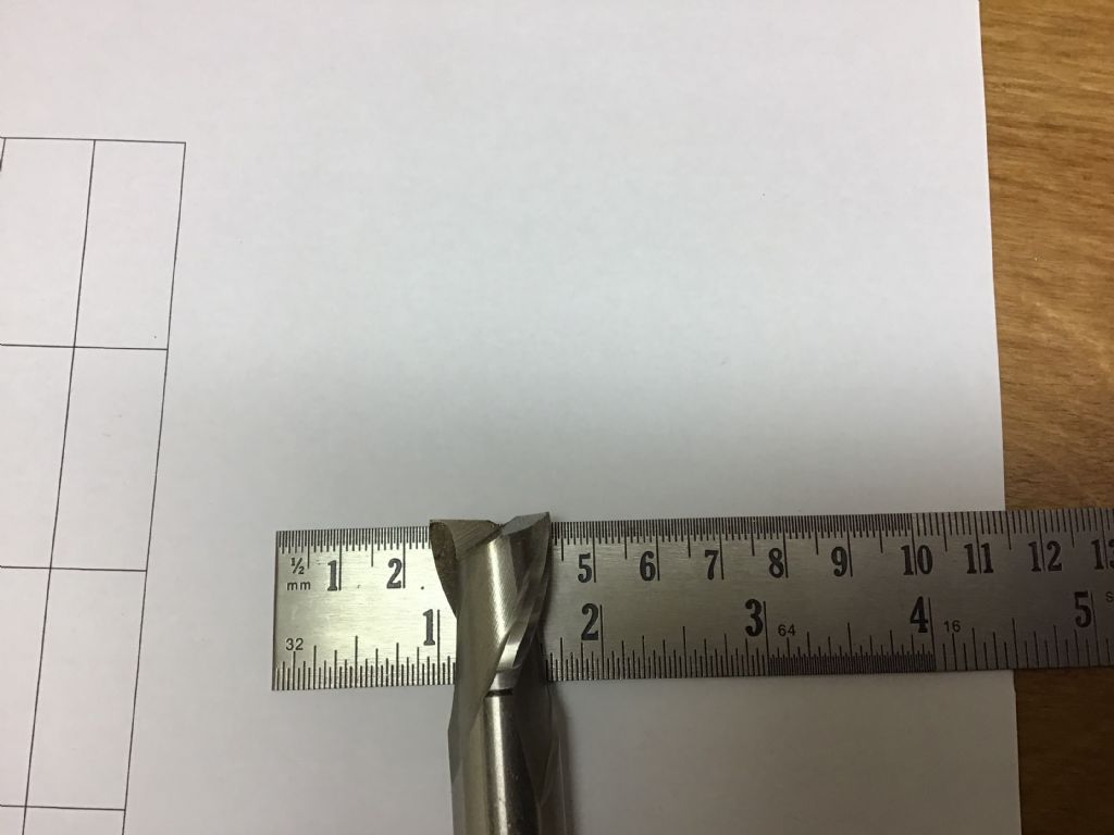

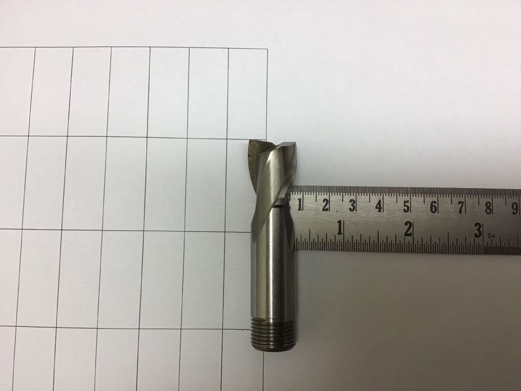

            bd33376b-603d-48f0-8129-63b4ac9e475e.jpeg4ab3a371-0953-4309-950e-e078ece28977.jpegPhotos of slot drill purchased from tracey tools. I can’t see that it would be centre cutting with angles as shown.

              Slot drills are ground with one edge longer than the other past centre so that it cuts to the centre,They are also ground convex so only the outside edge cuts leaving a flat bottom to the machined slot.

                        Posted by Andy_C on 07/04/2019 19:50:34:
                        You can see the left edge is extended to cut to the centre in contrast to the right hand one.
                        Flat bottomed holes need a 'special' cutter.
                        In the old days not all slot drills were centre cutting.
