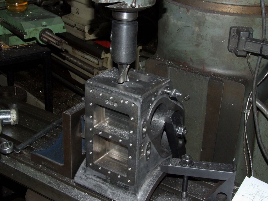

                  Posted by Peter Cook 6 on 26/11/2020 00:00:30:
                  Was I over optimistic in assuming that a 6mm slot drill will produce a 6mm hole? Or am I doing something wrong?
                  No, it should be perfectly possible. However, slot drills are ground slightly concave on the end, so if you want a truly flat bottom to the hole you'll need to make your own D-bit. Here's a secondhand 1" slot drill making a hole 1.5" deep:
                  The hole was predrilled 9/16" as that size goes deeper than the 1" diameter anyway. The hole measures 1.001". So it is possible. To the notes from Ady1 I'd add cheap cutters. If a 5.9mm drill produces a 6mm hole then something is wrong. Out of interest I just measured a hole I drilled 6.4mm a while back. It measures 6.42mm. I was using a quality 4-facet drill from Dormer. My guess would be that the problem is caused by poor quality cutting tools and/or tooling.
                  Andrew

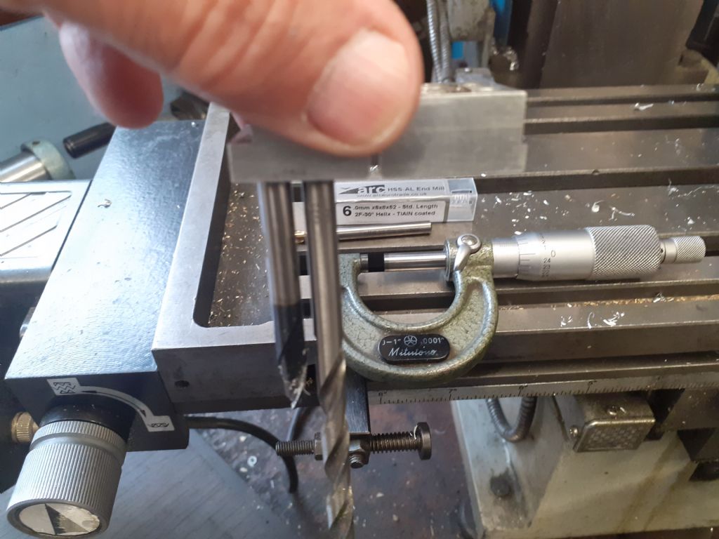

                        Although I said I prefer a 3-flute cutter I did a test with a 2-flute "slot drill" which is what you used in some 6082
                        Hole on the left was first drilled with a 5.0mm Dormer A022 stub drill with no punching or spotting and then followed up with a standard length 2-flute HSS cutter from ARC's premium range and that is a good fit on the shank of the cutter that I measure at 5.98mm.
                        Hole on the right just done with the 2-flute cutter, that is a 6.1mm drill in the hole who's shank actually measures 6.07mm
                        So without a pilot the hole came out approx 0.1mm oversize or 0.004" in old money. In both cases I had the quill locked and lowered the head to feed the cutter.
