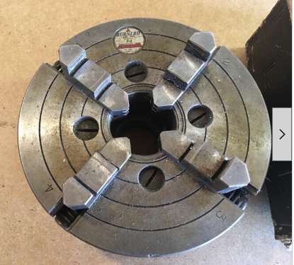

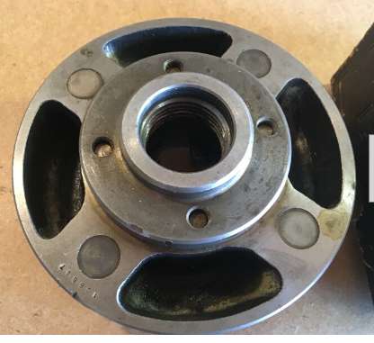

              I didn’t immediately go into too much detail, as we’ve not heard back from David yet, but bear in mind those chucks are hollow with not much metal in front of the voids; photo from the same listing.
              image_2024-01-28_124218677
              David was seeking a 100mm one;
              My 4″ has an approximate PCD of the mounting holes of 55mm, and my 6″ one about 70mm, so if we wish to re-drill on the same PCD to miss the voids, then the T slots need to extend quite close to the centre of the unknown rotary table.

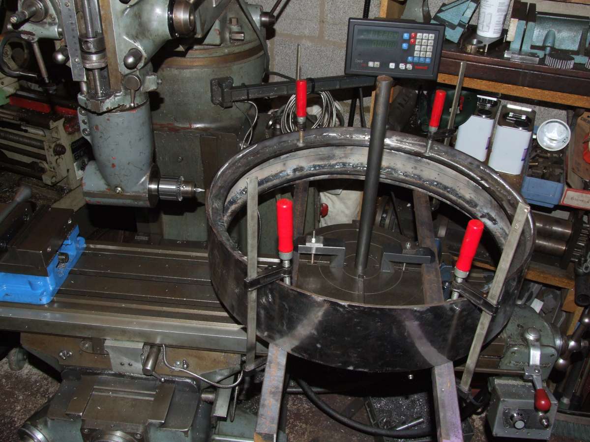

                      A sensible decision; when I first acquired my rotary table I also bought a small 3-jaw chuck. But I never fitted it, and in 15+ years have never missed it. For most of what I use the rotary table for a chuck wouldn’t be much help anyway:
