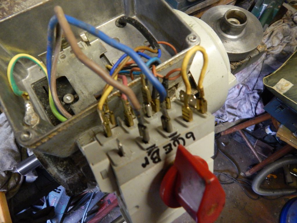

      After my debarkle with the 3 phase kit i purchased and being left with a debt of £230.00 and no hope of anything back that works . I have aquired a 1.0h single phase motor. This is briliant and seems to run the lathe much better. The problem I have is that the motor needs reversing to allow it to bolt in . Is there any experts out there who know what the wiring does on this switch and how to reverse the motot please .
      Single phase wiring box
      #8183
      Martin Newbold
        @martinnewbold
        Reversing Single phase switch attatched to motor

              Hi Martin,
              You will need to supply more information. Is the switch a three position switch (Forward off reverse) or is it just a two position switch (On / off) ? Can you provide pictures directly looking down into the connection box, One from the opposite side to the switch (To see where the black twin cable that goes through the hole in the top right hand corner goes to. I suspect that it MAY go to the start capacitor) ?. and a picture from the switch side so we can see if the mains cable enters that side of the connection box. I suspect that it MAY enter that side and that it is the cable with the yellow green core connected to the motor case and the brown and blue cores are connected to the second and third connections on the switch counting from the left. Also do you have a multimeter and know how to use it ?

                Currently this is wired as follows:
                N -> a
                R -> Mains.L
                S ->Mains N
                T (empty)
                W -> yellow motor , starter capacitor.
                V -> red motor, starter capacitor
                b -> (brown into motor unknown)
                U-> motor black , (brown to motor unknwn).
                I cant see a way of rotating this but there must be a way of changing direction of motor rotation.
                Edited By Martin Newbold on 27/06/2016 17:03:12

                    Judging by the number of connections to that "box", the red knob should reverse the motor. Is it stuck or not working in one direction? The normal wiring is that L&N go to the run windings. One end of the start windings goes to the start capacitor. Depending which way the L&N are applied to the free connections of the start components , the motor will change directions.
                    Can you find which windings are which with a continuity meter?
                    Frank

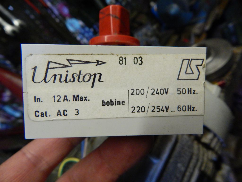

                      Hi Martin,
                      You have not said weather the switch is 2 position or 3 position. You picture is not good enough to read the letters on the switch. There should be 4 wires goung into the motor windings. You have not said if you have a multimeter.
                      Les.

                      Martin Newbold
                        @martinnewbold
                        Yes it worked swapped red and yellow now reversed tah very much

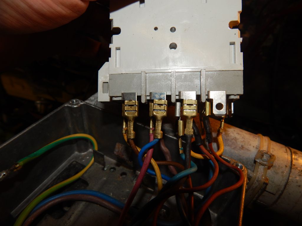

                          Help again after swapping W and V and the motor reversed but was at lower speed and did get very HOT HOT HOT. Is ths because i need to move the capacitor witth the yellow wiire. The switch is only two position i think and latches i havent tried it other way round. Will let you know
                          Here is the motor plate
                          Kitty LS60PF wiring plate

                            OK switch is single side motion on off . I was wrong with connections there is a blue wire , Black wire, red and yelow wire to motor and two browns i think are temp sensor.
                            N -> a
                            R -> Mains.L
                            S ->Mains N
                            T (empty)
                            W -> yellow motor windings, starter capacitor. brown
                            V -> red motor windings, starter capacitor blue
                            b -> (brown into motor temp)
                            U-> motor blue windings , (brown to motor temp)., motor black windings   goes onto lower rail onto U.
                            Can anyone please help in reversing this please?
                            Martin
                            Edited By Martin Newbold on 28/06/2016 14:45:24

                                  #244488
                                  John Rudd
                                    @johnrudd16576
                                    Martin,
                                    Can I suggest you do the following?
                                    Determine the Main windings wires, these should be connected to the main supply coming in, permanently connected….you can do this by measuring the resistance of the winding, it will be low.
                                    Determine the Start winding, one end will go to the Start cap, the other connected to one side of the Mains wiring. The resistance will be higher than that of the Main winding.
                                    Having determined which winding is which, get the motor to run in a direction whereby it isnt getting hot.
                                    Once it runs in this direction, note which ends of the start winding go where….now swap the connections.
                                    The motor should now run in the opposite way round.
                                    The switch only provides an On-Off function, a double pole isolation switch if you like…. Mains Neutral on one side accompanied by the Live adjacent to it.
                                    On the other side, you should have 1 wire from the Main winding, with one wire from the
                                    start winding both connected to either Live ( or Neutral) .Then the other end of the Main winding and one of the wires
                                    from the capacitor connected to Neutral ( or Live) . The remaining wire from the Start winding should be connected to the remaining wire from the capacitor..
                                    Apologies if this going over old ground, but basics is sometimes better going  back to…
                                    Having re-read Martin C's post, I tend to agree that if there is a centrifugal switch inside, it is not going to like running backwards and perhaps this is why it is getting hot….
                                    Edited By John Rudd on 28/06/2016 15:08:44

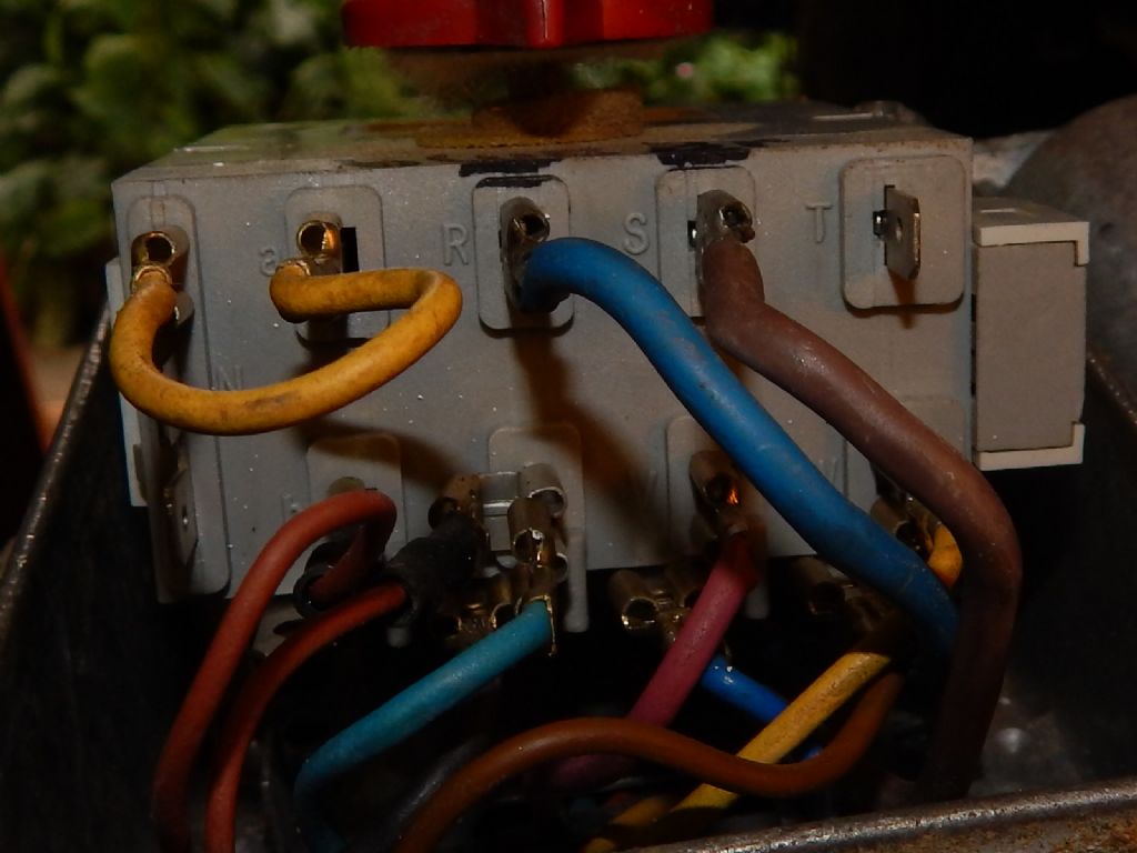

                                    #244490
                                    Martin Newbold
                                      @martinnewbold
                                      John thanks for your reply it is not wired like this it has nothing connected to L and N unless its internal . The current wirring runs it at full speed no temperature but wrong direction
                                      There is a blue wire , Black wire, red and yelow wire to motor and two browns i think are temp sensor.
                                      N -> a
                                      R -> Mains.L
                                      S ->Mains N
                                      T (empty)
                                      #244492

                                        Am not sure if there is a centrafugal switch as its all in the main switch and not motor. It stays clicked over when its running then clicks off if there is a temparature high . Sadly missed single phase motors at school so am on catch up
                                        Edited By Martin Newbold on 28/06/2016 15:40:34

                                            I dont think it has a centafugal switch just an NVR

                                              Martin Newbold
                                                @martinnewbold
                                                Posted by Les Jones 1 on 27/06/2016 16:15:05:
                                                Hi Martin,
                                                Les.
                                                Hi Les , thanks for your help here is the pictue you wanted :

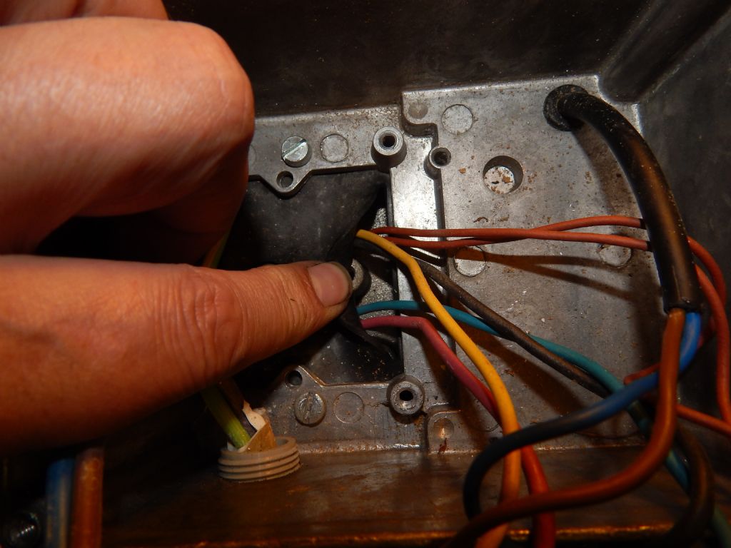

                                                  Martin Newbold
                                                    @martinnewbold
                                                    Hi everyone does this help I removed the clip to see where wires went Blue and Red go one side Yellow and Black the other
                                                    Edited By Martin Newbold on 28/06/2016 16:49:09
