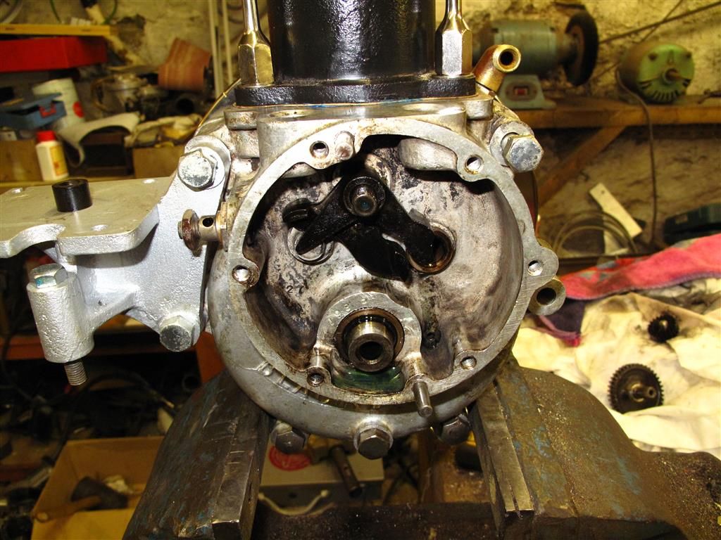

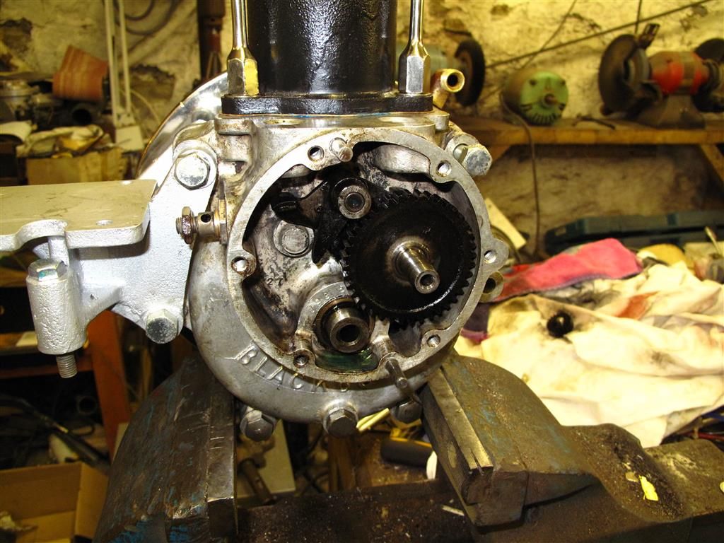

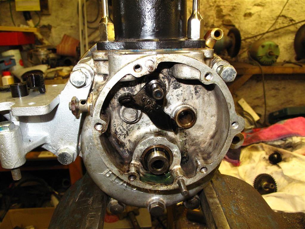

                                  Some pictures here of a ner a car engine ( blackburne) showing the arrangement
                                  #630834

                                    The motorcycle style shown in the post is what I was thinking of
                                    I'm thinking of building a jap or blackburne v twin and I'm just trying to understand the single cam setup
                                    Any ideas on how to work out the angles
                                    Dougie
