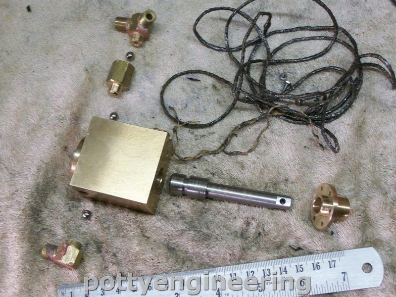

      Hi All.
      I bought a 5" simplex a while ago and the Axle pump never really worked. Made driving it really hard work.
      I stripped it down to find out what was wrong.
      It has 3 broken Bolts and a broken tap in the end cap / Glands.
      It appears to have been made to the Martin Evans design then sleeved down to 3/8" making it Single acting with just a bit of 3/8 rod as the Piston. The sleeve appears to have been Hammered in looking at the 'Miss' marks…..
      The Gland had no packing. Not hard to fix but judging by the state of the one on it, it's time for a remake.
      I have the Simplex Book which came with the Loco, The Drawings and the ME Articles. None ae the same design.
      My Inclination is to use the design from the book. This is the semi double acting design with 1 water inlet.
      Which is the most appropriate for this loco ?
      Thanks
      Alex.

                        Alex Collins
                          @alexcollins55045
                          Hi All.
                          Clive. The top Drawing is the one I plan to build unless I'm swayed otherwise.
                          The Super Simplex pump looks interesting, That makes the 4th design. To fit this as drawn would be very tight and require pipework mods. The Outlet is much taller than the book design to accommodate the 2nd ball valve.
                          Julian. I plan to use 3/8 SS Rod for the ram. I don't however have 5/8 SS for the piston. I plan to make the piston from either Nylon of PB.
                          There is no issue with fitting or removing the Pump. 4 1/4" bolts, 2 pipes and 1 pin. Out it comes with a slight wiggle. Not sure why you'd have to dismantle anything else ?
                          Stew. That looks like the Super Simplex pump. Works on the same principle as the Book Pump. Just arranged possibly better. It'd be a tight squeeze to fit that in.
                          Duncan. The issue is not feeding the O rings in. They have to traverse the in/outlet holes as you assemble the pump. That's what eats chunks out of the rings. I guess I could open out the portion that the piston does not traverse.
                          I'm currently thinking towards Teflon Rings and a 3 or 5 part piston.
                          I can feed in the Piston and then compress the Teflon to form the seal ?
                          Thank you all for your comments.

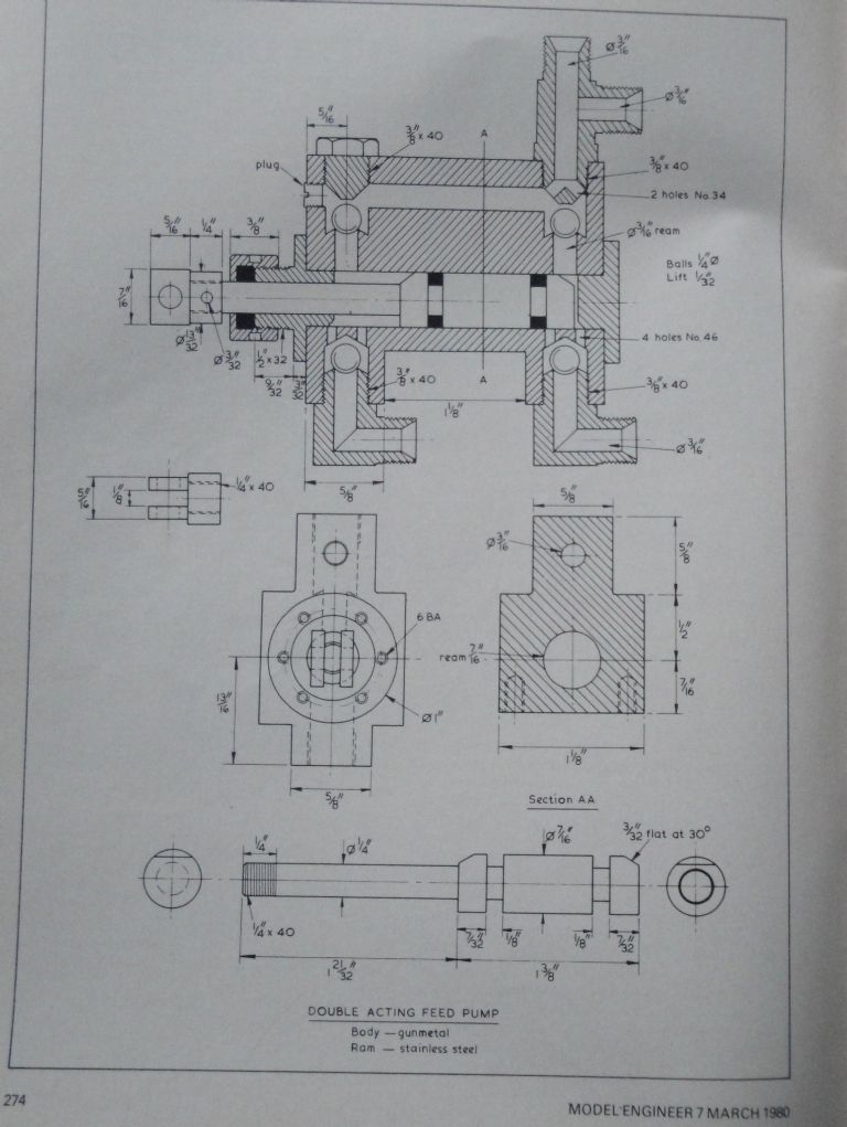

                            Sheet 6a of the original drawings shows a double acting design by Martin Evans with a smaller bore than the original which should give smoother operation while still delivering more than enough water. I have fitted that to my as yet unfinished Simplex. It does however require different plumbing having two inlets.
                            There's a photo of the bits on Dr John's site here
                            Russell.

                              julian atkins
                                @julianatkins58923
                                here is the amended/redesigned Simplex axle pump from ME 7th March 1980.
                                in the write up Martin Evans acknowledged that the original Simplex design was "not, in fact, double acting".
                                this was the pump we fitted to a Super Simplex. the actual Super Simplex design as shown above is a design by D. Anderson from ME 4th July 1980 which Martin adopted for Super Simplex's axle pump, but the Super Simplex hand pump uses his re-design of 7th March 1980.
                                i think it is pretty evident that with only one water inlet the same water that had already been pumped by one stroke re-circulates into the other end of the pump before being eventually pumped out. hence why the original design doesnt do what it is supposed to do. anyway that is how i have always understood it, though i am happy to be proved wrong!
                                cheers, julian

                                    After much deliberation, all 3 pumps have their advantages. The debate in the thread says that all the designs work and are suitable for this loco. ​
                                    I'm going to build the Pump from the Book. Why ?
                                    It's a well tried and tested interesting design with a small revision over the 1968 ME Drawings.
                                    The Super Simplex and Double acting (1980) Pumps will both require Pipework mods. Not a huge deal but extra work. I can see no real advantage with either of these pumps. If anything they have added complexity.
                                    The piston I'm going to make in 3 parts. 2 Discs with a Teflon piston ring that I can squeeze.
                                    I have M14X1 taps n dies for the Gland nut.
                                    Thank you all again for your Input.
                                    Alex.

                                                  #212055
                                                  Alex Collins
                                                    @alexcollins55045
                                                    What I have found running with just the injector was it's far to much and uses a lot of steam. The water level rises and I start to lose pressure. Shut the injector down at ~ 40 psi then the water drops – need more and the injector refuses to pick up. That's what I mean by "it was hard work driving"
                                                    Please don't get me wrong, the injectors are good and work well. I'd prefer to have a pump that pretty much looks after the boiler and use the injector only when needed.
                                                    I have a 16 oz (no. 2 ?) on there at the moment.
                                                    Good progress tonight. The brass is cut to size and roughed out. Decided to leave the bore Blind rather than make an end cap so drilled and reamed it 1/4" short. Still plenty of room for the ports.
                                                    All the drilling is done, Gland is made and holes tapped.
                                                    #212059
