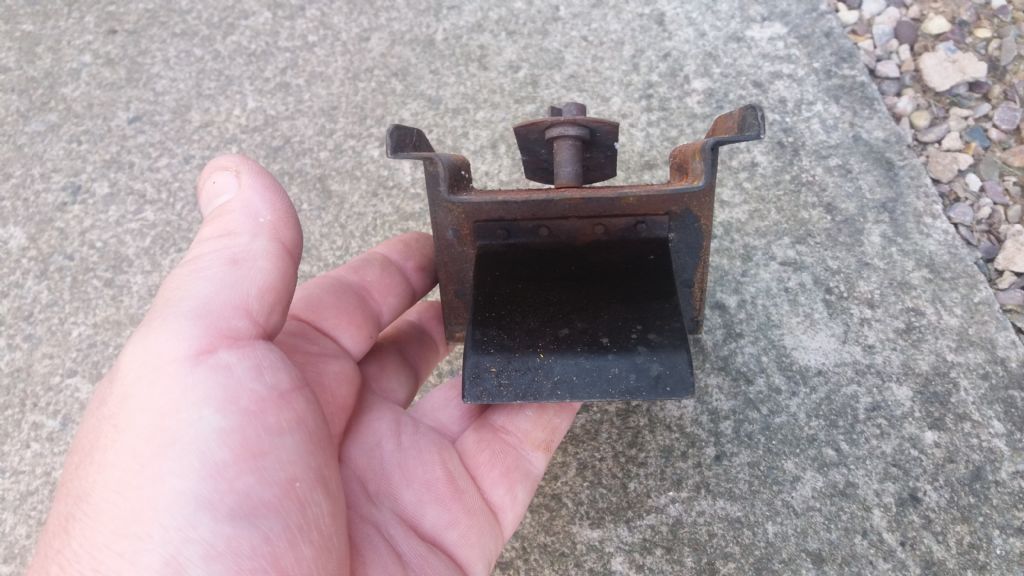

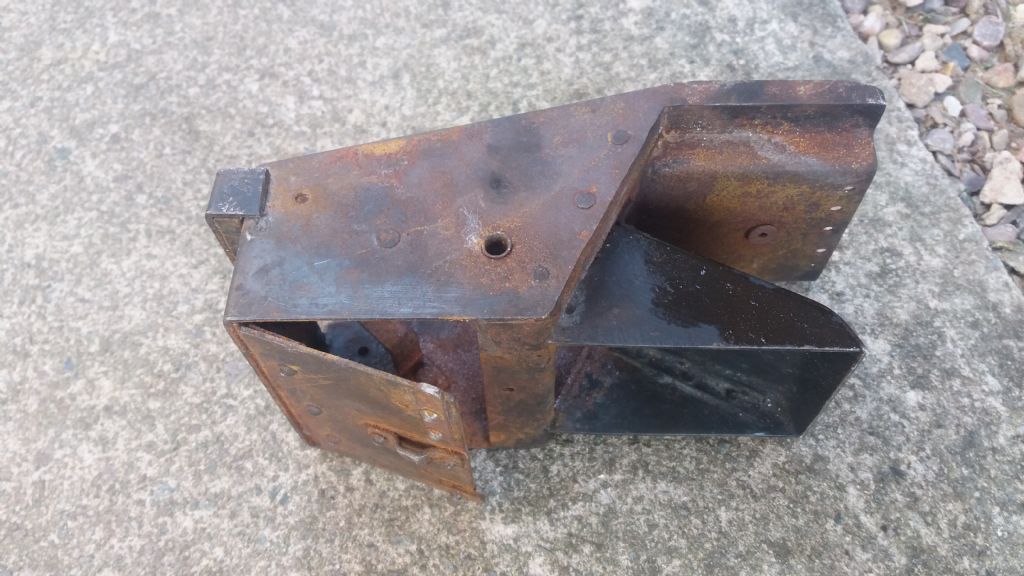

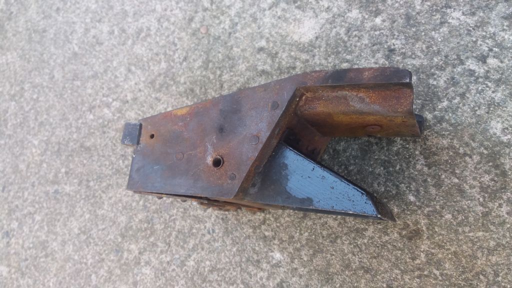

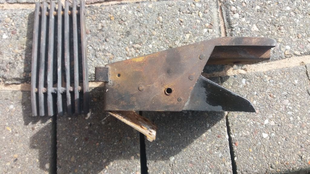

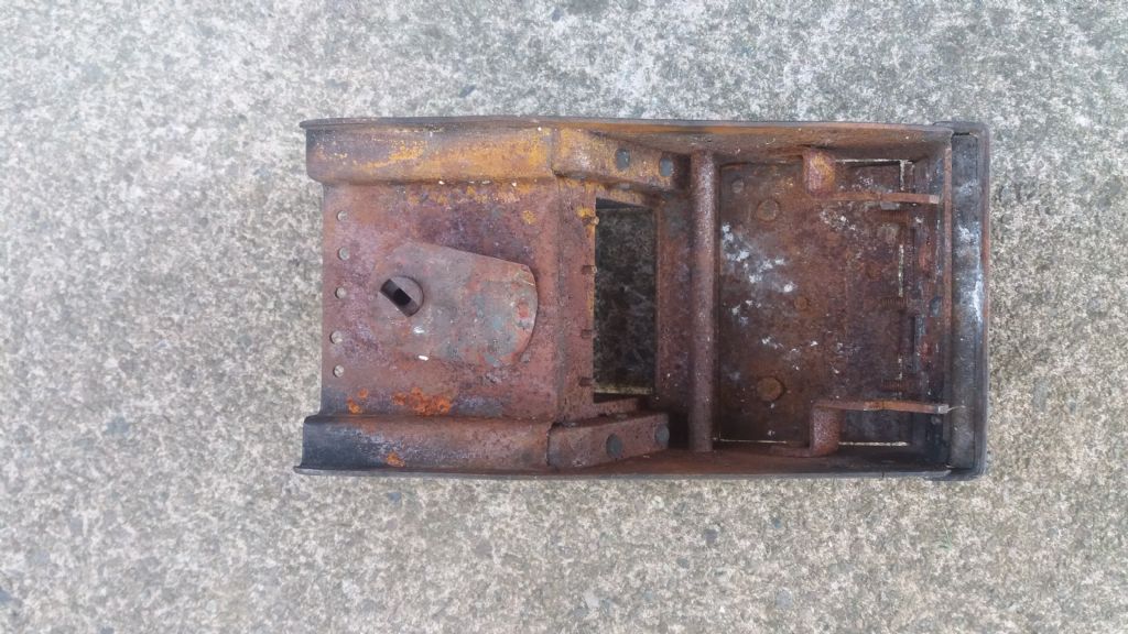

                                  nigel Hyde 1
                                    @nigelhyde1
                                    Hi David
                                    well here they are, I always find a nice deep fire, this design gives plenty of air and more importantly save the back axle from getting covered in ash and getting ash in the axle boxes and save a re build!
                                    the back axle runs in the space of the scoop area, I hope that makes sense
                                    Hope this helps
                                    #257898
                                    David Wasson
                                      @davidwasson11489
                                      Hi Nigel,
                                      Thank you for taking the time to shoot these photos. Looks like this version has the hatch to dump the ashes without removing the entire pan or grate. It also looks like it is held in by a pin that goes through the tube mounted left to right.
                                      It's hard to tell, but, it looks like the "scoop" that goes under the axle is open where it is attached to the pan to allow for more air flow. Is this correct?
                                      David
                                      #257984
                                      nigel Hyde 1
                                        @nigelhyde1
                                        Hi David
                                        I have spoken to my dad and this is what he has said
                                        " The ashpan is inserted up at an angle and slid between the top of the horns and bottom of firebox. A cross pin fixes it in place. Air feed is from two directions, the first horizontally, from the rear, and, as you noticed, vertically up into the scoop and into the bottom of the ashpan, through the firebars. The ashpan flap is to dump the ash when necessary and, could be left open to admit even more air if required.
                                        The grate is held onto the ashpan by two fingers at the front and a slotted rod at the rear. In early trials I found the firebars were burning through at one point too quickly. To overcome this I placed a "button" underneath the firebars at that point to divert air around it. It worked.You can see the "button" sitting on the slotted rear grate fixing rod.Hope this is all clear "
                                        Thanks Nigel
