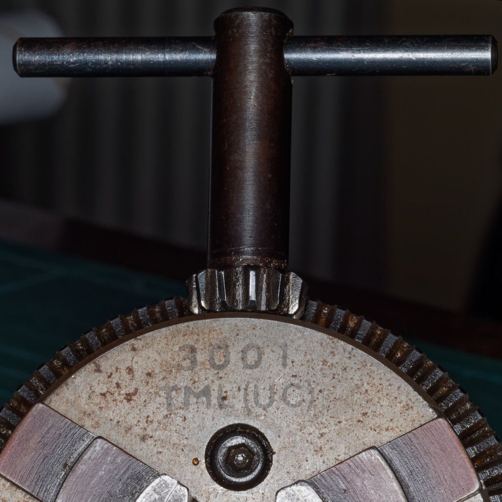

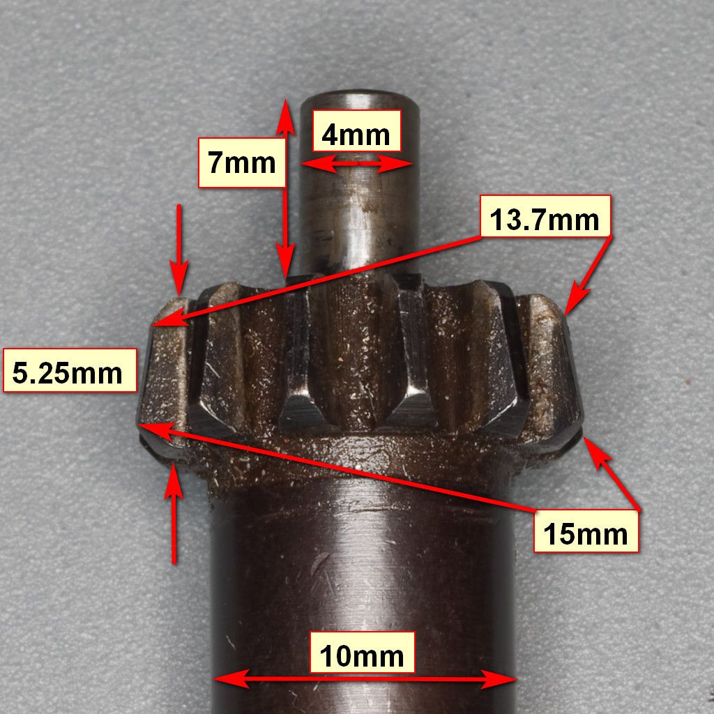

              Not yet having learned to drive a CAD package, you'll have to make do with photos, and yes it looks like I should have cleaned it first. blush
              The signwriting says;
              3001
              TML, or possibly TMI followed by (UC)
              The core diameter of the base of the teeth tapers from about 10.75mm to 9.75mm
              I'm guessing I bought it from an advert in Model Engineer in the early '80s and had the choice of a 14x1mm or 14×1.5mm backplate, so it looks like they were marketing it for a variety of lathes.
              I think early Cowells were 1.5mm pitch, later changing to 1mm.
              For those who've never seen one before, the jaws are reversible, even though they operate on a scroll like a conventional 3 jaw self centring chuck.
              N.B. this makes the teeth on the rear quite weak, so great care must be taken when tightening the chuck, particularly at large diameters when not all the teeth are engaged in the scroll.
              Don't ask me how I know. frown
