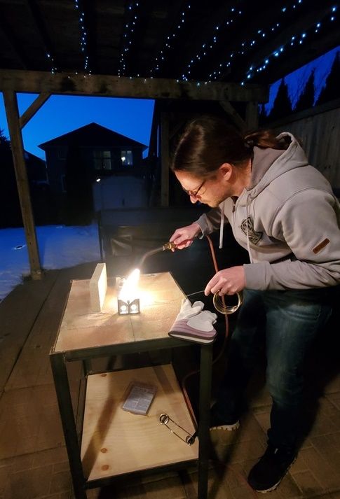

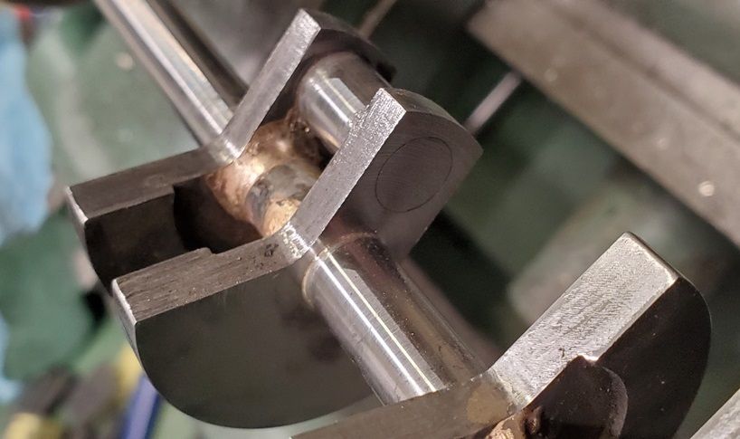

        So i have just pinned and silver soldered my Stuart Triple Crankshaft. I am happy with about 50-60% of the joints but some of the others did not capillary into the joints….i think because i did must have 'burnt off the flux'
        I have pickled the crankshaft and cleaned up up the best i can with 400 grit, but i am concerned that because i can't disassemble the joints now that i cannot clean them up properly…..do you think it will solder up again if i reflux the outside and try again?

          Probably a good deep clean in pickle, followed by careful rinsing and trying again looks to be the best option you have, short of removing the pins.
          Personally, I would not have pinned until soldered satisfactorily. That way it could have been relatively easy to ‘unsolder’ it in order to start again, from scratch.

            For me, the brick behind your flame would have been more effective it it were closer to the work, so that the flame "licked" around the workpiece.

              Is that a metal V block you are soldering on in the pic? That would be sucking up all the heat from your torch. Not to mention doing the V block no good.

                I occasionally get the odd joint which wont take (I do this every day near enough). You need tenicity flux, not easyflow, then get it real hot. Get it hot enough and the flux will do its stuff. It will flow into the joint by capillary action before the solder melts but it needs to be a lot hotter than normal – no idea why, but it works.

                  The problem and solution to it lay in the same place – behind the torch!🤔
                  The picture indicates that your heating technique is flawed. Do other problems lie ahead? Do you appreciate WHY you have to do what you do to make successful joints?

                            The V-blocks didn't take to much heat, they got warm but not hot. None the less, i could use something else and for sure i can try more firebricks that are closer as well.

                              You have to get the overall part pretty hot, and then focus on one joint at a time to bring it up to the wicking temperature.  There is a certain sweeping motion required to spread the heat a bit on the joint.  You don't want to create a hot spot on the joint that will overheat the flux.
                              It takes a very surprising amount of heat to get the metal up to the temperature where the silver solder will wick, and for that reason I don't like to silver solder things, just because refilling the oxygen and acetylene bottles is expensive.
                              I generally use a shaded welding goggle when silver soldering due to the brightness.
                              If you are not seeing a wicking action starting on the surface, then the metal is not hot enough.  Don't feed in the silver solder if the wicking action has not started, else you get the cold blobs.
                              Without a clean joint and good flux, and sufficient heat, there is no wicking, but rather just blobbing on the surface, which has very little strength.
                              The strength in a silver solder joint relies upon having a thin joint, and a completely wicked joint.
