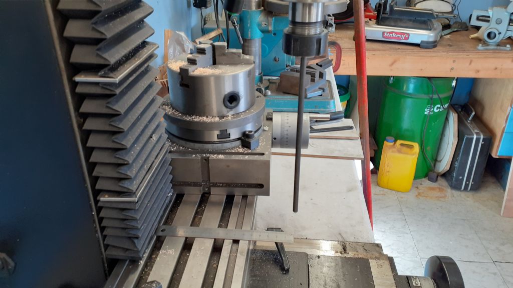

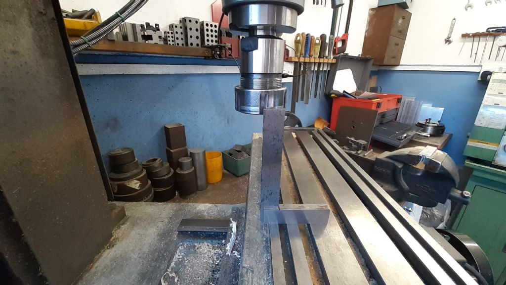

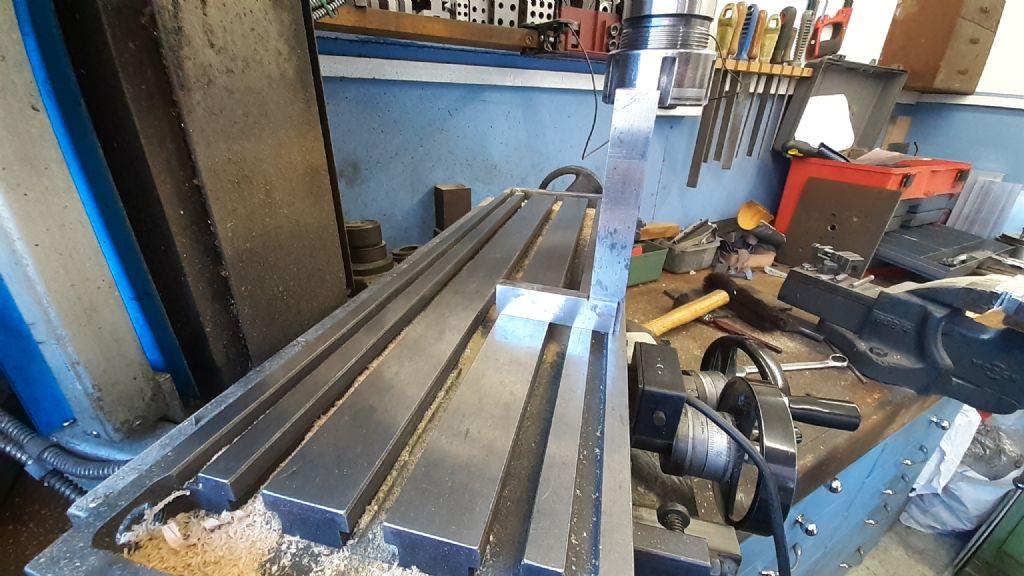

                          It would certainly be nicer to have more Y movement on the CNC for things like flywheels, something like a Haas CM1 compact has 300 x 250 table movement compared to the KX3's approx 300 x 140 but it may take me a while to save up for one.
                          This shows the SX2.7 where you can get the spindle 50mm infront of the table and almost to the back
                          And this is the X3 which I lost a little movement on when I fitted the DRO but once you have acutter in there you can more or less cover the table width.
