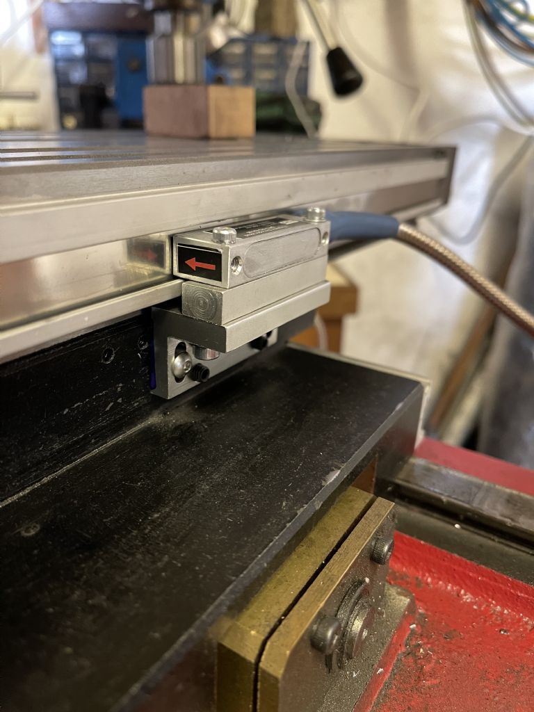

      I understand from Arc that Machine DRO are in the process of putting together Machine specific DRO kits for the SIEG 2.7 and 3 which should be available within weeks.

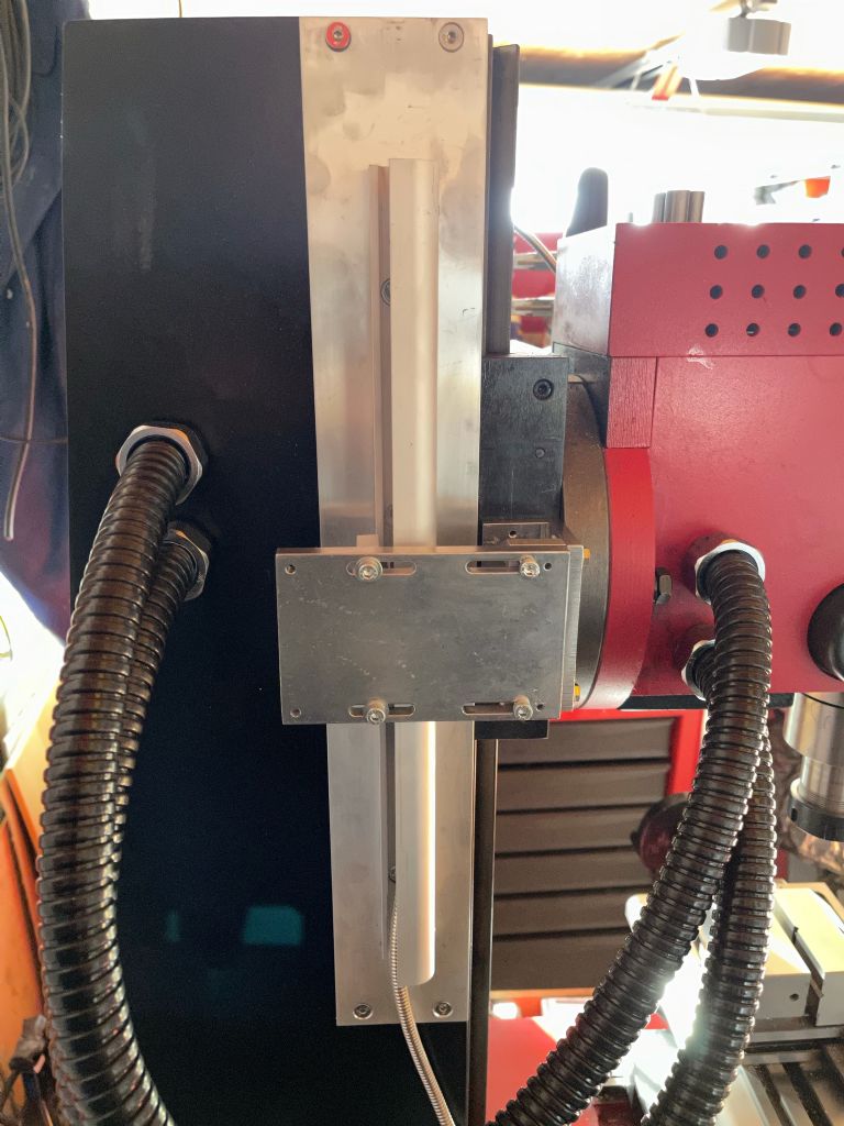

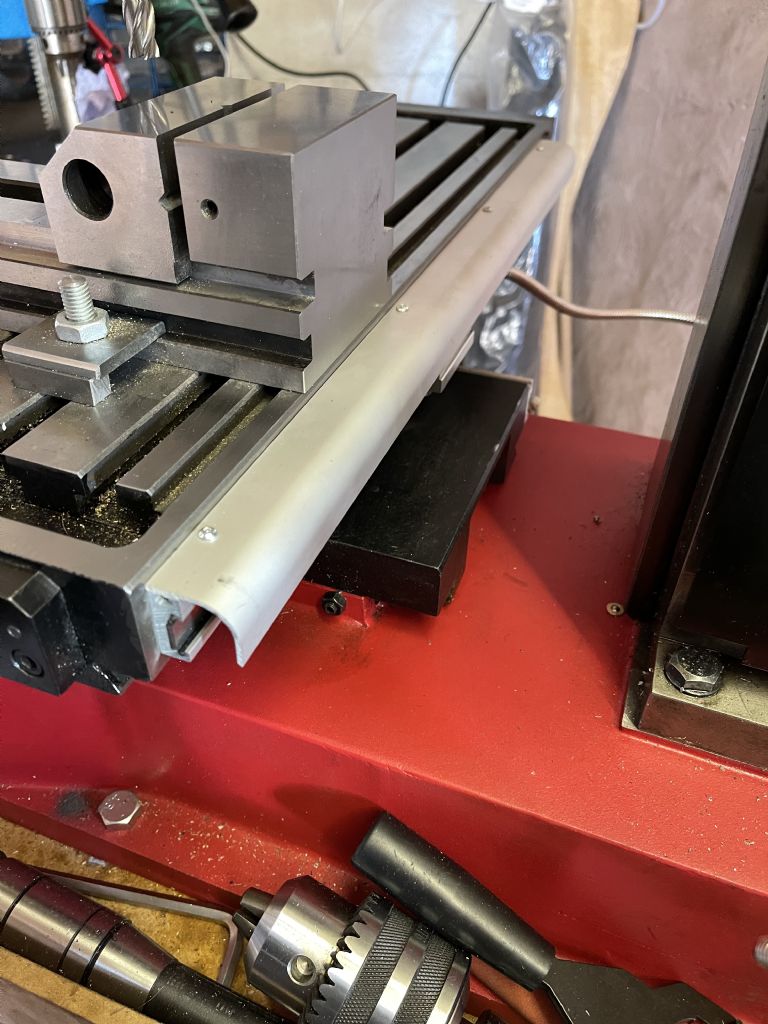

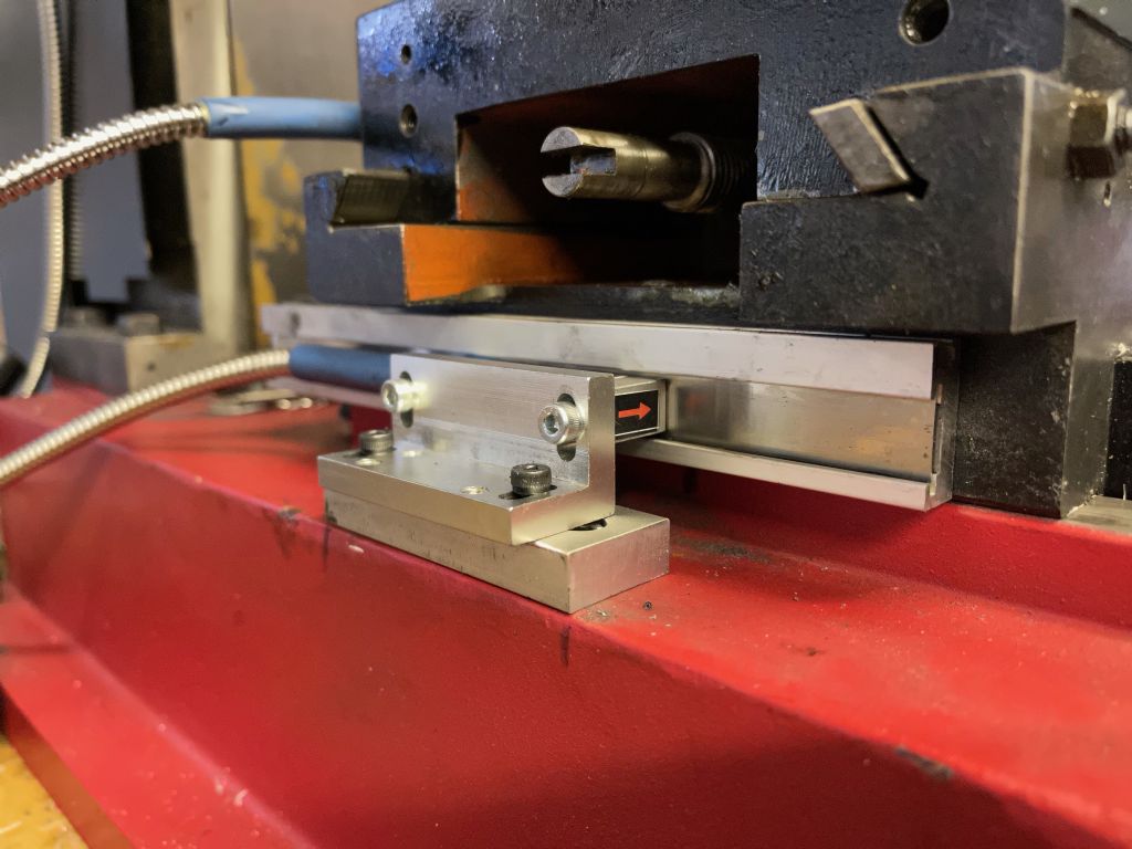

      I couldn't wait so ordered a generic kit ( Magnetic encoders) and have just installed it on my SX3. Here are some images of how I fitted it.
      dro x finished.jpgdro x 1.jpga86917a6-9e59-4031-9e11-c82a12fa2099.jpeg8d9af90a-9acc-4ef5-a9f6-976b90f1026d.jpeg74bd7bb2-0dab-4cfd-92a1-84a8d20ec595.jpeg39423468-07a4-4ecd-a2cf-8f1cf78cc782.jpeg

            I purchased the kit from Machine DRO and used their magnetic encoders.
            Actual length of the encoders are as follows
            X Axis – 500mm
            Y Axis – 200mm
            z Axis – 400mm
            Take into account the company uses its part numbers and lengths based on the actual physical travel of each Axis which is 50mm less than the required encoder for each Axis.
            On the standard SX3 table the X Axis 500mm encoder sits perfectly in place just short of the table drain plug.
            The only real work was fabricating a stand off sub assembly for the Z Axis to ensure the encoder was parallel to the column casting. Here I made 4 off x 17mm bushes which spaced out the ally strip from the column away from the sheet steel column cover.

              Thanks for the info Martyn,
              To clarify, did you mount the z axis scale to the cover or through the cover to the column?

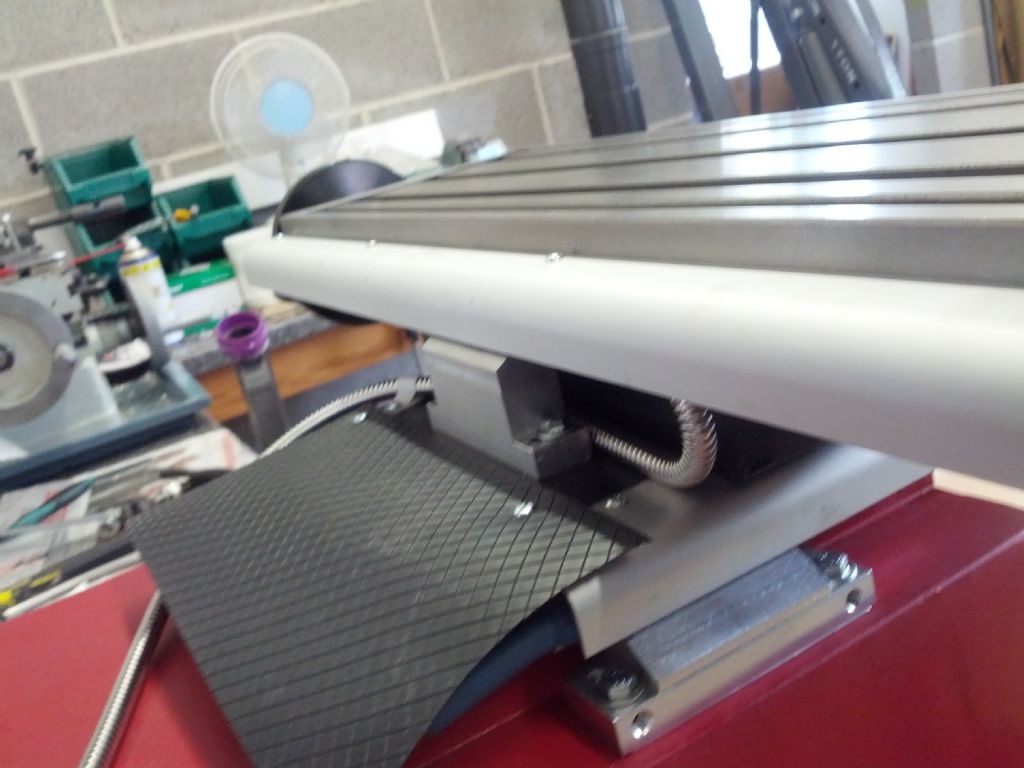

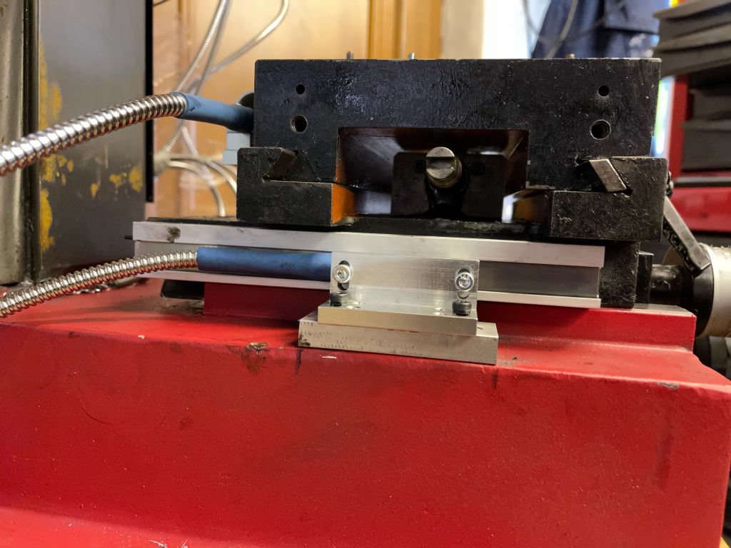

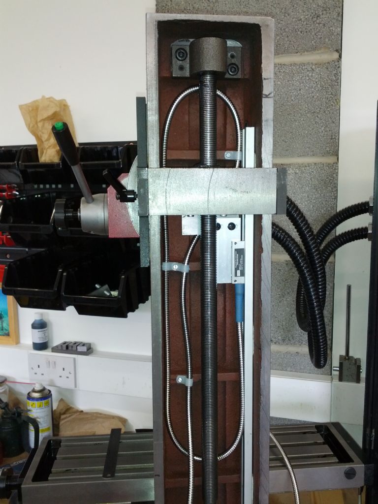

                Last year I wrote an article for MEW on installing a SX3 DRO, trouble is I can't find any record of sending it. Ho Hum, just asked Neil if I did.
                I used the mDRO universal kit, but found most of the mountings were far too large and ended up making my own. I put the Z-axis inside the column. Having it all apart is also a good excuse to clean out the grit from all the places it should not be. X & Y I made sloping to reduce swarf build up.

                      Hi Keith, As Jason said they are from Machine DRO. The rail has side T-slots that hold square nuts, and the cover is drilled and screwed.
                      I looked on the Machine DRO site, and they have a section for rails, but don't have any, it may be worth contacting them to see if they are available.
