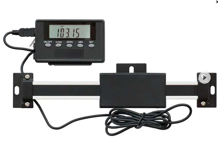

                  DRO is a no brainer.   Before understanding that, several years ago I fitted my mill with Arc Euros cheapest offering, a pair of these:
                  arceurodro
                  Didn’t expect them to last, just fitted as a proof of concept, to be upgraded later if valuable.  They work very well, and have continued to do so.   They don’t have any clever functions, and having two displays isn’t ergonomic, but they still transform the mill!  When one breaks, I’ll be into glass scales etc, but so far the pesky things refuse to die.
                  I’m on the edge with power feed too.   Mainly take short cuts rather than long sweeps, so bearable.  Nonetheless I’d probably have upgraded had not illness and other distractions kept me out of the workshop.  Or gone CNC.
                  CNC is very tempting.  I originally saw CNC as only valuable for repetition work which I rarely do.   But CNC also pairs well with CAD, allowing the designer to specify cuts moving simultaneously in 2 or 3 dimensions.  These are all but impossible to do manually.  Starting again today I would immediately go CNC because I’ve realised not having CAD & CNC is holding me back.   (Learning to drive 3D-CAD is a major investment too.  Already have it for other reasons, so not an obstacle for me.)

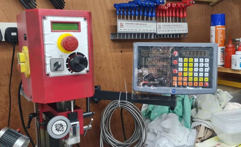

                        Neville, I fitted a 3 axis DRO to my SX1LP, which I think has the same XY table as your SX2. There are some pictures here of my installation. The rest of the thread is the one I found when looking for inspiration. I bought glass DRO scales and the bigger display you mention direct from Ali Express for just over £200 delivered, and they were all great. The only error I made was getting 1micron scales instead of 5 micron, but they work extremely well and make the little SX1LP a pleasure to use.
                        I was able to engineer the Z axis scale so that it reads the actual head position, that gives me Z axis plus the quill movement which is handy, but I don’t think your SX2 has a separate quill so that will be less of an issue.

                          I have had the cheap igaging DRO’s (same as @sillyoldduffer) on my mini mill for more than 6 years and they work flawlessly. I will convert my new mill to CNC but even then, want to use the mill manually so I did mount the same type of DRO.
                          I use a vice for most of my parts I make. The back left corner of the vice is my zero point.
                          If I move the battery powered igaging dro, even when switched off, the DRO will record the move. All 2/3 axis DRO’s that I have found, needs to be switched on (display can be dimmed) all the time or such movements will not be recorded. I can’t use these mains powered DRO’s because I switch off the power when I leave the shop.
                          I have read that there are absolute DRO scales that can be safely moved when switched off but I couldn’t find these. They are probably not for a hobby budget.

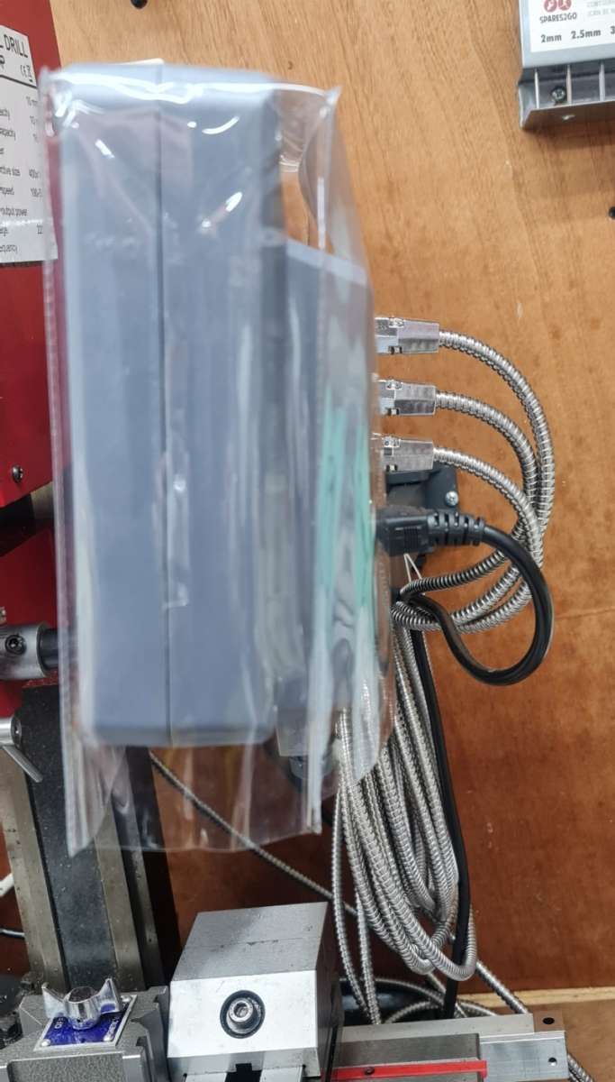

                          howardb
                            @howardb
                            arceurodro
                            I have the same ArcEuro basic DRO on the Myford S7B on the Z axis – saddle/carriage travel and it’s very good.
                            The motivation for this was previously machining a replacement poly-V pulley for a planer/thicknesser with a pitch between the grooves of 3/32 – 0.09375″ using the leadscrew handwheel@ 0.125″ per rev, backing off using the topslide @ 0.03125″ to get to the required 3/32 tool travel while retaining the zero point.
                            What with interruptions and phone calls you can see why I went for a DRO.
                            As long as you take care to shield the scale from swarf/coolant/cutting oil and arrange a saddle travel end stop to avoid wrecking it,  they are as good as any DRO.

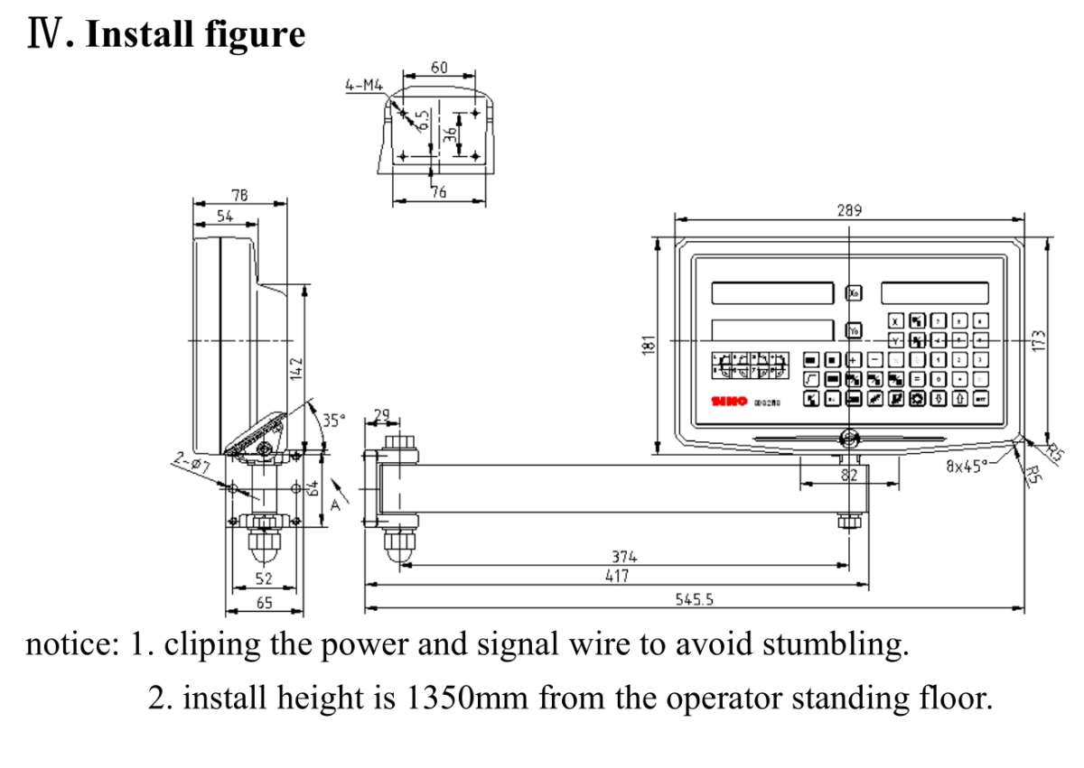

                                Q1 Good practice is to fit the scales so that the opening along which the sensor head slides is facing downwards, and then fit chip guards over the scale. Most scales will come with an aluminium chip guard, although they are quite bulky and eat space on a very small mill. I intended to fit some plastic angle over my scales as being neater – however I still haven’t got round to it and things are working OK after a year, although I do hoover the mess up after each job and don’t use flood coolant – just a paint brush!
                                Q2 The consensus seems to be that there is no standard convention for the pin-out on the D-sub connectors. Kits bought from one of the big boys should be fine – or you send them back. Buying on a mix and match basis from china is probably a bigger gamble unless the vendor can provide the pin-outs. There are posts on the internet describing how to diagnose them, and then resolder the plugs to match your head unit. That said the scales and head unit I bought (from the same China vendor) worked out of the box.

                                  @nevillet
                                  Hi Peter,
                                  What are the dimensions on your DRO head unit?  (every mm counts around here…)
                                  #792992
                                  Peter Cook 6
                                    @petercook6
                                    This is the install drawing.
                                    DRO Drawing
                                    It corresponds to mine except that the arm length on mine is 373 rather than 417.
                                    The depth of the head unit is right at 78, but you need to allow another 70-80 behind that to allow for the D-Sub plugs and armoured cables. I have mine mounted to the wall at the back of the mill. The pivot on the wall is 220mm from the centreline of the mill, and the arm is usually at 45degrees
                                    DRO positionDRO side view
