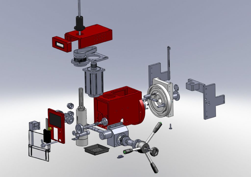

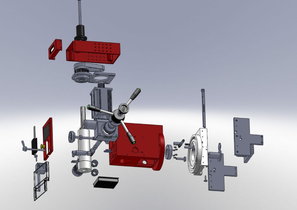

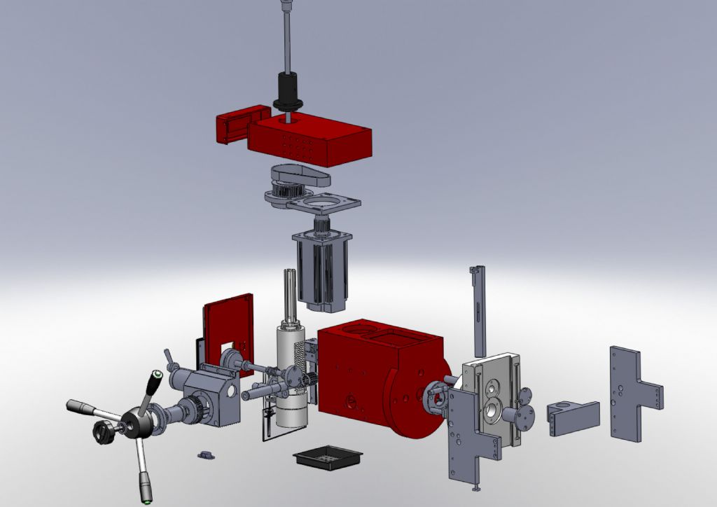

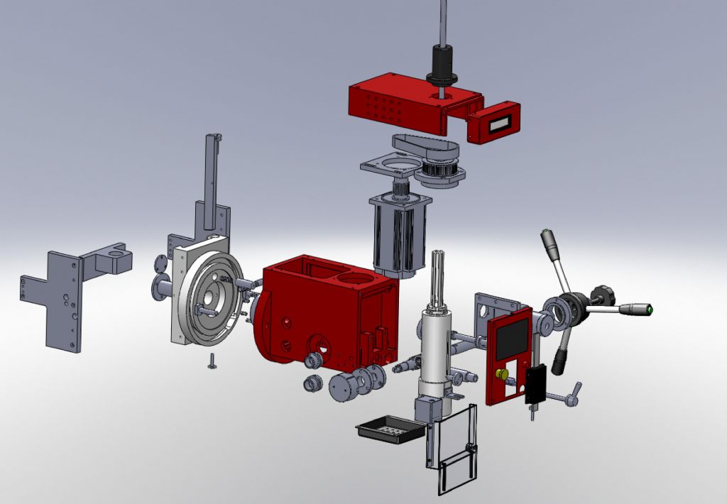

                The hexagon slot at the side of the mill is not a screw, it is the end of a pinion shaft and the locking pin has a rack machined on its bottom side. Sometimes it may stick and jamb. To tilt the head, loosen the 2 clamp screws and apply a turning force with a hex key while jiggling the head to loosen the locking pin. The imaqes below show the internals of the mill and may explain how the rack and pinion lock pin works.
                Regards, Paul.

                  Thanks for all the info. From your detailed description Andries and the very clear diagrams Paul sent, I now feel quite confident to carry out the repair.

                                Well, I finally plucked up enough courage to strip my Sieg mill to fix the tilting problem. Because of all the detailed info you all provided, particularly the exploded drawings Paul included, it was much simpler than I anticipated. I didn't disconnect the electrics so had to strap the main head and the back cover to the mill table so I didn't accidentally knock it off.
                                Unfortunately I was unable to get the allen pinion out of the body to fix it but was able to remove the locking pin and leave it out when I reassembled the mill. I can now tilt the head but don't have a fixed stop at 0 & 45 degrees. That doesn't bother me as I always tram the head after any movement anyway.
