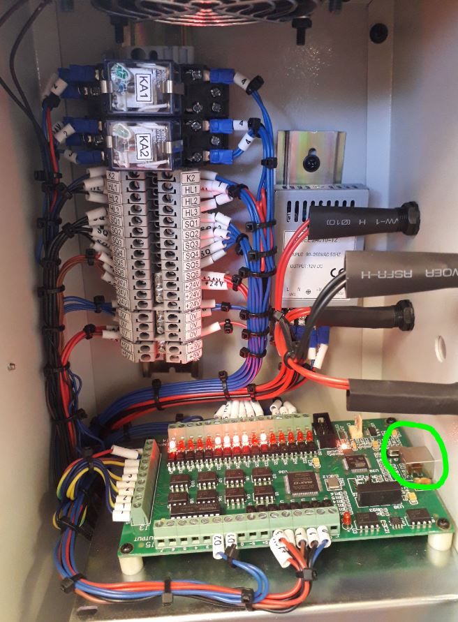

      I replaced my LED lamp with a "quieter" EMI producing LED lamp. That helped. My UC300eth is powered by 5V from a USB cable. I moved that to a USB battery pack to reduce ground loops. Just learning about those! That helped massively with spindle erraticness. EMI is still present but its effects on the spindle are very minor.
      So over the last few months I've been experiencing unexplained inaccuracies in machining I've put down to bad workholding and user error. Tolerances haven't needed to be critical, up until now. I started machining some small parts out of mild steel using two passes.

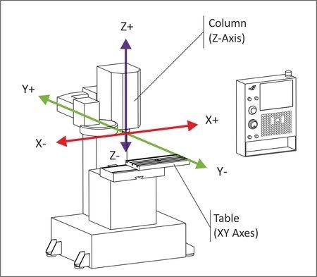

                            Actually, the table is gradually moving away from me, meaning it's having problems 'moving' the spindle in the + direction.
                            Very strange behaviour if none of those fixes sort it out! I suppose it could be a Stepper driver failure, but I doubt it.
                            Nicola, I am not sure I understand your axis direction – If the table is moving away from you, its the same as the table remaining still and the head moving toward you – that is Y -Ve direction, not +Ve…
                            Not really important here as it still has no bearing on the problem..
                            I doubt backlash comp has anything to do with this – backlash comp is a symmetrical function and would not create such asymmetry.
                            Nicola, if the G-Code file is not to big would you care to post it here?

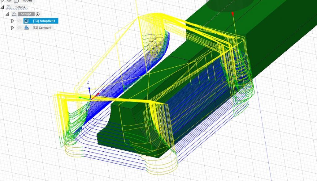

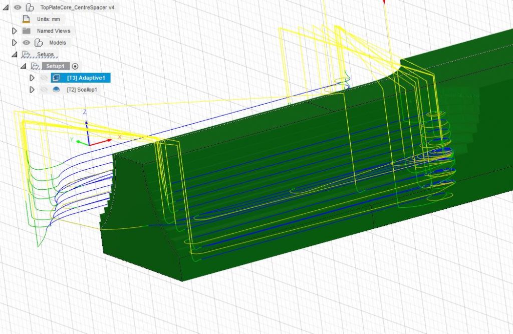

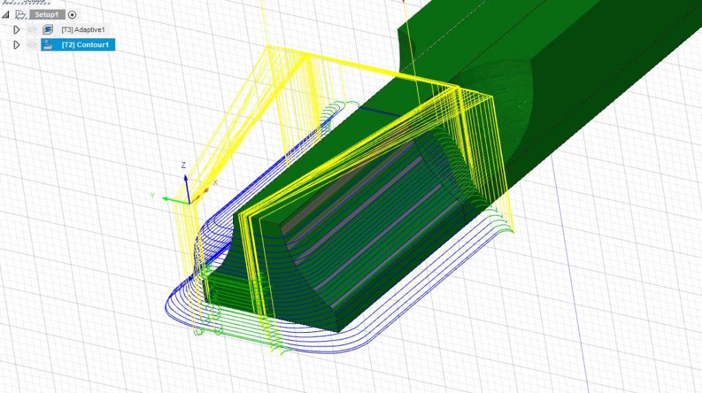

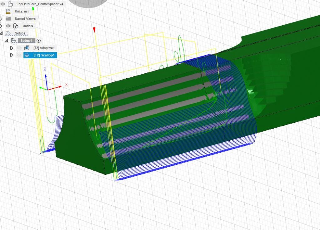

                                                  Nicola, when you do those tests that show the Dti reading zero but Mach screen 0.3 are you moving by jogging until dti reads zero? I would have thought you need to get mach to move to a position and then back to zero and then compare dti to screen.
                                                  Joe, I'm not sure if Nicola pays for F360, I have a feeling she is using the free version in which case Rapids will not be enabled and it will be moving at the feed rate, seemed like that when I ran a bit of the code on my machine yesterday
                                                  Nichola sent my her F360 file and I can't see anything that would make the metal distort in Y so that early question can be ruled out. There are some quite heavy cutter engagements of the 12mm tool (unless Nicola is using shorter stock) Could it be play/backlash ? otherwise cuts are quite light at 3mm wide x 1mm deep. Maybe try putt the dti on the table and jogging one way then the other and see how many 0.01mm jogs it takes before the dti shows movement. maybe also play in the X gibs.
                                                  These show the her tool paths which I have suggested some alterations to as step downs are much too small on the adaptive and take a long time with that slow moving hss tool. Yellow are "rapids" but likely running at tool feed rate. Blue is cutting.
                                                  Then she had a contour with 10mm ball to finish, not in the g-code
                                                  Compared to my adaptive but still with here tool choice and speed/feed
                                                  And my scalope to finish again with her tool
                                                  Edited By JasonB on 07/05/2021 07:28:47
