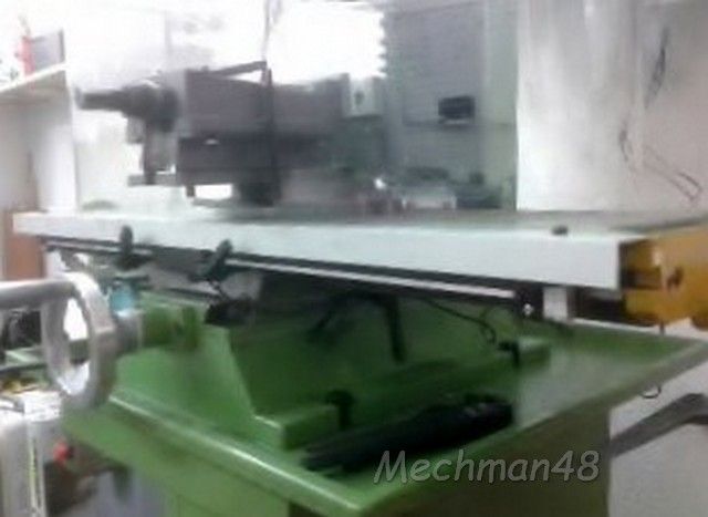

                                          mechman48
                                            @mechman48
                                            My WM250 V-F is on makers stand sat on a couple of rubber mats, my WM 16 is stood on 4 anti-vibration adjustable pads & both have been levelled up… according to my spirit level & digi level. I have attached both stands to the studding wall with large shelf brackets to eliminate any possibility of either toppling over as both are top heavy on supplied stands, so far so good…
                                            ​Shelf bracket can just be seen bottom right, similar fixed to lathe stand
