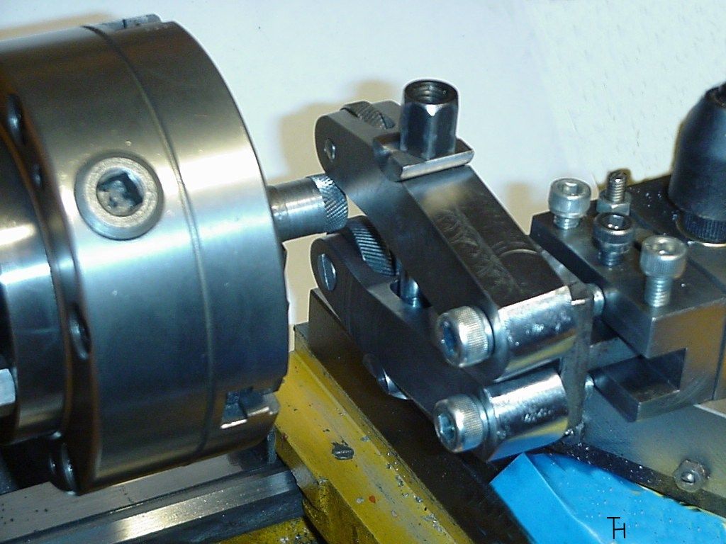

          Just in case anyone is likely to be put off by sophistication and fine finish. This one had given about ten year's good service before it was adapted to fit my QCTP. Capacity about 1".
          QCTP Knurling Tool

                    Here is the knurking tool I made years ago, it has served me well.
                    Thor
