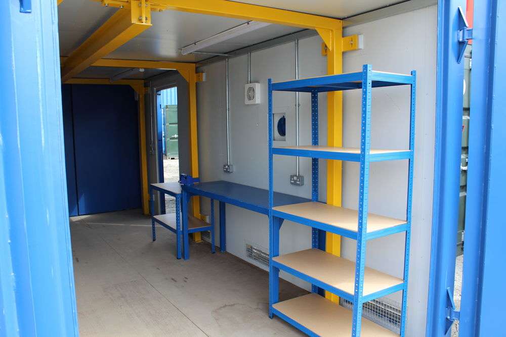

      Looking to get a 20 foot shipping container to store some workshop equipment and be used as a very ocasional workshop.  I am i sw london.  I am thinking other members may have thought of this as an option when they dont have space at home. I rent a garage at moment. Its damp and not secure.  Container would sort me out. Any thoughts ?
      #719549
        Following my relocation in mid 2022, I have been renting a container for ‘general storage’ whilst I am working on the property [so not exactly your scenario].
        I have been very pleasantly surprised to find no problems with condensation or wild temperature variations, despite two winters, and some very hot days in Summer.
        A good container seems like an admirable solution so far.
        Provision of power and light will be a ‘challenge’ of course … but the only serious difficulty seems to be that when those big doors are open, you and the contents are at the mercy of the elements !

            Try Containers Direct for some ideas.
            img_1869

                If you can get an old refrigerated container, it is insulated all round so makes a great workshop for hot or cold weather. Otherwise they are stinking hot in the summer and freezing cold in winter. Trade-off is you lose a few inches of internal space on each wall with the insulation thickness.

                                From direct experience over many years with ISO containers and more recently knowlege of how the military continer compatible units are built (can’t share details of those) I can say that condensation is an issue with them. If you get any moisture inside it can be very hard to get it out again. An uninsulated container will develop it’s own climate and you can literally get rain inside them from condensation on the inside of the roof. Even going inside with a wet coat can start problems. Insulation or / and lining will help a lot. A “sunshade” roof will also help. This is a flat roof above and slightly larger than the container. It is spaced off slightly pitched (side to side) and open all the way around. This keeps the sun off and hot air on the underside can escape. It also stops direct rain on the top of the container which causes sudden cooling. Also helps stop rusting
