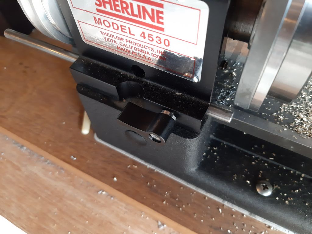

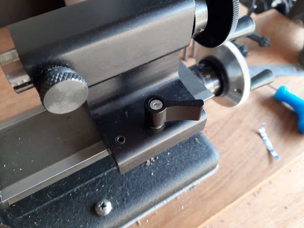

      Just received some mini locking levers from the far east.
      Installed one on the tailstock and one on the cross slide stop.
      Really pleased with them, I would guess most sherline users get fed up reaching for the tee key and I'm no exception.
      5mm thread so you need to re thread with 5mm tap.
      Got them off ali express at jadkinsta official store, cheap as chips, £2.38 for the two.20220422_154051.jpg
      Geoff

          Thanks for the tip. They look similar to those supplied by Eccentric Engineering with their Acute sharpening kit.
          BTW, is your lathe sitting on Blu Tack?

            Hi eva,
            Yes they are a useful addition to the lathe.
            Forgot to mention they are spring loaded around a hexagonal top so are adjustable for position.
            No it may look like blue tack but it's just a cardboard cereal box base. Just felt a little compression was a good idea when mounting the lathe on the baseboard

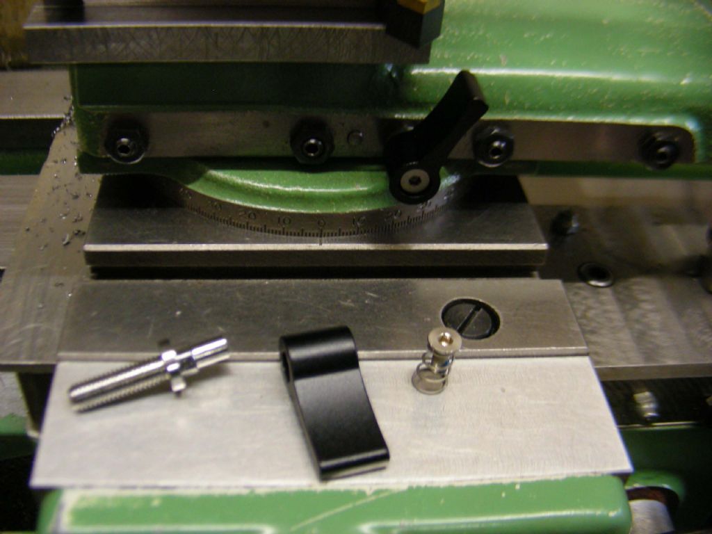

                    I bought some of the adjustable handles you mentioned and have fitted one as the topslide lock on my Myford:
                    Obviously, they don't come in BA sizes and I opted to modify a 6mm one to 2BA. This was quite fiddly and another time I think I would make the threaded "spindle" from scratch.
                    The handle is aesthetically out of tune with the rest of the machine but seems to work well and, of course, this is a prime location for an adjustable handle.I have shown a dismantled handle in the photo.

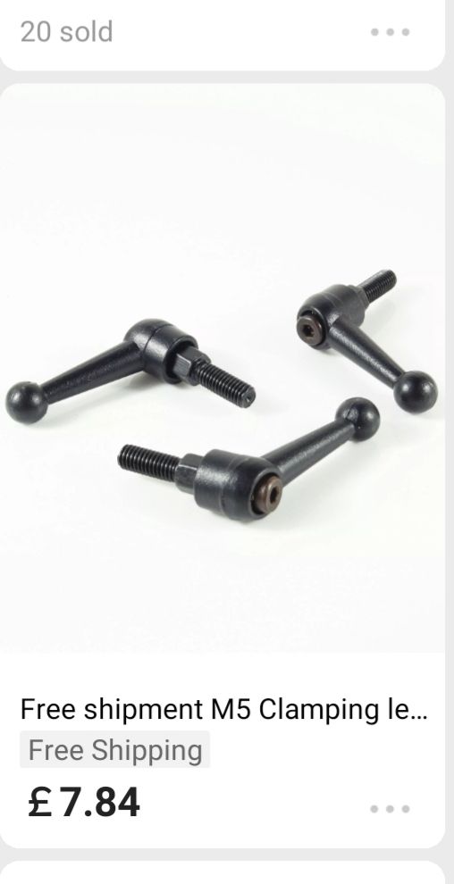

                      I opted to change the thread on the sherline from 10-32 to 5mm. Not a problem as the pitches are almost identical at 32 and 31.75 and the 5mm tap removes just a small amount of metal from the 3/16" 10-32 thread.
                      I've just bought these on ali express to fit the tool posts on the sherline. With postage tax and a £5 discount I get 4 levers for £4.01p, yes £4.01p
                      20220511_232554.jpggeoff
