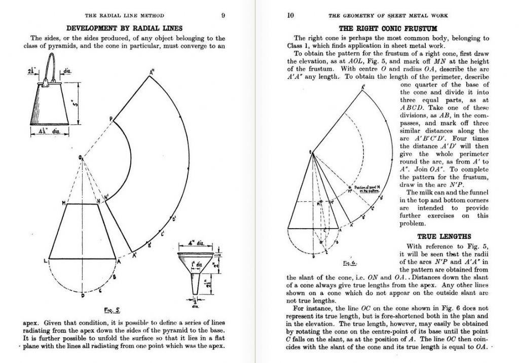

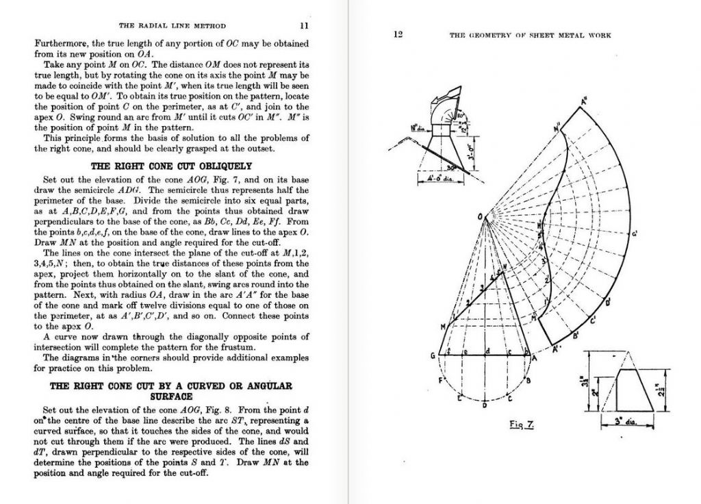

                            So basically a bucket without the bottom.I`d never heard of the term Caldera cone. Made cones all the time in my previous life as a sheet metal worker. If it was 1/16" ali you could easily bend by hand over a suitable round form but 3mm is pushing it.
                            From the sheet metal workers bible:

                              Very interesting about the oil cans. Nice drawings from the sheet metal book. I also worked a lot with sheet aluminium, stainless and titanium when I was an aircraft technician.
