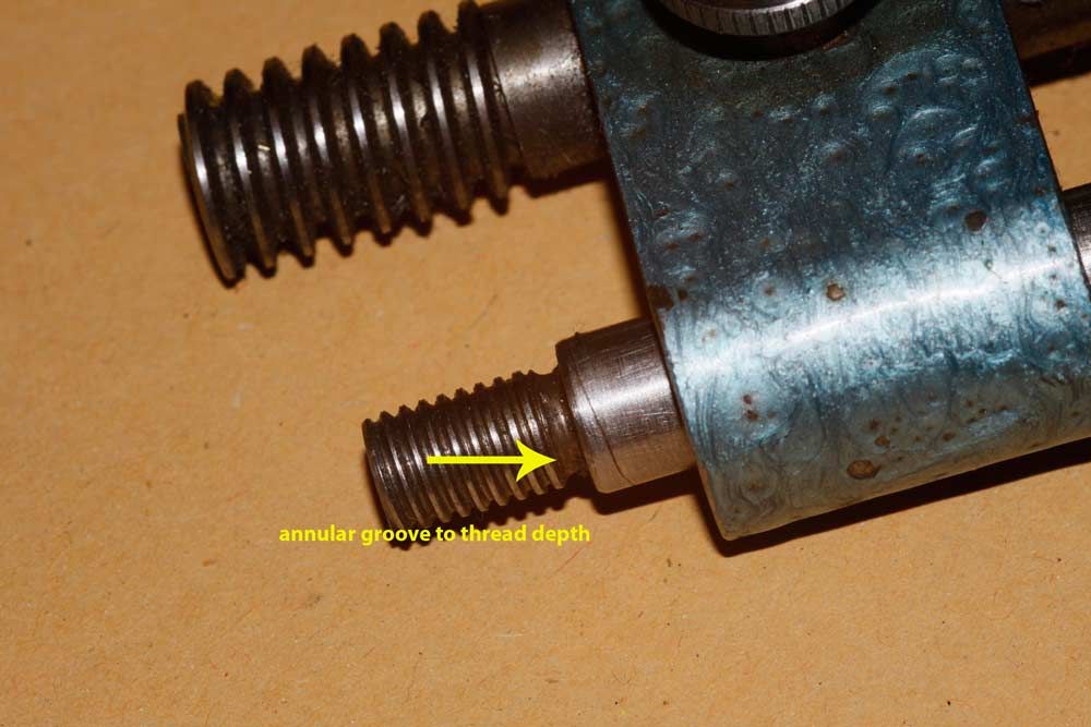

Three things – the least important first.
It will screw neatly up to a shoulder and is much more likely to locate square. – which is pretty handy in a drawbar
It means that the load form tightening up the nut or drawbar is carried in the threads and that any stress from that stays in the threads. The longitudinal load is carried in the minor diameter. Because you have a gradual transition in section (rounded groove), there is no stress raiser to concentrate the stress artificially. thus stress levles are lower and the item is stronger and less likely to shear than if you just stop the thread. nad hte hting is much stronger, than if you just stop the thread.
As I recall – because I haven’t done the sums for a very long time – by a factor of about x3.
The fatigue life is increased significantly.
In engineering you never want a violent change in section and all sharp corners should be radiused. Not doing so is a very nasty dirty habit which weakens things unecessarily, makes them more prone to fatigue fracture, and is akin to picking ones nose (or worse)
in church. Lots of corners don’t get radiused because machinists are to damn idle to radius tool tips properly, or to put grooves in where grooves should be put in, to the considerable detriment of the item being made.
It should be done as a matter of course with cut threads – screwcut or die.
