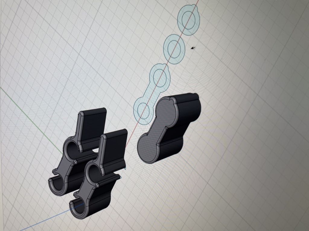

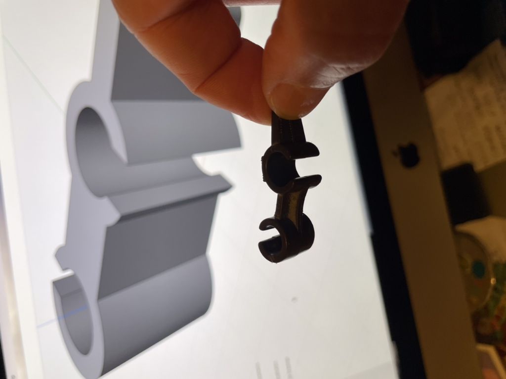

            Yes, I have just started using Shapr3D.
            It is my first CAD and it runs on iPad and Mac, which is what I need.
            I believe it uses the Solid Edge CAD software internally, with an interface to work on an iPad with an Apple pen, or on a Mac with a multifunction mouse. Most of my work will be at home, but it might be useful to be able to design on the iPad, away from the desk.
            My primary use at the moment is learning to make parts to 3D print. On the Shapr3D website there are a lot of tutorials and forums for advice and help. It is quite intuitive – I have never used CAD but these parts did not take me very long to create, and it is very easy to add fillets etc. to the drawn 3D shape. You can quickly sketch a rough shape, then go round and type in the actual dimensions, to refine it, and it all changes accordingly. £300 for a year seems very reasonable, or there is a limited free version I think.
            I can certainly say it is easy to use and get the hang of.
            My first items are simple pieces to learn the CAD, and are hinge/connectors to replace the broken ones on my clothes horse !
            My photos are 90° rotated and I don't know how to rotate them correctly, but you can see the idea.
