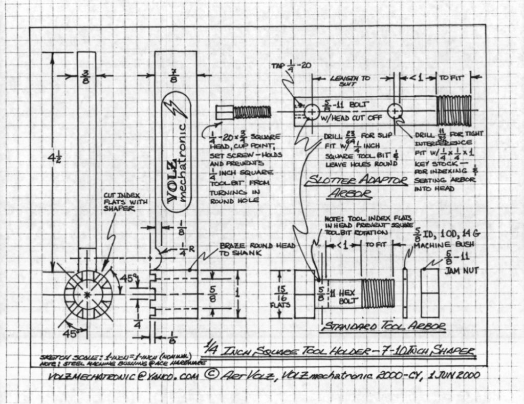

            I never got around to making one of these Andrew but this design (by Art Volz) for a small shaper toolholder may be useful to you. All of the homemade versions of this type of tool holder that I've seen use brazed or welded construction.

                    Ian,
                    Many thanks for posting the drawing by Art Volz. A picture is better than a thousand words. I can now understand how the holder works. That particular tool covers several fixed angles. In my simple minded way, I thought that the tool holder angle was infinitely variable. I could not for the life of me see how the adjustment was held. Shapers being notorious for loosening anything that can move! Having cut gear teeth on my shaper, I know only too well that a shaper can often loosen the work, especially if it isn't in a vice or clamped firmly to the table.
                    Serves me right for having a preconceived idea of how the tool works. Without that, I might have twigged how the tool actually functions.
                    Many Thanks,

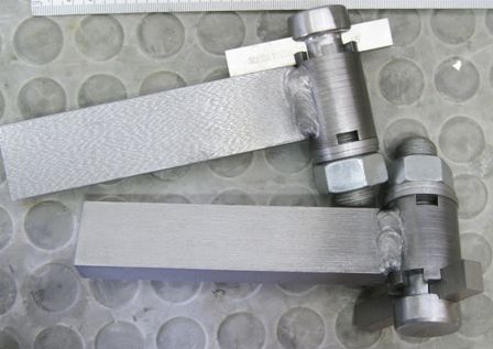

                    Joseph Noci 1
                      @josephnoci1
                      Here is my home made version
                      Joe

                          Thanks Joseph,
                          I have already started making up my version, If only I had cottoned on that the angle wasn't infinitely variable!
                          Andrew.

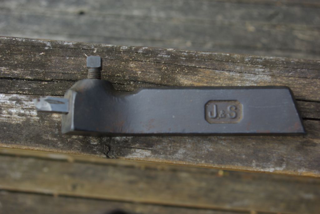

                                        Andrew, I don't know what size of shaper you have but I use small 'J&S-type' cranked tool holders in my Acorn 7". You need ones that will fit the clapper tool slot of course. Mine take 1/4" tools but the shanks are quite thin too – I can't remember their make off-hand.
                                        Any small change in setting the tools cutting angle wrt the work can be undertaken by moving the head. I guess the combination tool is convenent in the sense that you just have one tool to cut left & right etc – but I have a set of three small holders that essentially do the same thing. If you have to move the tool bit in the combi holder, then really it's just as easy (easier?) to just swop the holder – they will both have to be reset anyway, the transfer gauge mentioned recently being handy for this.
                                        These type of holders aren't very popular these days and if you can find ones that will fit your shaper, they shouldn't be too expensive – I don't think mine were but it's been a while.

                                          There is a photo in my album of a selection of shaper tooling and I have just added one more of a J&S zero rake toolholder, good for shapers and also for brass in a lathe, you can more easily grind on a bit of negative rake for brass if the toolholder doesn't have lots of built in positive rake. From the first photo, car keys for scale only…The left hand tool is a home made brazed carbide tool, I find these work fine in a shaper. Then three old style gooseneck tools, also used on lathes back in the day before I was born. Not really needed if everything is nice and rigid. Then two of the type under discussion, both by J&S. The large one is actually too big for any of my shapers, but maybe one day I'll find something big enough. (It would need to be at least a 24" machine…)
                                          The last photo is a J&S zero rake holder, it would be nice in my 18" machine but is just a little too wide for the lantern toolpost and I don't like to modify either of them
