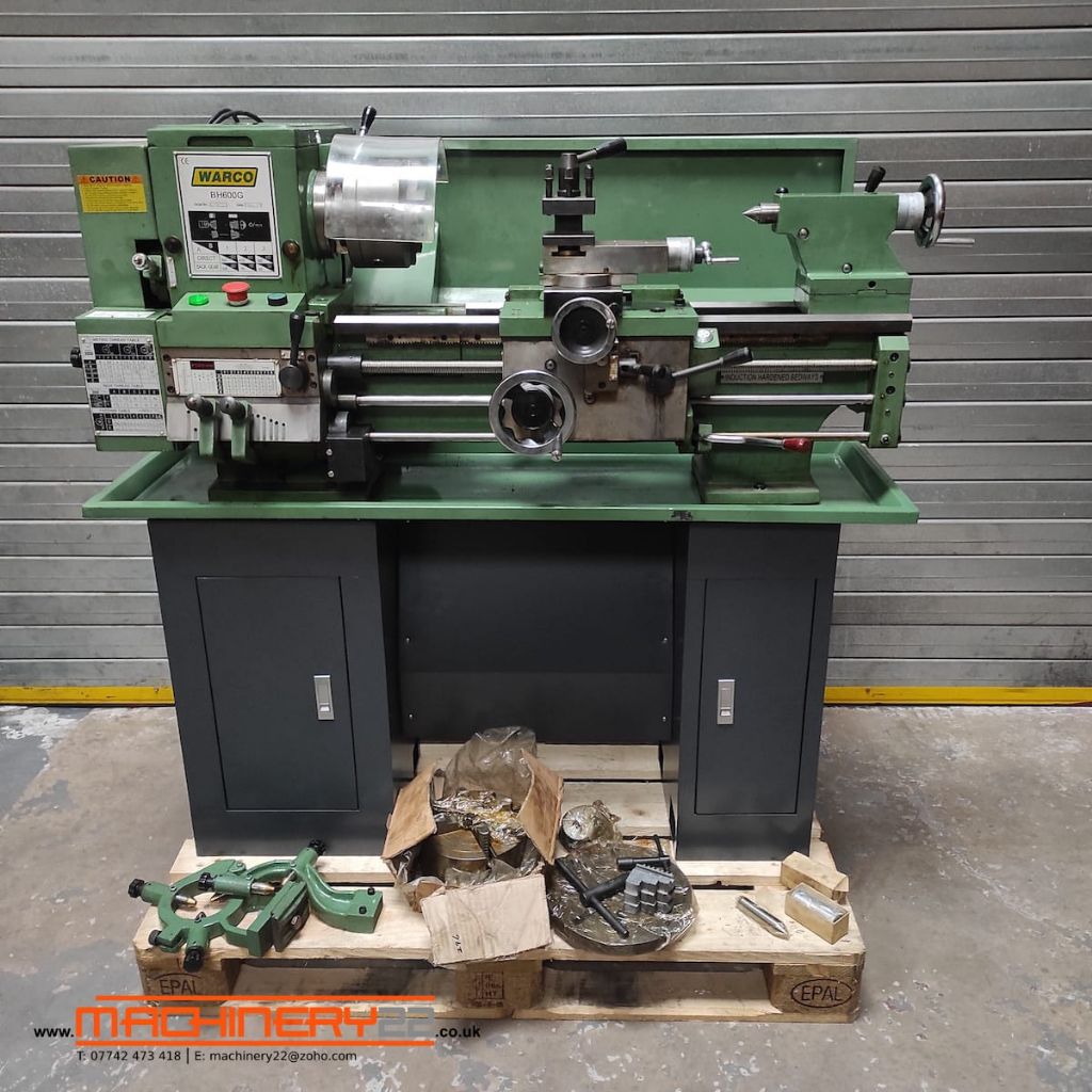

                      Posted by not done it yet on 17/03/2022 07:27:54:
                      My view: If the stand is such that it is too flimsy to move the installation, secure it to a base-plate of some description such that the base-plate can be lifted to shift the whole caboodle by small increments whether by placing rollers underneath or the age old crowbar inching method.
                      End of any potential problem by a little forethought.
                      Yes indeed. Something like this would be ideal. Then you could roll it about on pieces of pipe and or skid it on lengths of pipe with a long crowbar to propel it bit by bit.
                      If you use an engine crane, don't be tempted to lift the lathe by the chuck. Will quite possibly damage the chuck mounting and the headstock bearings. Ideally use a pair of nylon strap slings under the bed, or check the manual etc to see if there are any lifting eye bolt threaded holes in the bed . Be wary of it being top heavy like this though and have a couple of mates to steady it while you move the engine hoist. Maybe take the chuck, cross slide and tailstock off to shed some upper weight.
                      The one in the pic sold for 2025 Quid in UK. So sounds like you got into yours for the right price if it is in anywhere near as nice looking condition.

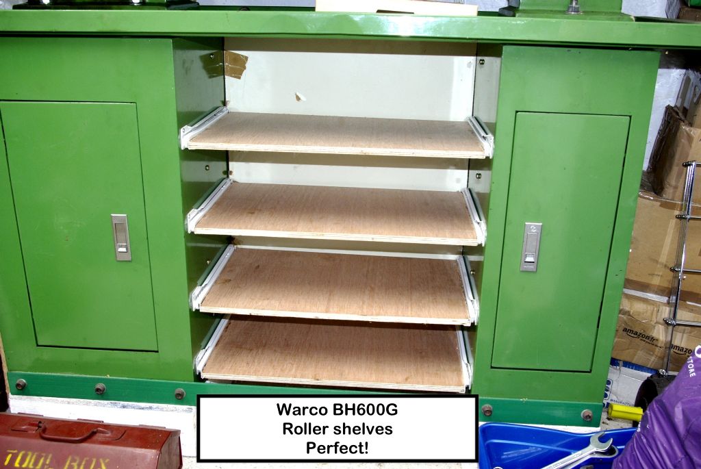

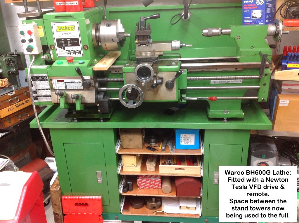

                              Michael,
                              Go to Grizzly.com and download ‘MODEL G9249 12" X 37" BELT DRIVE GAP BED LATHE OWNER'S Manual’, the very best available!
                              My modifications:
                              A few more done since, but no photos added yet due to health issues unfortunately!
                              My Albums headed BH600G & Warco BH600G for more on the lathe.
                              Clutch and VFD without a doubt two at the very top of the mods done.

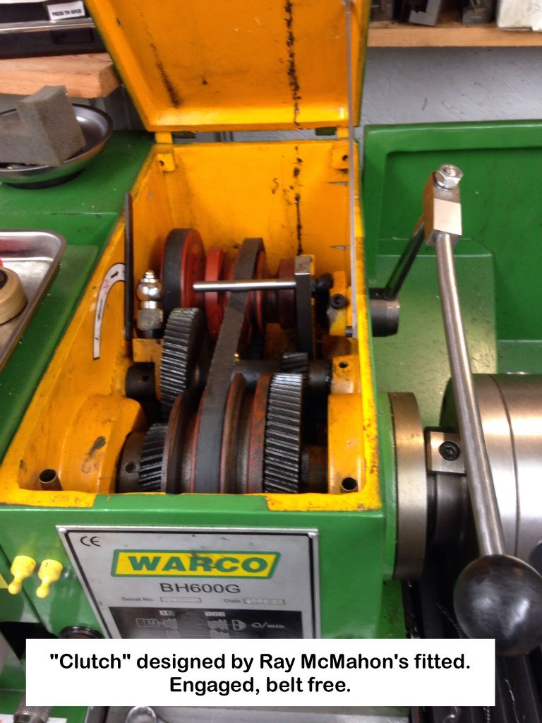

                                Howard Lewis
                                  @howardlewis46836
                                  Hi Geoff!
                                  Good to see you!
                                  The BH600G, (It was obtainable in Imperial or Metric form at one time ) is another manifestation of a generic Taiwanese lathe, (The Chester Craftsman was another UK import )
                                  They came in slightly different configurations and colour schemes.
                                  My BL12 -24 came fitted with a VFD as part of the deal, so lacks the control shaft and lever.
                                  I have often wondered about the Ray McMahon "clutch" but never got round to making one up.
                                  Possibly not vital having the "Jog" facility on the control pendant Having managed without it since 2003, it will ,probably never be fitted!
                                  20 years use must say something about how highly I rate the machine!

                                        OuBallie
                                          @ouballie
                                          Howard,
                                          Thanks.
                                          Missed spending time in the Workshop the last two years🤬
                                          Don't hesitate making that clutch as it transforms the lathe whether it’s single or three phase.
                                          When I had my Emco I got really peed off having to switch off frequently for whatever reason, particularly when making numerous small parts or measuring, but now an absolute pleasure.
                                          I love the ‘Jog’ feature especially when using taps & dies in the Tailstock as well as screwcutting.

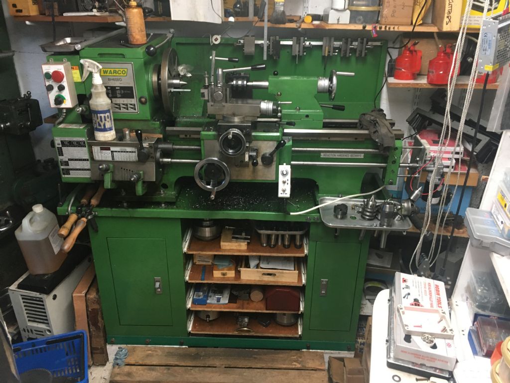

                                          OuBallie
                                            @ouballie
                                            Michael,
                                            Lathe as it is now.
                                            Warco BH600G
                                            The original control switches and housing on top of the gearbox have been removed as well as the main control box from the side of the Headstock as neither needed now with the VFD and remote.
                                            I replaced the original flush OFF button on the remote with that red mushroom one that latches in the off position and needing a twist to release, it being so much easier to activate.
                                            Can’t believe I’ve finally finished adding the independent power feed to the Carriage, using a windscreen wiper motor.after trying various plain DC motors plus stepper ones, and having to learn how to control steppers.
                                            Control of the wiper motor is via the white box on the RH side of the Apron, with direction and speed selection.
                                            It works a treat, now being able to adjust carriage speed independent of spindle and vice versa.
                                            Geofc – Still in shock having finished that project😳
