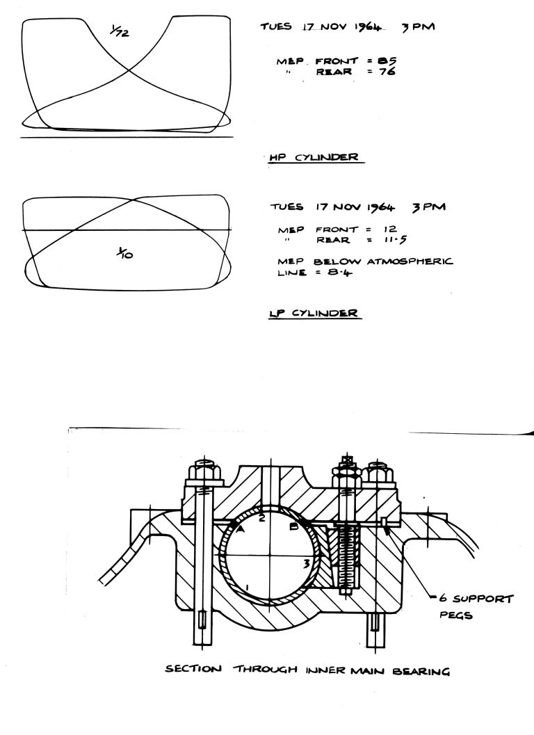

      How were split bearings on old steam engines (late 18th – early 19th century) adjusted. I mean the type made for crankshafts etc. not the type adjusted using a cotter and wedge.
      Presumably the outer cast iron shell would be made undersize so it could be closed up to accommodate bearing wear, otherwise you would have to replace the brasses every time they wore.
      Did they use shims or would they have used something malleable like soft lead sheet? Or something else like thin wedges?

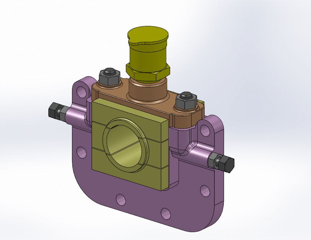

          Neil,
          Steam engines use a split, 4 part bronze bush for the crankshaft bearings.
          The screws on the side adjust the clearance with the crankshaft and are also use to align the crankshaft so it is square with the piston rod.
          Shims are added under the retaining cap for vertical wear adjustment.
          Paul.

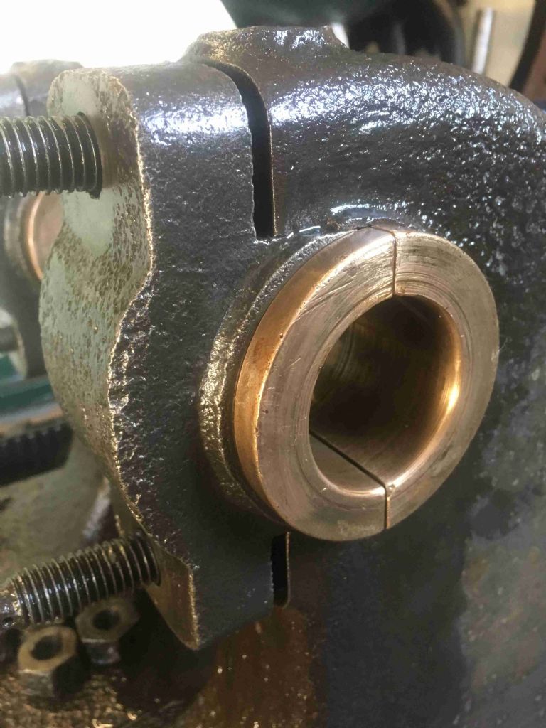

                  Neil, here is a picture (not a very good one) of the 4 part crankshaft bearing on a Burrell portable.
                  Brian

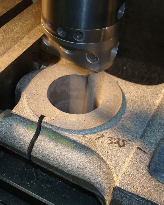

                                    You can often find that the pillow blocks are split on two levels so the split you see either side of the flanges is not always where the split is around the bearing
                                    #322061
                                      Posted by JasonB on 18/10/2017 07:38:10:
                                      I think that's the arrangement I should be looking at. See the image I posted higher up.
                                      I doubt many are really spilt straight across the middle although this is how 99% of models are made.
                                      The 'plan' doesn't give much detail, but I think there's a hint of a split above the centre line:

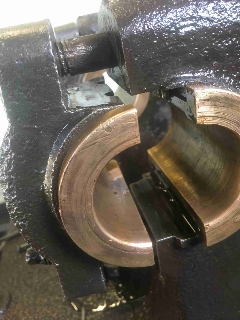

                                      Peter Bell
                                        @peterbell11509

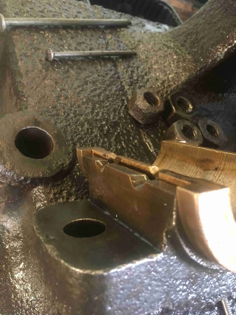

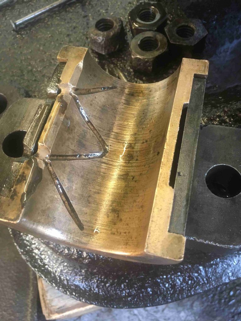

                                        Think I'm a bit late posting, took these yesterday, these are bearings from an engine from around 1880 with the block split at two levels. No sign of shims, probably long gone if they existed, but it's certainly good for a few more years of service.
                                        Peter

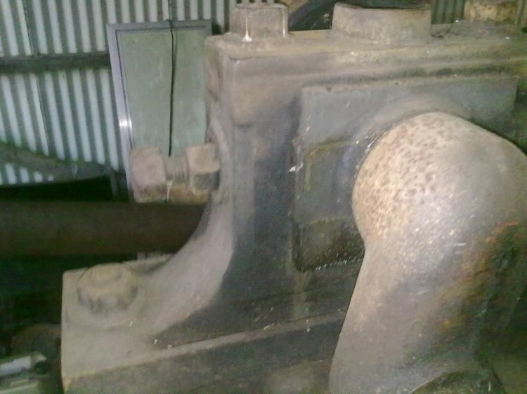

                                            I saw a variation of the split bearing at the weekend. This was on a Marshall portable engine and one bearing was split in half horizontally and the other was split vertically but the split was offset.
                                            I spoke to the restorer and he explained that the bearings could be adjusted in both directions to line up the crankshaft perfectly. The adjustment was carried out using screws to move the bearings and lock them in position. I took some pictures but it is difficult to see the splits because they are obscured by the housing and the oil. The spinning flywheel didn't help much either!
                                            Brian
