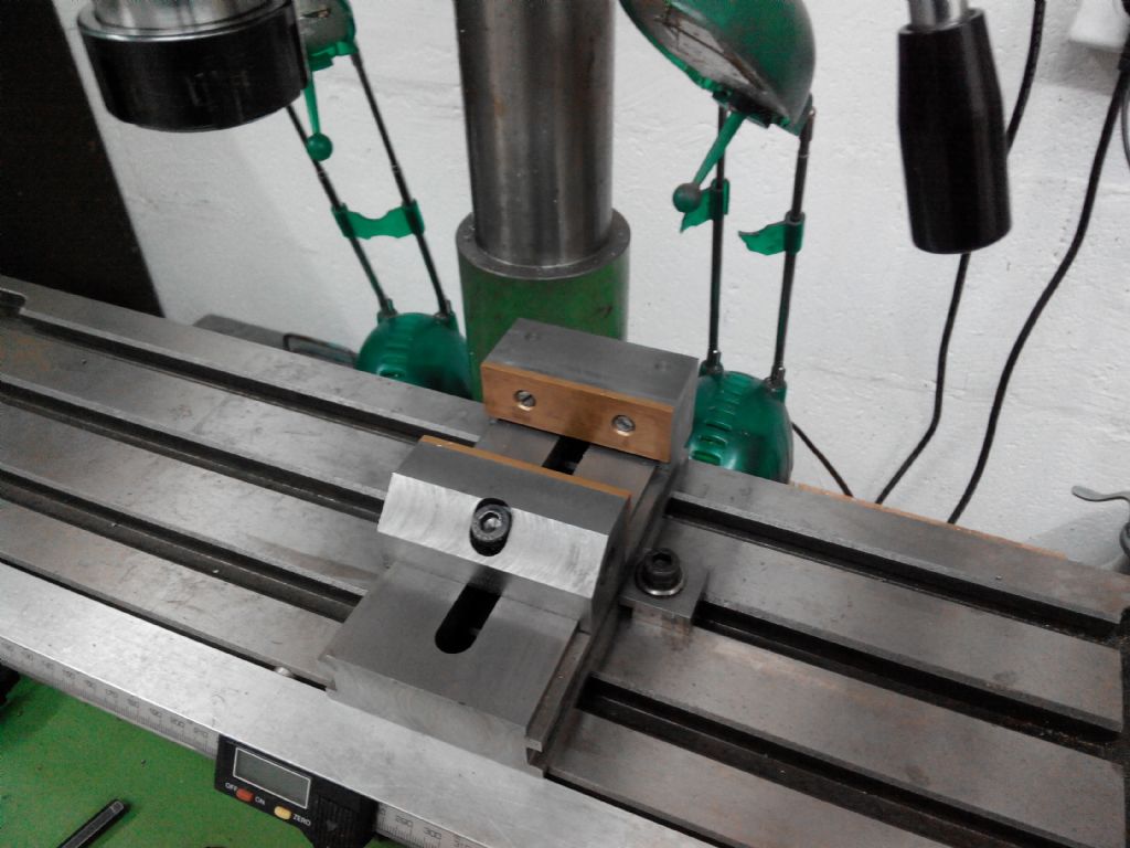

                                                  #369519
                                                  Russell Eberhardt
                                                    @russelleberhardt48058
                                                    Posted by Ian P on 28/08/2018 19:27:43:
                                                    I now use a square off the back edge of the table to align the vice.
                                                    Yes, I've done that for years just using a 6" M&W square against my homemade vice. Never had any problems.
                                                    Russell
