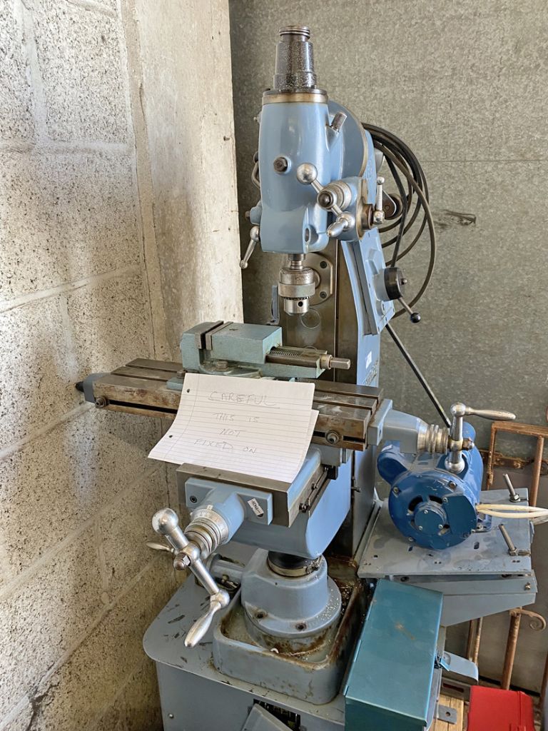

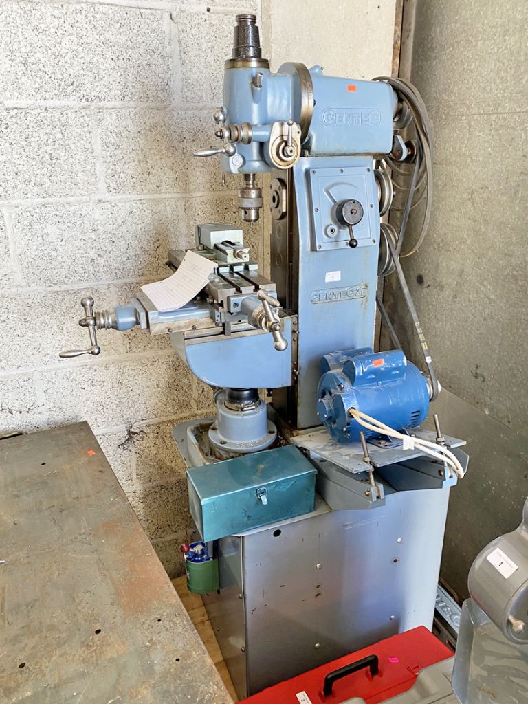

      Just got back from picking up some auction lots and noticed that there were two nice machine tool lots, one unsold.
      First was a nice Myford ML7 partially restored with ALL parts and lots of tooling which made £320 (+20% commission)
      The second lot was this Senior Milling Machine as shown.
      Again, partially restored and absent the horizontal arm.
      When I talked to the auctioneer he is looking for £350 +comm.

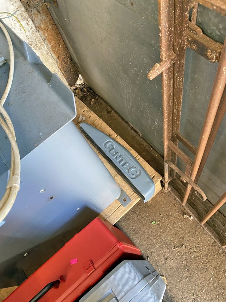

          It would be a great buy for somebody, it has the name Centec on it so probably not Senior.

            Can I ask politely about which auction house this is? That's a Centec 2A with a mk3 vertical head, unless I am mistaken?

                The vertical head for the Centec would likely be rather more, at auction on Epay. They are not so common and are much sought after.

                  The Center is a lovely machine for light work. The one O used tended to run very warm but we were running it for 10 hours a day.
                  The spindle tapers are 2 morse and it has the horizontal overarm and original belt guard. Not sure about arbor support.
                  well worth £1,00 +.

                    Looks like it could be a proper swivelling Boxford shaper vice on the table, these are very rare and were only supplied on the machines with a swivelling table. I put one on ebay a few years ago and the bidding went mad, went for almost the price of this mill!

                        Absolute bargain, looks like it is a Centec 2b with mk3 vertical head. I have the same head on my 2A:
                        Funny enough I also have a Tom Senior, similar but different:

                          Posted by Rannsachair on 07/05/2022 08:38:46:
                          Looks like it is a 2B (with the vertical hand-wheel swivelled round by 90 degrees and no holding bolts fitted).
                          The Horizontal arm lies behind the mill, on the floor. There could very well be a horizontal arbor in that box, adjacent to the motor.
                          I would say well worth a grand, if in good condition – and it certainly looks to be in good condition.

                            Looks work in progress project, table doesn't look long enough for a 2B, motor mount's fabricated, belt drive isn't using gearbox, column, knee and saddle 2B
