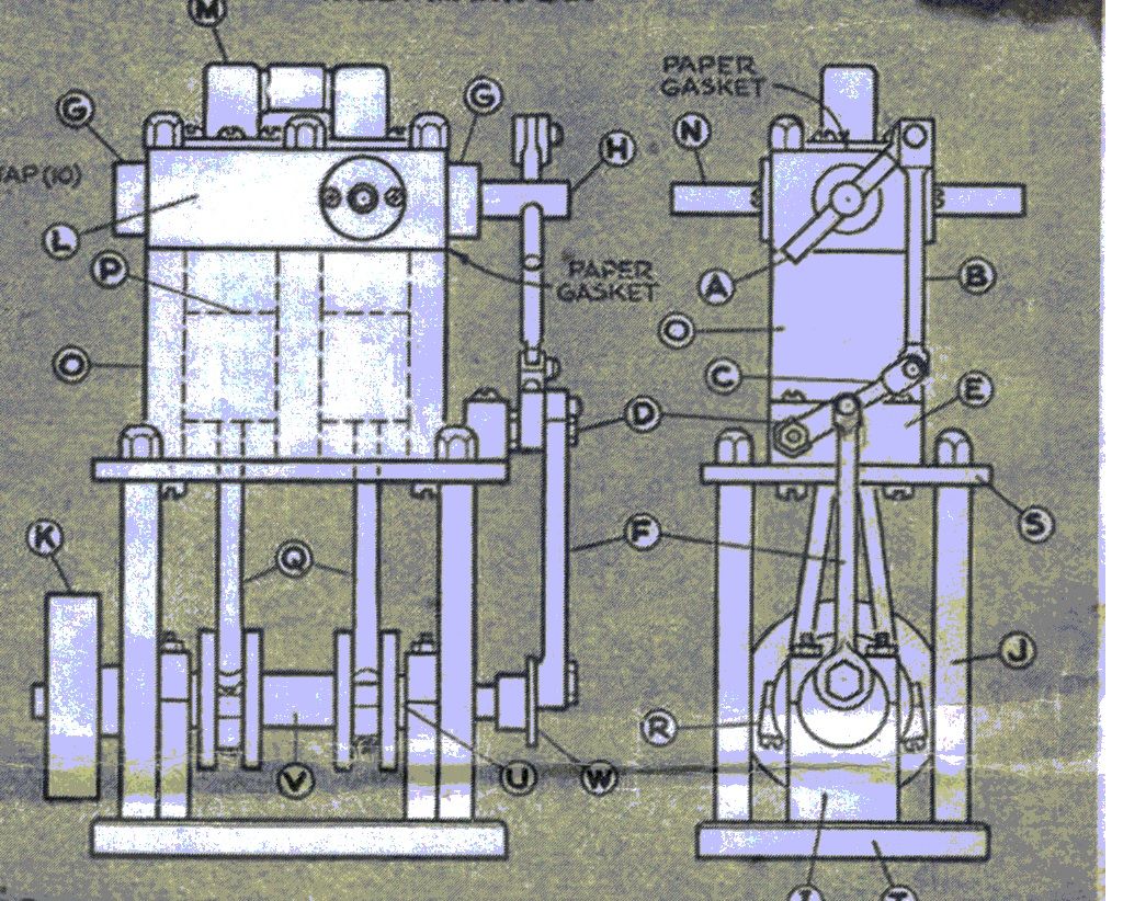

        I recently purchased a small marine engine with 2 x 5/8" single acting pistons with 11/16" stroke. The cranks are at 180 degrees so that when one piston is at tdc the other is at bdc. The motor turns over quite sweetly with low pressure air. If the air is turned off then on again it will sometimes self start……probably about 25% of the time, but as the engine is destined for a boat it will be mighty inconvenient if the engine stalls midstream in the river.
        Other than remaking the crankshaft and setting the cranks at say 90 degrees are there any other simple wheezes to promote self starting.

          On holiday in France many years ago I bought a French-language model boating magazine, it included a design for a steam engine that had exactly this design fault. A double acting steam engine with a 180 degree crankshaft is virtually pointless (aside from reducing vibration compared to a single cylinder design).
          The good thing is that a new crankshaft shoudl transform the engine, giving smoother power and needing a much smaller flywheel as well as becoming self starting.

            Wouldn't a single acting twin with a 90deg crank still have a dead spot? There would be a point where both cylinders were on the exhaust stroke so won't start.

              single acting 90 degree twin would be worse than 180. Little you can do except adding an electric starter motor driving through a sprag clutch, but that might be getting silly.

                You can add a cam and light spring perhaps acting through a roller that prevents it stopping at dead centre. It doesn't have to be a strong spring that moves it when it is stationary just a light bias that discourages the two end positions.

                                    I have been playing with it this morning and I have found that I can get 100% self starting on very little air (5-10psi) if I position No.1 cylinder at approximately 45 deg. after tdc. I can find no other position which will give me repeatable results. Perhaps a small cam….such as a round headed rivet….on the flywheel circumference with a light spring loaded plunger playing on the flywheel circumference might encourage it to stop in the required position. Would this be the basis of the idea that Bazyle refers to? Experiments continue.

                                      Basically add a disc to the end of the crankshaft with a shallow recess in its edge. Then arrange a spring and plunger with a rounded end to match the one in the disc. Set the disc so that the plunger is in its recess at the point where the engine self starts the best.
                                      With luck when you come to stop the ending the crank will carry on rotating until the plunger engages with the recess and will then hold the engine at the correct position so that it self starts next time.

                                        I think Jason's idea which is almost the opposite of mine is the best, Getting it to stop in the best position exactly rather than just discouraged it from bad positions.
