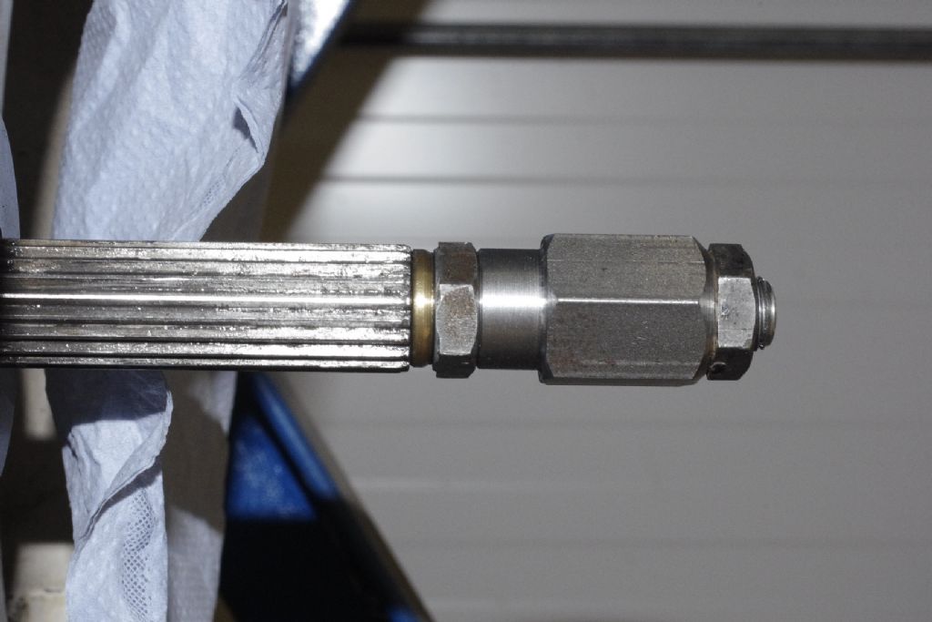

      _igp2476.jpgI happened to notice messages and when I looked at them, one was asking how I went about making a captive self extracting drawbar for a mill. Now I have read it, the message has disappeared and the name of the sender has vanished. So I thought I had better explain how I went about this modification.
      Not all vertical mills will be suitable to fit a captive drawbar to. I was lucky because there was space inside the spindle to fit a nut close to the lower end of the drawbar and also not foul the tooling.Some measuring will be necessary before any work is carried out. I cut the thread on the 7/16" en19T drawbar blank on the lathe, and put about 2 1/2" on either end. I made the bronze nut (in black) long enough to Loctite securely with a flange thick enough to not be in any danger of breaking off. At the top end, I used two half nuts for locking and a piece of threaded hexagon bar large enough to ensure that the upper locknut didn't foul the ring spanner that tightened and released the tooling. I was lucky to find a stub ring spanner with a handle of just 6" long, which is plenty. Due to the design of the mill, I had to put spanner flats on the bottom of the spindle, as there was no lock,or any way to hold it. With a minimum endfloat on the drawbar, it breaks the taper in 1/4 turn._igp2436.jpg

                I did this with the R8 conversion of the Tom Senior light vertical. R8 tapers were designed for mills with drawbars and it is easy to break the taper. The MT3 taper requires more force and I wonder if a bronze taper breaking nut would be the answer, assuming yours is steel. The one I made (shown in black in the drawing) is bronze. Also I used some moly grease when fitting the spindle.

                            Hi, Old Mart…..I do not fully understand how you did exactly the following…
                            I bought a steel threaded bar from farm workshop 16mm same thread as original toolbar(I determined the olenght to accommodate all, hacksaw it off). At the top I added a long nut and lock it with a short nut just like you, in my case those go down in the spindle hole no problem. However I can only insert the bar from the top, its too long from the bottom, so if I want to copy what you did, I must hacksaw a short piece of drawbar, screw Bronze Nut on it, then position it with loctite into the spindle, then unscrew that, and screw the drawbar from the top.
                            1-Where exactly you cut the threads blank…I am not sure how you exactly went about this…
                            —-In my case I think I dont need to cut threads blank…….? Its 16mm right through.
                            2-I assume your drawbar screw from the top through the Bronze Nut with a space as indicated into the in my case MT4 tool and you can tighten lock it as usual. If you unscrew the drawbar the pressure is in the treads of the Bronze nut forcing out the MT4 tool in my case….?
                            Thankyou
                            Chris
                            Qwote:
                            I cut the thread on the 7/16" -(11.11mm)-en 19T drawbar blank on the lathe, and put about 2 1/2" -(50.8mm)-on either end.

                              With the Tom Senior light vertical it is just possible to lower the knee far enough to fit the drawbar from the bottom without swinging the head. It would be a problem if the drawbar couldn't be fitted that end of the spindle as that nut inside has to be loctited so it cannot slip when it is used for breaking the taper. Removing the bed might give enough clearance, or even the Y axis part. Otherwise the head would have to come off. It can be done if you are determined enough and sure that the mill can be reassembled ok. Another way would be to remove the quill if there is one.

                                Hi OLd Mart, it seems the part I dont understand correctly is how you assemble your new Drawbar with the Brass Nut, and if the threads in Brass Nut is different than the rest of the drawbar not like in my case the threads in the MT4 section you draw into the MT4 of the spindle.
                                Your Drawbar….
                                Threads for taper tool……small space….threads for Brass Nut(Now glued in spindle pocket)…….rest of drawbar through spindle……Top of Drawbar ……Nuts plus Long Nut.
                                If its the same, I may make the Brass Like part and use a short temporary bar screw it on, and insert/glue it to spindle small pocket…………
                                If I can understand how exactly your drawbar components/threads arranged on it, I can figure out if it will work in my situation……There is no way I can insert it from the bottom at the required lenght without removing parts of the mill, however if I can use a temp short bar with screwed on Brass Nut, I can insert and glue it that way-??

                                  The nut is made from bronze, and the lower end of the drawbar has whatever threads are appropriate for the tooling. These threads extend as far as the nut needs to be screwed onto the drawbar. After degreasing the threads on both parts, I used Loctite 620 as a thread locker, even though it is intended as a sleeve and bearing fit. This is because it is very slow curing and the length of the nut can cause slight friction which makes most other grades such as 270 threadlocker harden before the nut is in its final position.
                                  If there was enough size of cavity to fit a long nut with sufficient wall thickness, then top and bottom parts of the drawbar could be loctited into the nut. You mentioned boring the spindle, but that would involve much more dismantling than just making room for inserting the drawbar from the bottom.
                                  The nut has to rotate with the drawbar, it is not glued into the spindle.
