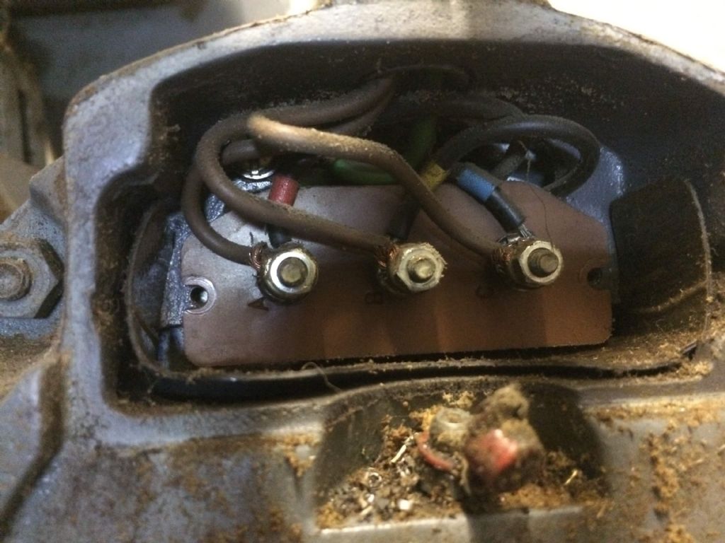

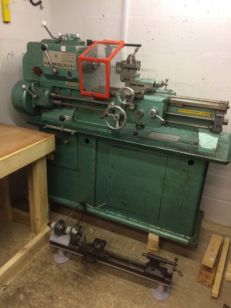

                      Ib0491285-d863-4565-9f52-aa3a781ee3b7.jpeg82240fec-d636-43d7-a670-b291996d0b1b.jpegThank you all for your advice, I’ve done a little reading around delta and star configurations and the motor wiring doesn’t look like either! I’ve tried to add a few pictures, one of the terminals on the back of the motor, one of a sticker inside the motor casing and one of the new lathe (with my previous lathe in front!) From looking online the lathe looks much more like a Harrison L5 than a 140, not too sure about that 2a027698-6f3c-456a-97eb-4011314b5c27.jpeg

                        The lathe is wired star and the star point is inside the motor. Unless that star point can be broken and new leads brought out to those connections, it will require a 230 to 415 inverter. Likely cheaper to fit a new motor wired delta and buy a far cheaper 230V output VFD.
                        The pillar drill can be changed to delta, by changing bridging strips, if wired star. It could then be run from a 230V output VFD.

                          Your lathe looks to be a 140 and not an L5 , while the bed and carriage are similar looking between the two machines the headstock on a 140 is a different shape, ive got an L5 btw.
                          regards Geoff

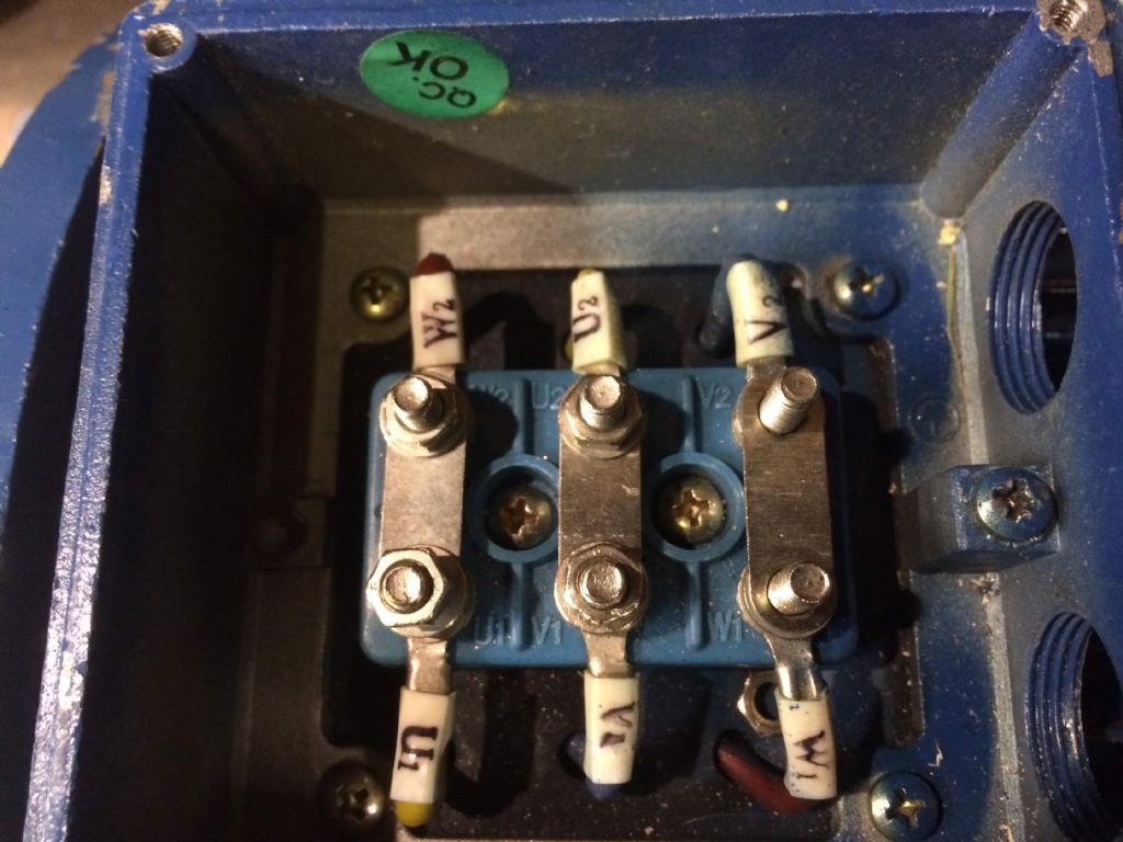

                                          Two months on and I’m still not there with this lathe!
                                          Since the last post I have bought a 2.2kw (3hp) VFD which incorrectly claimed to increase the voltage to 380v. I then bought a single phase 2hp motor, but it vibrated so much on the bench tools fell off the wall! Yesterday I collected a 3hp, 3 phase motor with the view to use it with the VFD. Unfortunately when connected tthe VFD it turns a couple of revolutions then spits out an Error 1 code (short circuit / current overload)
                                          I checked the resistance between U1-U2, V1-V2 and W1-W2 and they were all between 2.1 and 2.4 ohms. There was no connection between U,V or W or to the casing. Any thoughts on what could be happening?
                                          When I went to view we weren’t able to get the motor running using a 220v supply and capacitor, or by connecting U to Live and V and W to Neutral without the capacitor, because of this the chap I was buying from gave it to me for free, so I’m not too concerned about opening it up if necessary. Below is the current configuration of the bridging bars

                                            Looks like it's delta connected as it needs to be. The winding resistances are really irrelevant except that they all about the same and there isn't a short to the frame. The current is determined by the winding inductance, not DC resistance. Quite possibly the current limit on the VFD is being triggered by the startup inrush of the motor, it would need properly configuring to set this up. Looks like a good find for free!
                                            #389337
                                            Pete Rimmer
                                              @peterimmer30576
                                              It's very unlikely that there's a fault in that motor. You probably need to alter some parameters in the VFD. Do you have a link to the online manual?
