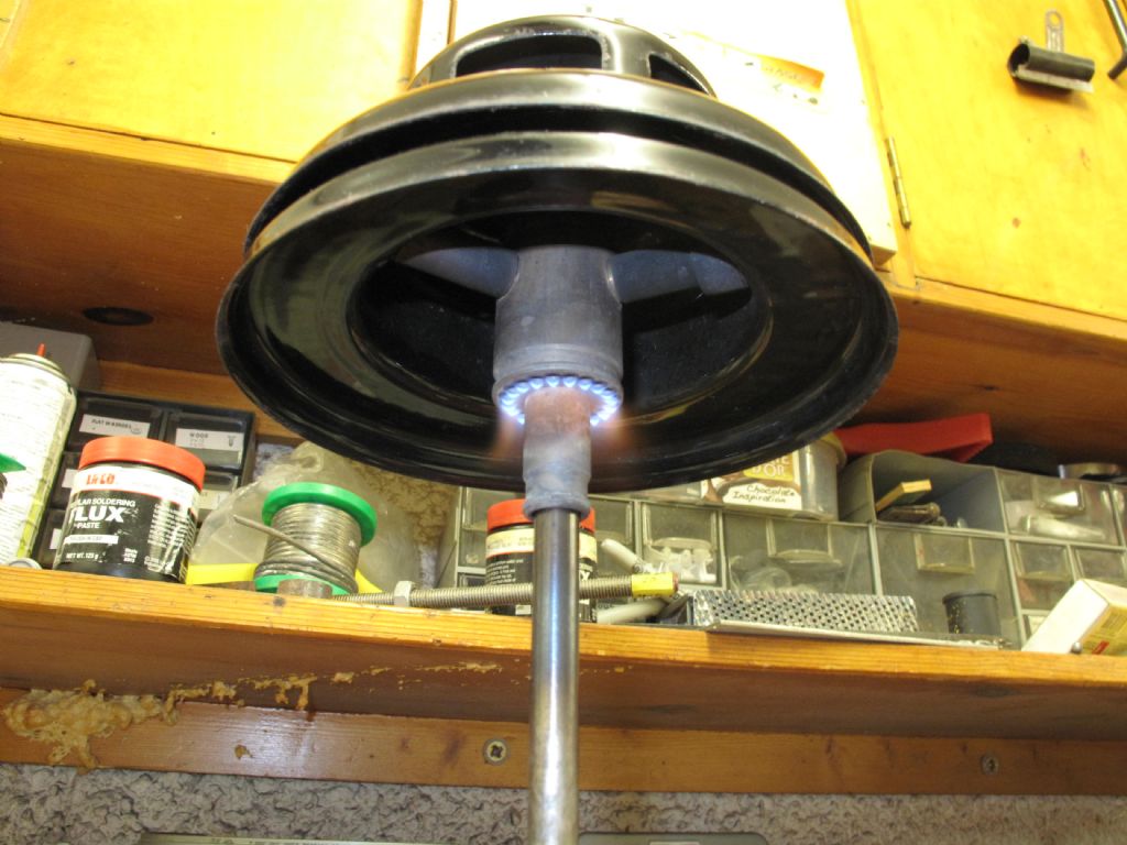

                  Tried all the above thanks guys. I think gripping the shaft with a pair of plumbers grips and a piece of rubber tube worked wonders without marking the metal.
                  Heres a pic of the burner in action:
