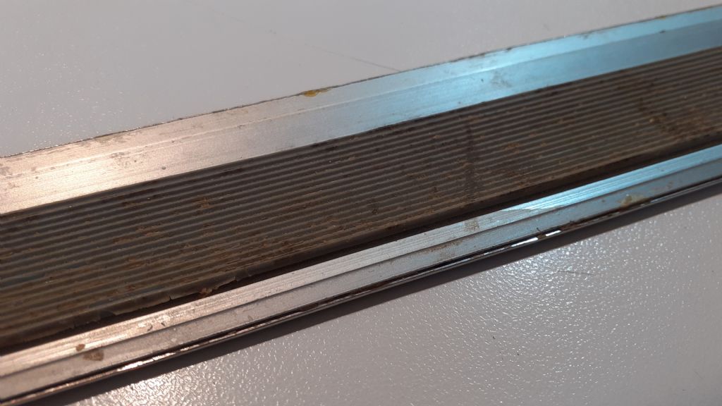

                            Art shops tend to sell the ones with rubber on the backs, failing that just stick your own onto one that meets the other criteria.
                            Personally I'd use one rule to mark out and then a separate straightedge to cut against.
                            Better still use a rule designed for cutting with mm along one edge and an inset stainless strip on the other for cutting against and a ribbed rubber insert on the bottom so it does not slip. They are also about 40mm wide so you don't slice off the end of an overlapping finger.

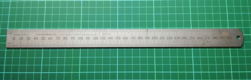

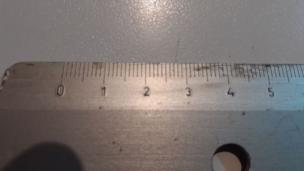

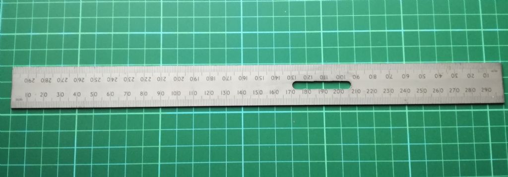

                            Nicholas Farr
                              @nicholasfarr14254
                              Hi, here's two that I have, but they are not new, I got them at one of the model engineering exhibitions and were on the Home and Workshop Machinery stand. This first one has just mm divisions on one side (shown) and half mm divisions on the other side and is; No. 49R BS4372 and was probably made by Rabone Chesterman.
                              This second one has just mm divisions on one side and is plain on the other side, this is a Rabone Chesterman; No. 47R BS4372, and this is my preferred type for most measuring/marking out jobs.
                              Regards Nick.
                              #591038
                                This is the one I mentioned, clear 1mm divisions though only in one direction. Not sure if there is a real need for both directions, I measure and mark out 100s of sizes a day with a tape measure and that only runs in one direction.
                                Back has rubber strip so it does not slide and you can just see the inset cutting edge
                                make has worn off due to use but put non slip cutting rule into google and there are plenty of options
