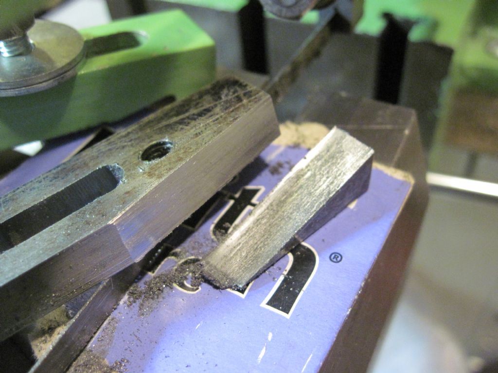

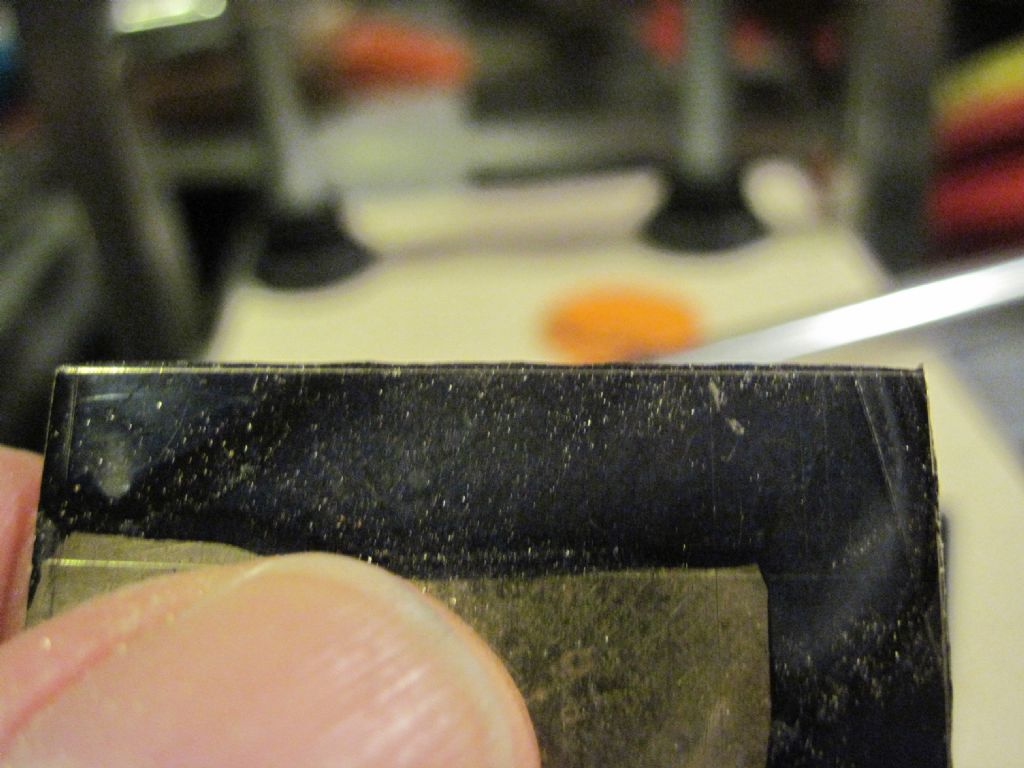

                                                #399754
                                                IanT
                                                  @iant
                                                  Yes, mild steel is harder (and slower) to cut Bob – especially when it's quite thick..
                                                  I've generally never been able to file/saw straight I'm afraid – but even I can get fairly good results 'freehand' with a piecing saw in brass. Provided you don't force it, it's quite easy to guide the cut. This is 2mm brass and I'm about 0.5mm above that line. All I then had to do was line a toolmakers clamp up with the scribed line, lay it in the shaper vice, remove the clamp and a few strokes later I had a nice edge to final dimension.
                                                  Piercing Saw cuts in 2mm brass
                                                  However for thicker material, it's much harder to do I agree – so for small straight cuts, I use the shaper to guide a Junior hacksaw blade – which works well – although of course it's not an option for most folk. I've recently made a new 'finger' for my finger plate (thought the "temporary" one I made some 10-12 years ago should finally be replaced with something a bit prettier). It's 3/8ths thick mild steel and using a hand saw I would have been all over the place. Doing it this way, it cleaned up quickly (and to size) – which probably would not have been the case otherwise!.
                                                  Shaper saw in mild steel
