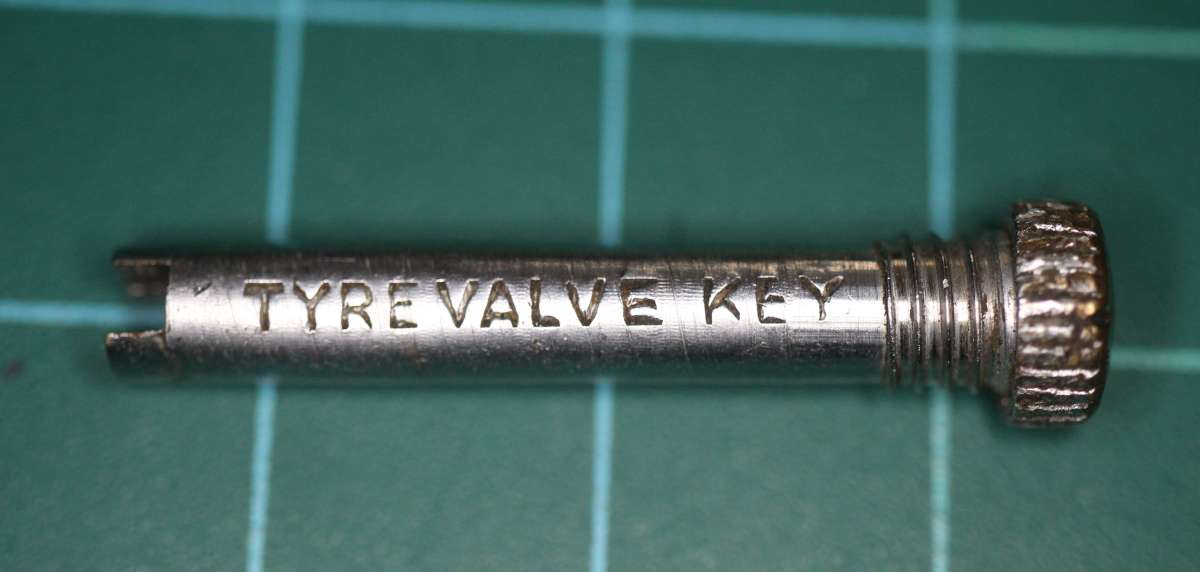

      So I have three old style chrome telescopic tyre pessure guages, marked Dunlop etc. They are all missing the screw in valve core extractor so I idly wondered if I could make some replacements (can’t find any for sale online)
      Measure thread that screws it into the body of the tool – seems to be ~7/32″ or 5.2 mm OD and 4.5mm internal, and thread gauge says 26tpi – what is this then? I thought perhaps cycle but a very odd size if it is and rummaging througgh drawers I can’t find a die to match.
      It’s _not_ the same thread as the valve cores themselves.
      Not important but if anyone does know please speak up, or indeed knows if they are available somewhere.

            Assuming your measurements are accurate – 7/32″ x 26 tpi is BSC (cycle) standard thread.  Tracy Tools sell the taps and dies to produce such an animal, here,
            Whether they are value or not is for you to decide.

              Hi Adrian R2, if you mean the tyre valve key, I have a Dunlop No.2 pressure gauge, and the thread that holds it into the telescoping part, has a pitch of 0.8mm, but it’s not what you would call a full form thread of any sort, but more like a piece of wire, and at best only about 3.5mm long, and an O/D of about 4.6mm.
              Tyre Valve Key
              Click on the photo for a larger view.
              Regards Nick.

                  Not sure whether you need a tool to remove valve cores or a replacement to fit your pressure gauge ? If the former then it’s easy, Take a piece of small steel round, 4.3 OD drill a 2.5 hole down the middle then cut the slot 2mm wide and 2.5 deep. For the latter others have the answer. Noel.

                        Why does the replacement have to be threaded? You could machine a small groove where the thread would have been, and use an O-ring to retain the part.
                        I’ve made a number of valve keys, including one from 1/4″ hex to fit in a ratchet screwdriver and others with a knurled grip for use on small wheels where there wasn’t space for a longer tool.

                          @John, yes 7/32 BSC that is the best candidate but when you drill [!] down Tracy don’t actually have the die listed. RDG do one but I was looking to confirm my assumption as it’s not a common size and perhaps something else would do.
                          @Old Mart indeed, I’m reasonably confident of the 26TPI using various thread gauges in go/no go mode, less of the diameter.
                          @Nick – good suggestion, I suspect even a small piece of PVC cable insulation might work as it doesn’t have to hold anything other than itself.
