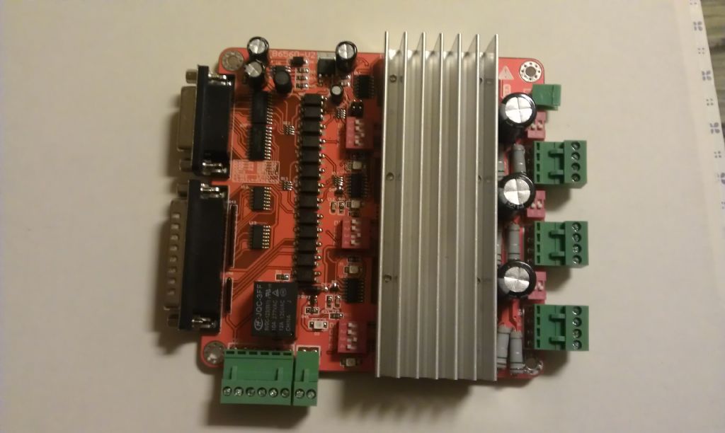

      Hi
      Have come across a stepper motor driver cards, TB6560-V2, a red card.
      I need now is a schedule on the coupling of motors, PC and hand control.
      Have searched on Google but only found diagrams of the blue card.
      Is there anyone here who has a schedule?

        John Stevenson 1
          @johnstevenson1
          Bertil,
          Sorry but saying red card is not specif enought.
          There are two cards out there, both with the TB6560 chips on and both red.
          One has just a single parallel port socket and one has the parallel port socket with a serial port to the side of it.
          Both red but both different animals. Any chance of a picture or link ?
          If you haven't bought this then a word of warning to only operate these at 20 to 24 volts MAX as they easily burn out. they are not the best cards on the market.

          Svarven
            @svarven
            This is the controller card.
            TB6560 controller

              John Stevenson 1
                @johnstevenson1
                OK, Mine came with a CD with the wiring on it.
                need to look it out tomorrow.

                              John Stevenson 1
                                @johnstevenson1
                                Yes, can't find it but looking inside the tiny drag engraver it's fitted to it's not a red board anyway.
                                Have you tried emailing the seller of the red board on ebay for a manual, they usually will give you a link prior to purchase

                                  Olaf
                                    @olaf
                                    Hello,
                                    i do own the same red Controller card TB6560 V2 as on the picture from Svarven. And i do need some more information too (DIP Switches, PINOUT).
                                    Do anyone hase any further Informations about the board?
                                    Thanks in Advance!
                                    Greetings
                                    Olaf

                                    Olaf
                                      @olaf
                                      I the meantime i have got some more Informations.
                                      FYI
                                      Control signal interface
                                      PIN Func Explain
                                      1 EN Enable control signal
                                      2 STEPX X Pulse signal
                                      3 DIRX X Direction signal
                                      4 STEPY Y Pulse signal
                                      5 DIRY Y Direction signal
                                      6 STEPZ Z Pulse signal
                                      7 DIRZ Z Direction signal 18-25 GND GND
                                      10 L1 Input limit interface 1
                                      11 L2 Input limit interface 2
                                      12 L3 Input limit interface 3
                                      13 L4 Input limit interface 4
                                      14 RLY Relay control signal
                                      15 L5 Input limit interface 5
                                      18 GND GND
                                      19 GND GND
                                      20 GND GND
                                      21 GND GND
                                      22 GND GND
                                      23 GND GND
                                      24 GND GND
                                      25 GND GND
                                      The drive using six DIP switch to setting current, segments, decay Mode
                                      The current is better to closed to the motor rated current.
                                      T1 T2 current
                                      ON ON 20%*3.5A
                                      OFF ON 50%*3.5A
                                      ON OFF 75%*3.5A
                                      OFF OFF 100%*3.5A
                                      Segments Settings
                                      When M1 = off, M2 = off, drive segments number is 1,1.8 ? step angle motor turning circle, the whole step = 200 steps / rev. When M1= OFF, S4 = ON,1.8 ? step angle motor turning circle, the whole step = 3200 steps / rev.
                                      M1 M2 Segments
                                      ON ON 1/8
                                      OFF ON 1/16
                                      ON OFF 1/2
                                      OFF OFF 1
                                      Decay Mode
                                      Rapid decay is better when motor has a high speed.
                                      D1 D2 Decay Mode
                                      ON ON Rapid decay
                                      OFF ON 50%Rapid decay
                                      ON OFF 25%Rapid decay
                                      OFF OFF Slow decay

                                      Royston
                                        @royston
                                        Hi
                                        This is my first post but my be of help.
                                        I have the same card, I am running mach3 on XP, my pin/port settings are:-
                                        Motor output
                                        X axis, enabled, step pin 2, dir pin 3, dir low x, step low y.
                                        y axis, enabled, step pin 4, dir pin 5, dir low x, step low y.
                                        z axis, enabled, step pin 6, dir pin 7, dir low x, sep low y.
                                        Card dip settings :-
                                        All three axis are the same
                                        D1 on
                                        D2 on
                                        M1 on
                                        M2 on
                                        T1 on
                                        T2 off
                                        The three motors work ok.
                                        I need help with the relay output. The relay light comes on with some settings when Mach3 is 'Reset' and goes out with other settings but I am unable to get any output from the terminals.
