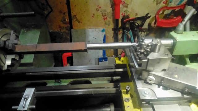

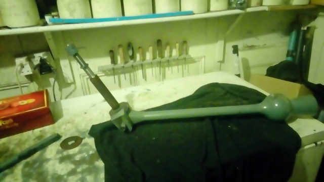

                      Nick Wheeler
                        @nickwheeler
                        Posted by Bazyle on 07/02/2022 20:41:31:
                        You will be screwcutting in back gear so it is pretty slow anyway. However it is also a good idea anyway to make a mandrel handle so you can go even slower and provide rapid braking if necessary. Also reverse can then be applied quite quickly but remember to withdraw the tool first.
                        my WM250 doesn't have back gear, and so far hasn't needed it.
                        I tend to screwcut larger threads that aren't worth buying tap and dies for, or that would be too much work. This
                        is a new headstock bolt for a 200kg bell, that needed M20 threads on each end. The end you can see there needs about 100mm of thread, so doing it efficiently was important: I cut it at about 120rpm and 0.2 DOC for all but the last spring passes. The test piece I did was more like 200rpm, but I didn't have enough material to remake the job if I screwed up.
                        Here's the rest of the parts
                        that have been in use for over two years; my bolt has a relief at the end of each thread unlike the original die cut one that failed noisily…
