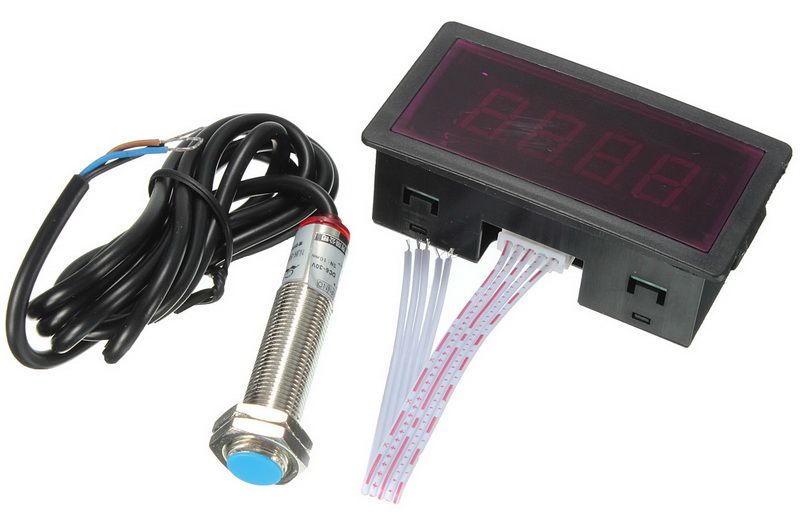

      Has anyone here fitted one of these tachos to one of their machines? I received onelathetach1.jpg recently, but the connections on the display are labelled in Chinese and the seller isn't being very helpful.

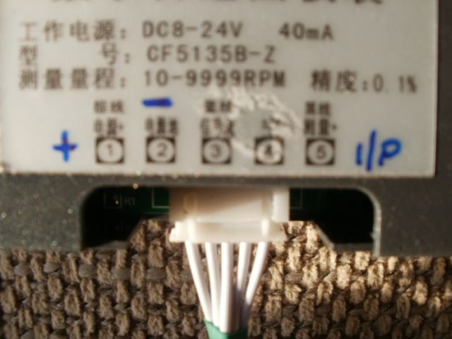

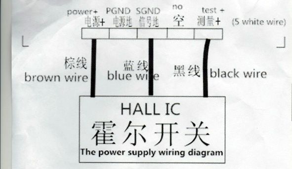

          Gordon
          Have a look here…..http://www.ebay.co.uk/itm/Red-LED-Tachometer-RPM-Speed-Meter-with-Proximity-Switch-Sensor-NPN-UK-SELLER-/181892033370?hash=item2a599c2b5a
          Looking at the rear of the tacho,(pcb side) the white connector numbered 1-5 left to right…
          1) 12v dc positive supply
          2) 12v dc ground
          3) Signal input
          4) No connection
          5) Test +
          the probe wires connect:
          Brown-terminal1
          Blue- terminal 3
          Black- terminal 5
          Info offered on an as is basis, no responsibilty for blowing it up…wink
          Hope this helps…..

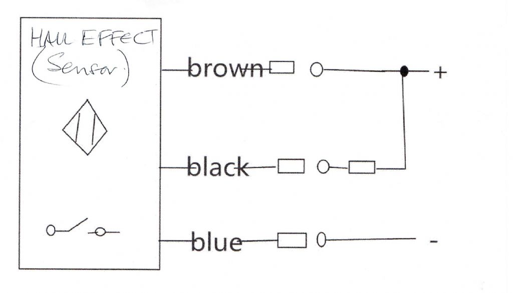

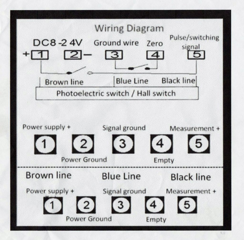

            I too purchased one of these Tacho's and it came with no wiring info.
            After pressing the vendor eventually received this comprehensive diagram.
            Thinking that this was less than useless I pressed them again and received the next bit of info as under.
            I thought now this is much better and decided to take up a course as a Chinese interpreter before pressing them again.
            I subsequently received the diagram as under together with a pleading request from the vendor to leave them "positive feedback"
            Well this enabled me to wire up in a fashion after interpreting what I thought they meant and guess what, it didn't work.
            Any helpful suggestions would be appreciated apart from dumping it !!!

            #211951
            ianj
              @ians
              Gordon.
              Just by coincidence I received one of these this morning from Hong Kong. Spent some time trying to work out the wiring , with no luck. When I came in for lunch I saw John's reply. When I wired mine up as John's ( Apart from I think he meant BLUE OF THE SENSOR TO TERMINAL 2 Ve Gnd ) info. it worked o/k.
              Terminal 1 +ve to display and sensor (brown)
              Terminal 2 -ve to display and sensor (blue)
              Terminal 5 input from sensor (black)
              Terminal 3 & 4 not used
              That's how it is on mine.
              PS just checked Terminal 2 & 3 on mine are communed together so are both -Ve in. So John's info is correct.
              Ian

              Gordon Tarling
                @gordontarling37126
                Thanks for the help chaps. I'm pleased to say that John's connections appear to work – the display is live, there's a small red light visible in the back of the sensor and waving a magnet about in front of the sensor produces some numbers on the display. I now need to find a way to fix the magnet on the shaft in the lathe and fit all the other bits in place.

                    #211970
                    EdH
                      @edh
                      Interesting to see that there is another way to wire it up than the one I used.
                      I got some info from here:
                      **LINK**
                      (note spelling mistake so cut & paste)
                      and some more from here:
                      **LINK**
                      The wiring is marked on the PCB. With the connector on the bottom, the 5 pins are left to right
                      1 2 3 4 5
                      [Sensor Power +5V] [Sensor O/P] [Sensor GND] [Supply +12V] [Supply GND]
                      Ignore the dot, dashes and plus signs on the cable as they are different on all the ones I’ve seen.
                      My version is :
                      1 2 3 4 5
                      Sensor O/P not used not used Supply +12VDC Supply GND
                      This may be wrong as there is a small plus sign on the right of the characters on pins 1 & 5 or is that part of the character? Anyway mine work ok.
                      On the 5002C Hall Effect Proximity Detector I also have two wiring versions from the small label on them, one shows
                      a pull-up resistor to positive and the other to negative, I used a 220 Ohm resistor to positive.
                      I am using a Regulated 12VDC 0.5A power adaptor .
                      The Sensor is polarity conscious so get the magnet the right way round. I have used a bigger countersunk magnet on the Myford and screwed it on the pulley in one of the balancing holes (Oops!) and the one on the VMC Mill just relies on the magnetism as it sits in the recess under the spindle pulley so can’y fly off at speed. There is a screwhead down behind the pulley on the Myford so the magnet and retaining screw need to be slim to miss this.
                      I have put a variable speed setup on my Myford so no longer know what rpm it is running at and needed a way to monitor this so I put the magnet on the pulley inside the casing so this only indicates the direct drive
                      RPM so I will have to do a calculation to show what the direct drive RPM should be when running via the
                      back gears, I couldn’t think of a way to monitor the spindle directly so had to use this method for now.

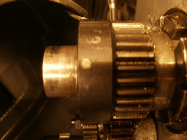

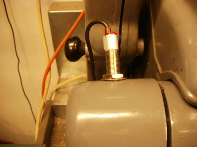

                                          pb151427.jpgJust thought I would show how I mounted the sensor & magnet on my ML7R this morning,

                                            Well well- I got an identical item yesterday and was also puzzled about the connections so all this information is invaluable. I was amazed at the tiny cost of this item, including postage from China, how do they do it and still make a profit?
                                            It is a pity the sensor is as large as it is, making it difficult to fit in the place I had in mind, so I will have to think about that and see if I can find another location to mount it.
