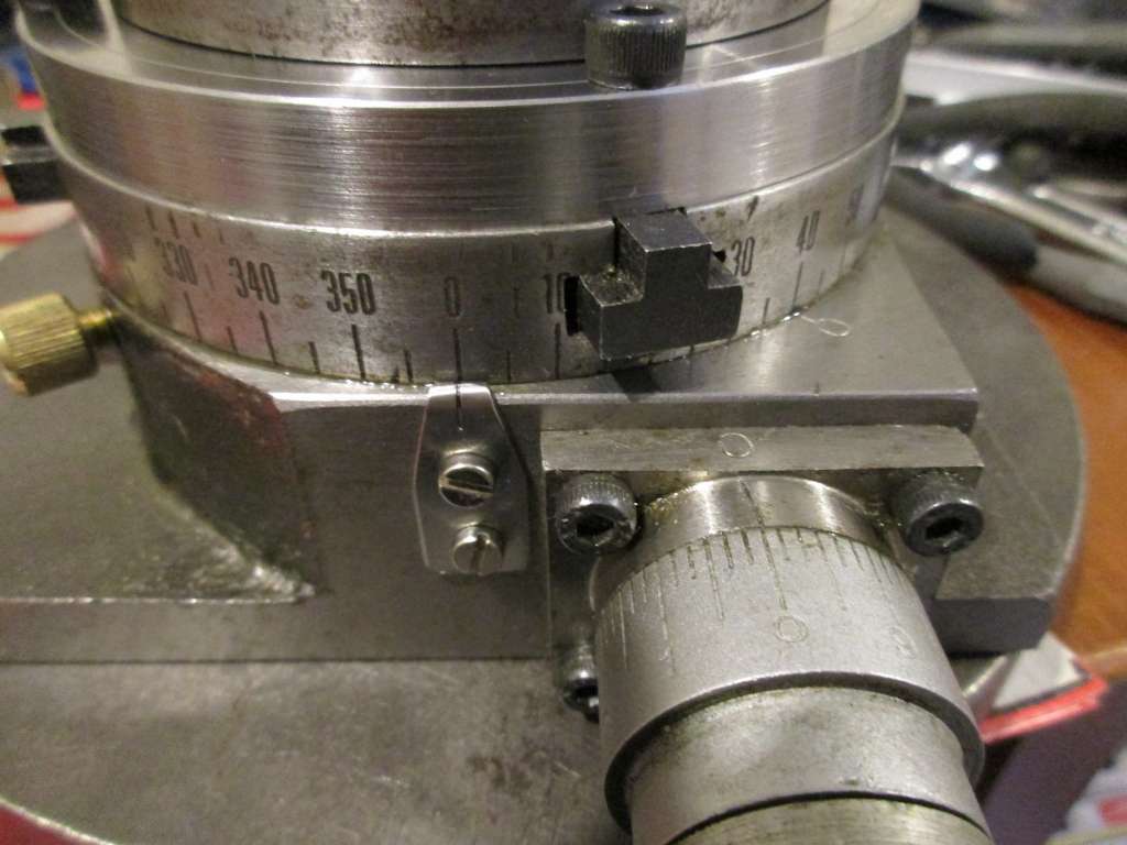

      I have aligned the slots of my rotary table with the x axis of my milling table and find that the pointer on the base of the rotary table is 5 degrees away from the 0 zero mark of rotary table top. Is this normal or is there a way of getting it realigned other than moving the pointer which is riveted on the side of the base casting to line up with the zero mark of the rotary table top?

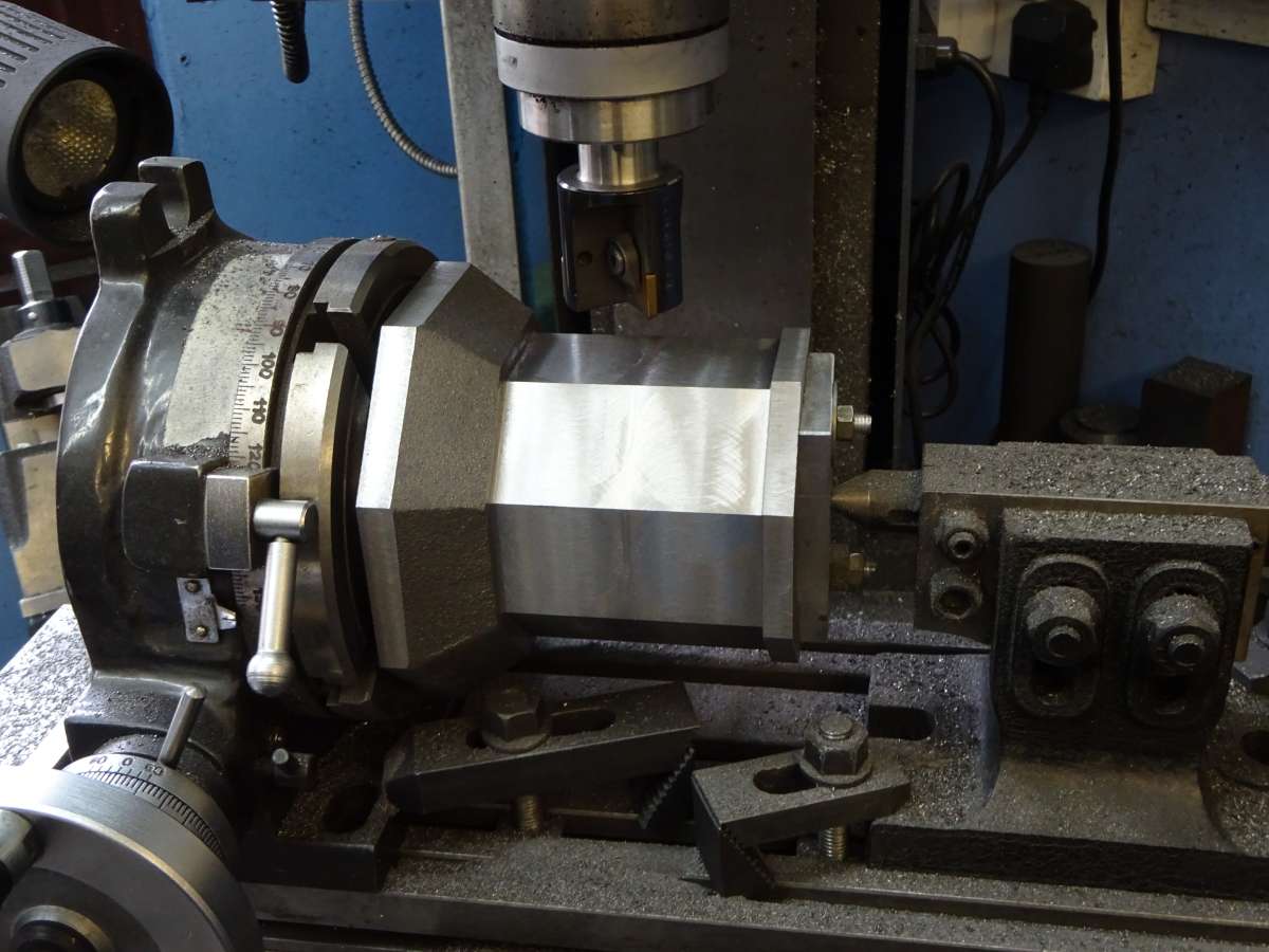

                  Andrews method may not work when using the table vertically unless you put packing under it which is not ideal. Also won’t be able to use tailstock support it it is packed to tilt it.
                  Talking of vertical use at least on my Soba one the mark is not so easy to see when the table is vertical so the bit of tape can be positioned to suit the particular setup.

                  Nicholas Farr
                    @nicholasfarr14254

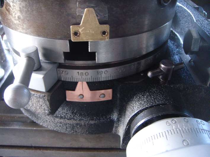

                    Hi, the 0 mark on the base of my 100mm RT isn’t in the best place, and I found it difficult to see what degree mark  was in line with it, so I just made a small tag with a little cut at the top, and fixed it on with a couple of screws, on the same side as the winding handle, which made it easy to see from the front. I wasn’t too fused about where the table slots were aligned, as they are not aligned with the mill table when the 0 mark on the table is in line with the original 0 mark on the base anyway.
                    RT Mod 01
                    If I want the table slots to be inline with the mill table, the original 0 mark on the base will be on about 58 on the table.
                    Regards Nick.

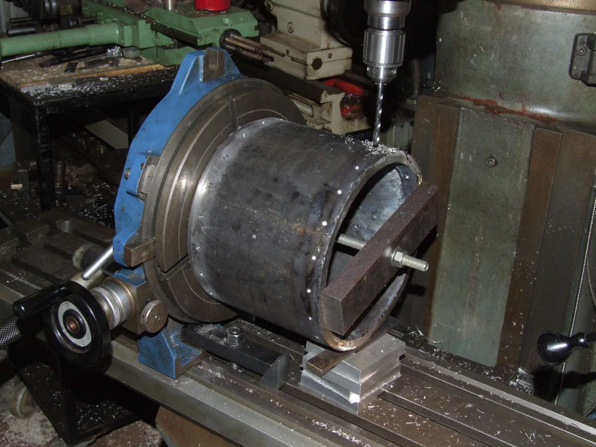

                    Ramon Wilson
                      @ramonwilson3
                      The position of the slots on a rotary table to the mill axis is academic to the use of the rotary table – they are only there to allow clamping of the workpiece which is relative to ‘Zero’
                      Once the table is set to align with the spindle set the table dial to zero. Then set the work piece to the mill axis(s) and work from there.
                      In the image below the slots of the table are not exactly in line to the mill axis but the fixture is being set square to the back of the mill. Some tables have three slots so alignment there is even more irrelevant.
                      Hope that’s of help – Tug DSCF0223

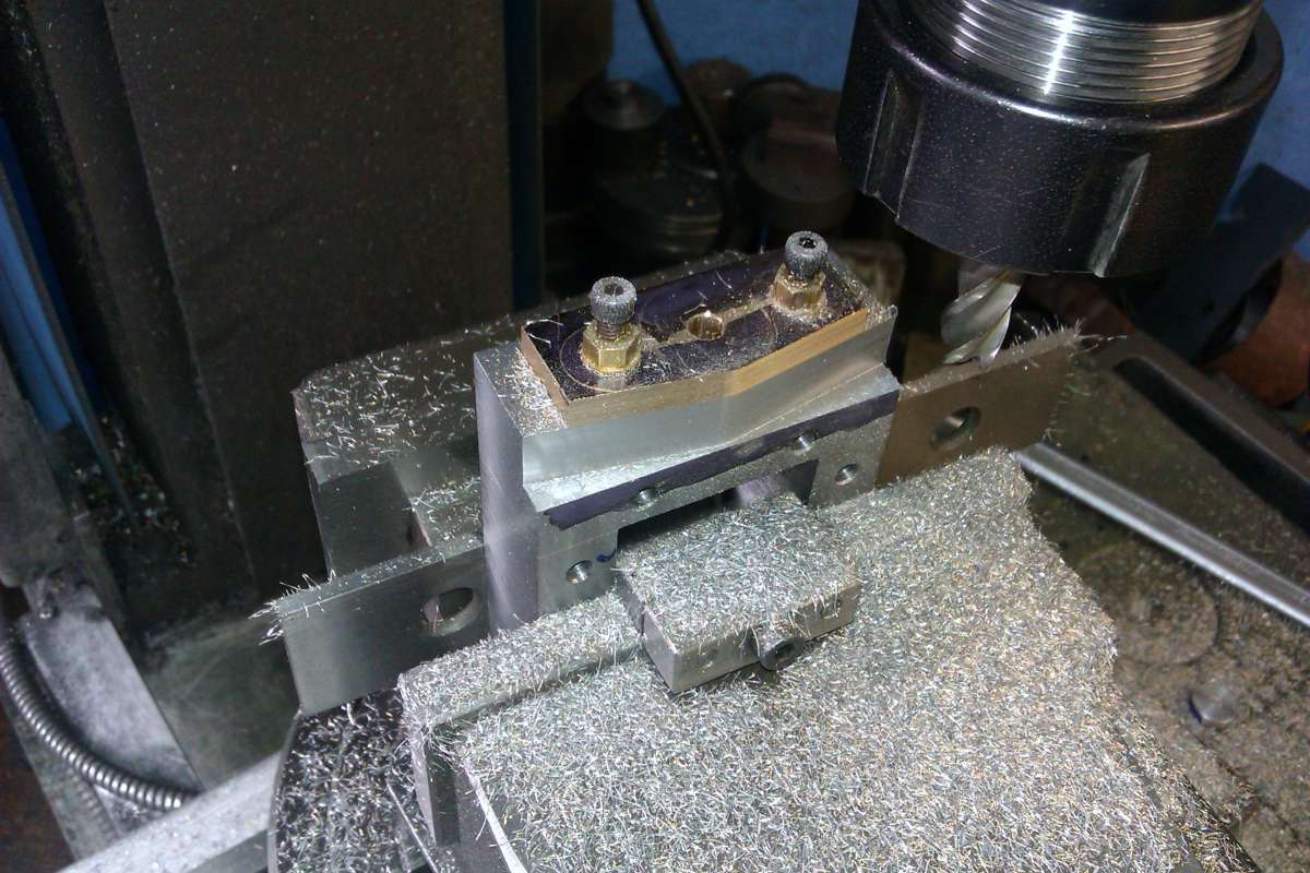

                        Here is another image that may help to confirm the above. The rotary table has a sub plate bolted to it after aligning with the spindle. The workpiece, held in a small vice clamped to the table is then aligned to the spindle and set relative to the X and Y axis – the rotary table slots have no bearing whatsoever.
                        Good Luck with your project – Tug

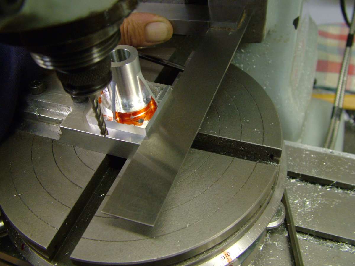

                          When mounting the rotary table vertically I have never needed to align the table slots to any axis. So there is no need for packing. The only important alignment is that the table surface is parallel to the Y-axis.
                          2018_02270010
                          I don’t have a tailstock for the rotary table. As far as I can remember my rotary table doesn’t have any slots on the underside for keys to align with slots in the milling machine table.
                          Andrew

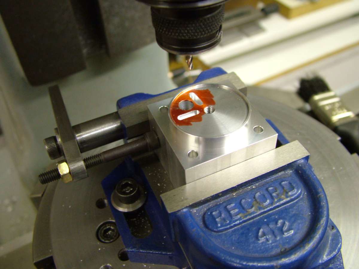

                              The only reason I can see for having the slots in line with an axis is if you have made a specific jig to bolt to it that has the holes in line as trying to make a jig with 5deg offsets would be a PITA.
                              Having a vice on the table would be one reason if you want to machine a part with angled surfaces such a sthis set up 15 deg either side is easier to keep track of if teh vice jaw and therefore table slots all line up with X axis

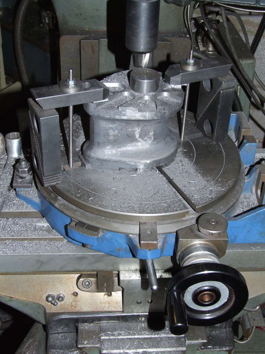

                                  It helps on more advanced work when aligning additional features with existing features on the work. Like this:
                                  2008_09070050
                                  The slots for the spokes on the top side of the hub have a precise angular relationship with the slots on the bottom side. If the rotary table is set at zero, and one table slot aligned with the Y-axis, then a blank T-nut can be used to locate the work such that machining the slots on the top side, at their given angles, ensures that their relationahip to the slots on the bottom side is accurate. The t-nut can just be seen middle left.

                                      Andrew Schofield
                                        @andrewschofield
                                        Rotary table
                                        Many thanks for all your comments, as you can see from the photo above I made a new pointer from a copper pipe to replace the brass one shown and now the slots/markings are aligned to the axis of the milling machine.
                                        I wanted to do this as I had to mill out the 4 slots in the rotary table as they were slightly not wide enough for the T nuts to bolt down the 4 jaw chuck.
