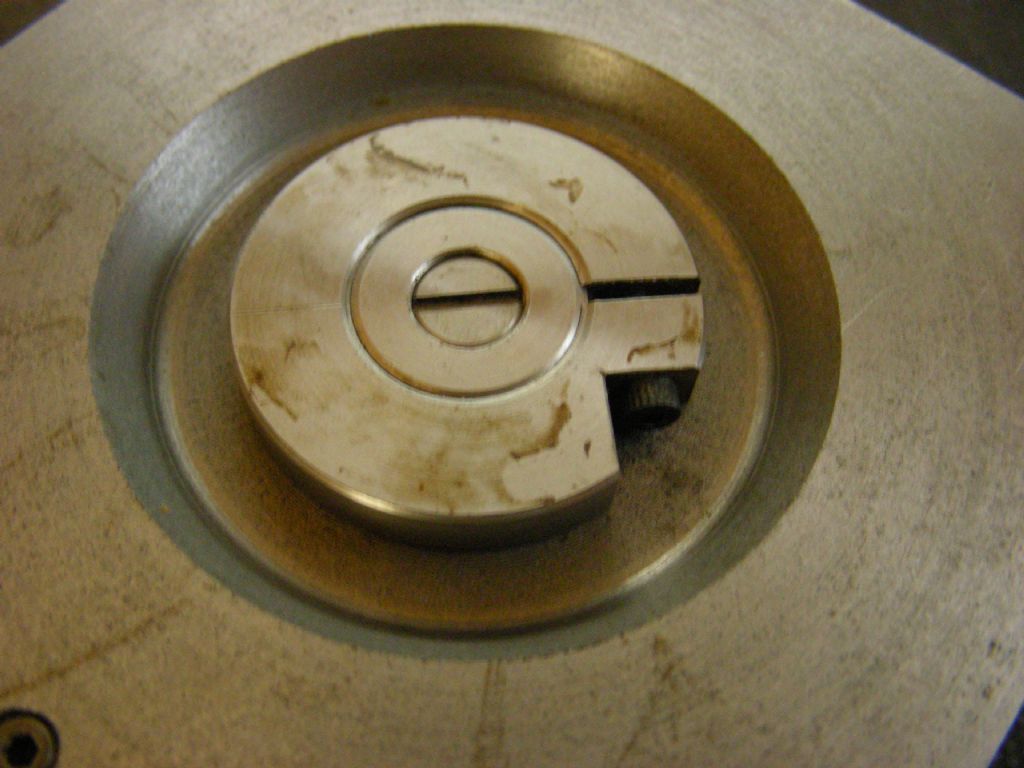

                If you don't fancy Nyloc then GHT showed an elegant design for a mechanically-locked nut in his small rotary table.

                  ega
                    @ega
                    bricky:
                    Sorry I wasn't clear. GHT refers to the late George H Thomas, a prolific contributor to Model Engineer around the 1970s (I don't know what the "H" stood for). Most if not all of his work can also be found in his Model Engineer's Workshop Manual and in his Workshop Techniques, both excellent reads. His Small Rotary Table is in the first of these.
                    Looking again at your second post I realize that you may already have installed a locknut but if you will send me your email address via the website personal message facility I will be happy to let you have further details.
                    #489369
                    ega
                      @ega
                      PS The underside of the GHT small rotab showing locknut construction:
