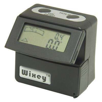

      I have one of the 6″ rotary tables of generic design which can be mounted on edge as a dividing head.
      For various reasons, it would be advantageous for me to have a digital readout for the table angle.
      I had expected to find suitable kits readily available, as they are for linear readouts – but nothing came up in my searches.
      I found a rotary encoder with remote display available, but the encoder is a 37mm high box which would require lifting the rotary table high off the mill bed and reducing available part and tool height capacity.
      So – I had a look around to see what I could adapt. What I found was an inexpensive “digital level / angle finder”, the small box type, with a tilting display – various brands available…
      s-l400

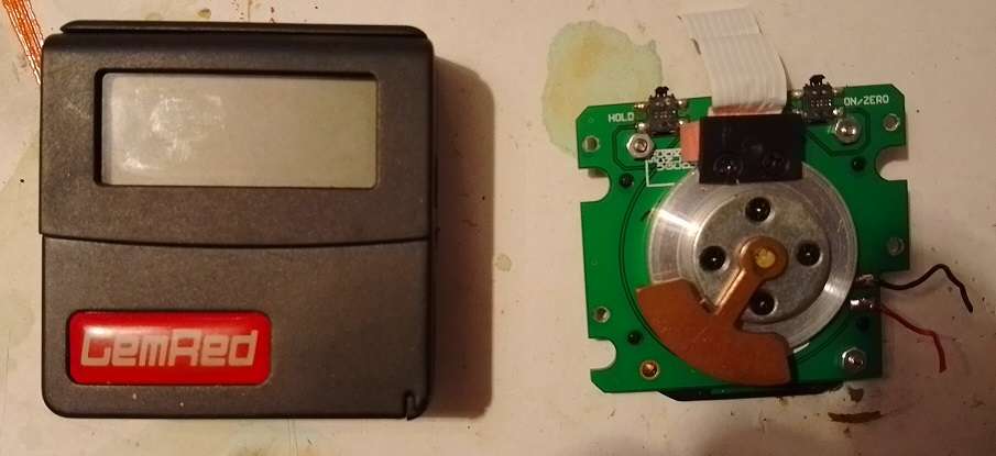

      This was actually something I had for several years, but it never worked correctly after I dropped it. With nothing to lose, I set about dismantling it.
      Inside, the ‘heart’ of the device consists of a pendulum and an inductive encoder mounted on a pair of PCBs.
      The front half of the box houses the two AA batteries and the display, which is connected to the main PCB by a short ribbon cable. In the photo I cave cut the ribbon cable and battery wires to seperate the encoder board out.
      IMG_20250226_201401
      The pendulum is attached to the encoder rotor with an M3 nut (on the back side) and is easily removed.

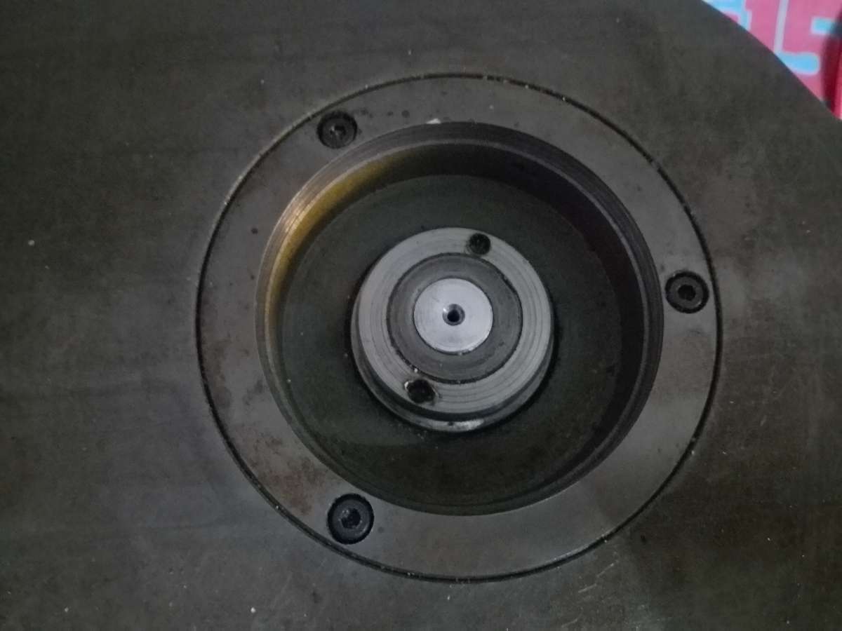

      Mechanical installation to the rotary table requires a simple aluminium ‘slug’ to press into the bottom end of the table’s hollow spindle, with an M3 hole tapped centrally.

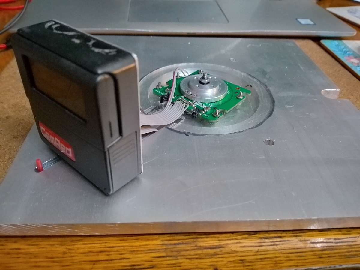

      To mount the PCB I cut a disc from some 2mm rigid plastic sheet (I happened to have some clear sheet, which is exceedingly brittle!). The disc is cut out to clear the smaller of the sandwiched pair of PCBs and holes drilled to mount the larger PCB with M2 screws and nuts.

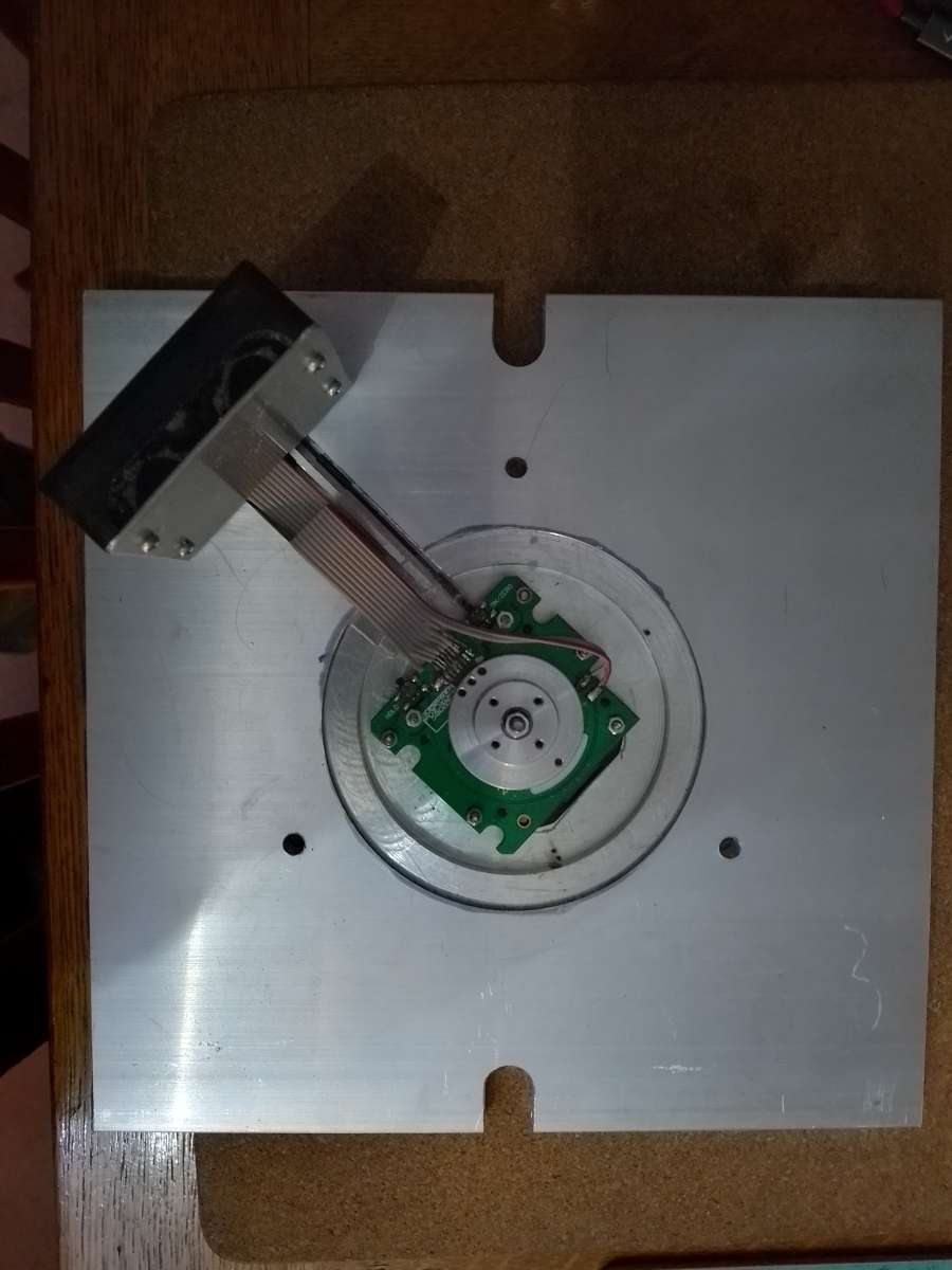

      The resulting assembly protrudes around 4mm from the underside of the rotary table, so I am making a simple rectangular aluminium sub-plate, recessed where required to clear the encoder PCB and to create a channel for the ribbon cable connecting to the display. The display will also be mounted on the sub-plate.
      The origianl ribbon cable has 8 conductors connecting the encoder PCB to the display. I replaced this with a 10 way ribbon cable, which also carries the connections from the batteries in the display box to the encoder PCB.
      The on/off switch is mounted on the encoder PCB. I attempted to create a remote switch, but without success. I suspect the switch on the PCB in not simply a normally open ‘push to make’ type.
      I have decided to go for a slightly Heath-Robinson solution, with a pushrod in a groove in the sub-plate to operate the switch.
      I’ll post more photos soon. I just need to machine the sub-plate.

            This is the arrangement of the encoder PCB, mounted the my plastic disc and connected to the half of the original box which houses the display and batteries. The whole lot is sat on the aluminium base plate.
            IMG_20250307_201645_HDR
            IMG_20250307_201656
            The underside of the rotary table with aluminium plug, tapped M3 for mounting the encoder rotor.
            IMG_20250307_201716

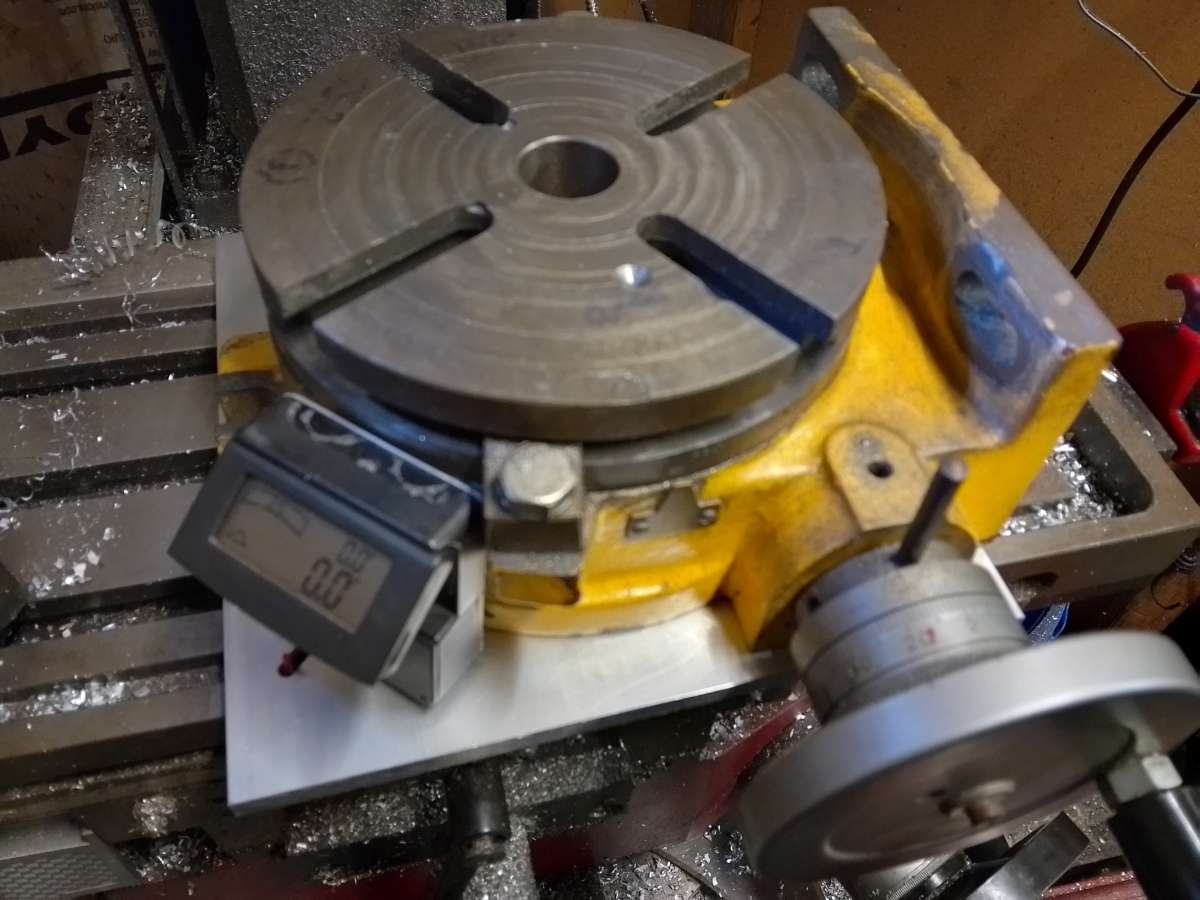

            And the finished article.
            IMG_20250307_205144_HDR
            Under the display can be seen the end of the pushrod which operates the on/off/zero button on the encoder PCB.

              I’ve just been running some tests.
              At first, I thought something was wrong with the encoder or its installation.
              For the first 100 degrees or so of rotation, the readout aligned perfectly to the handwheel dial.
              Over the next few turns of the handwheel, the readings drifted apart until they were 1.5 degrees different at the 180 degree mark.
              Continuing round back to the start position, the reading came back into alignment.
              I repeated the test, but this time used an additional means of measurement – a digital protractor – to see what was going wrong.
              As it turns out, my readout is correct, but there is a lot of wear in one area of the worm wheel in the rotary table.
              This discovery may explain some issues I have had in the past.
              Although the readout is accurate to only 0.1 degrees, it is a lot better than the dial reading through the heavily worn gear.
